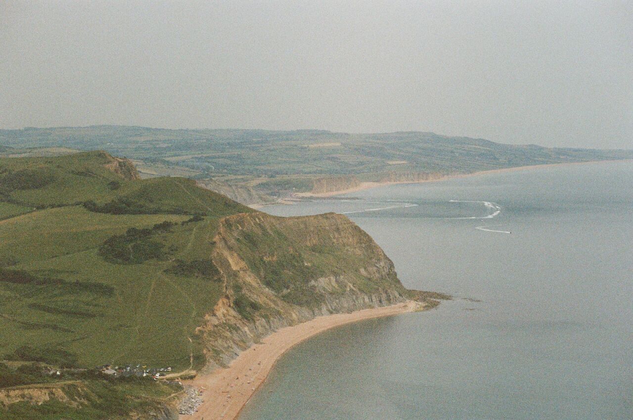

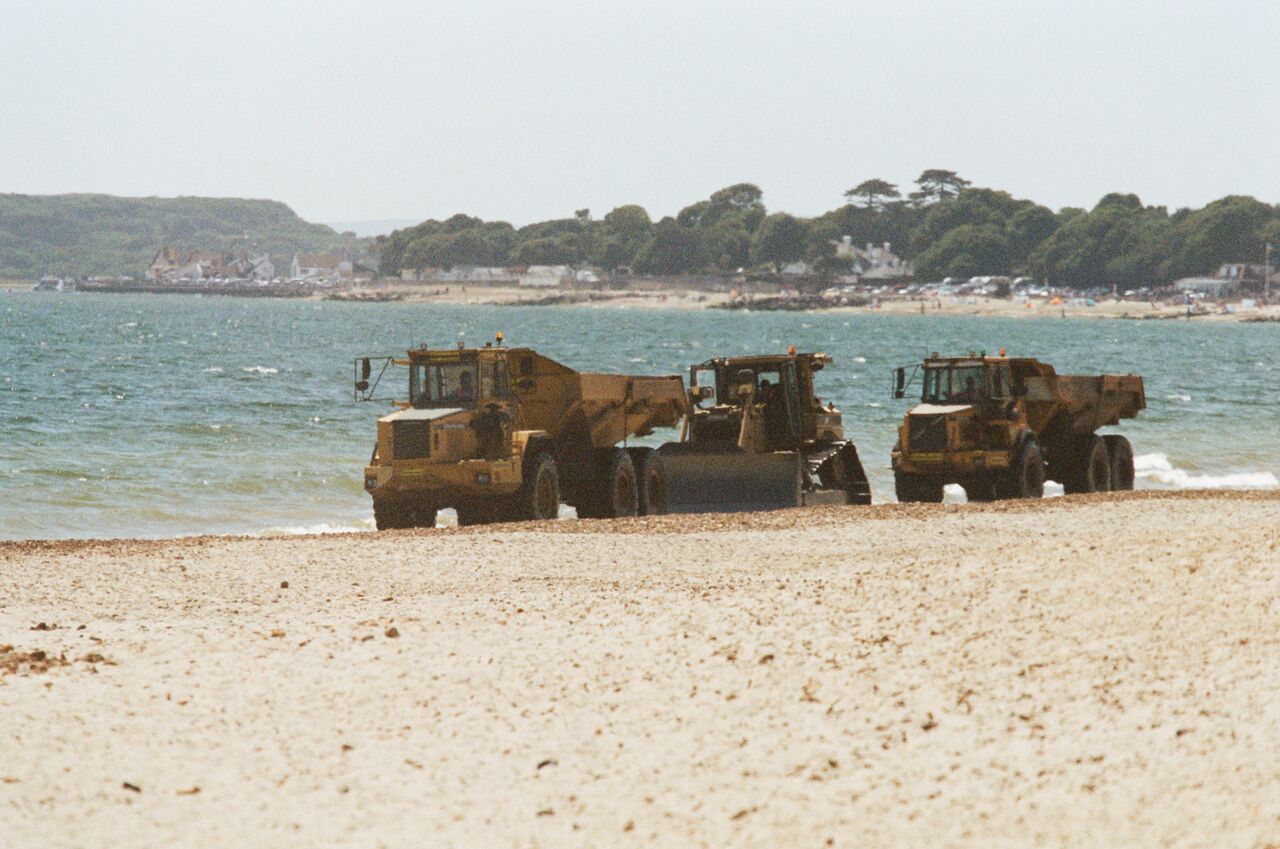

here are a couple of compressed scans (copied from my dropbox). I could upload larger versions, but not sure how lagre is allowed or possible here
The middle one looks fine for the conditions in which it was exposed. The two outside look a little de-saturated by comparison but was there a haze or slight sea-mist that day? Are these three scans all from the same source of scanner and is the middle one from the film you labelled OK and the outer two from the 3 stops underexposed?

#1 and 3 were taken on different days (2 and 3 the same day actually..), but yeah, it was quite humid and with the use of a 70-200 tele (#3 with 1.4 extender), it gets hazy quick

So these are all from the OK film in which case the difference in these has to be down to light conditions/sea haze or maybe that combined with a 1.4 extender(tele-converter). The best of these such as a Nikon converter on a good Nikon lens might make very little difference to the picture quality but in my experience of using an "also ran" converter with a 100-300 Tamron tele-photo for a Pentax, the quality of the negative does suffer.

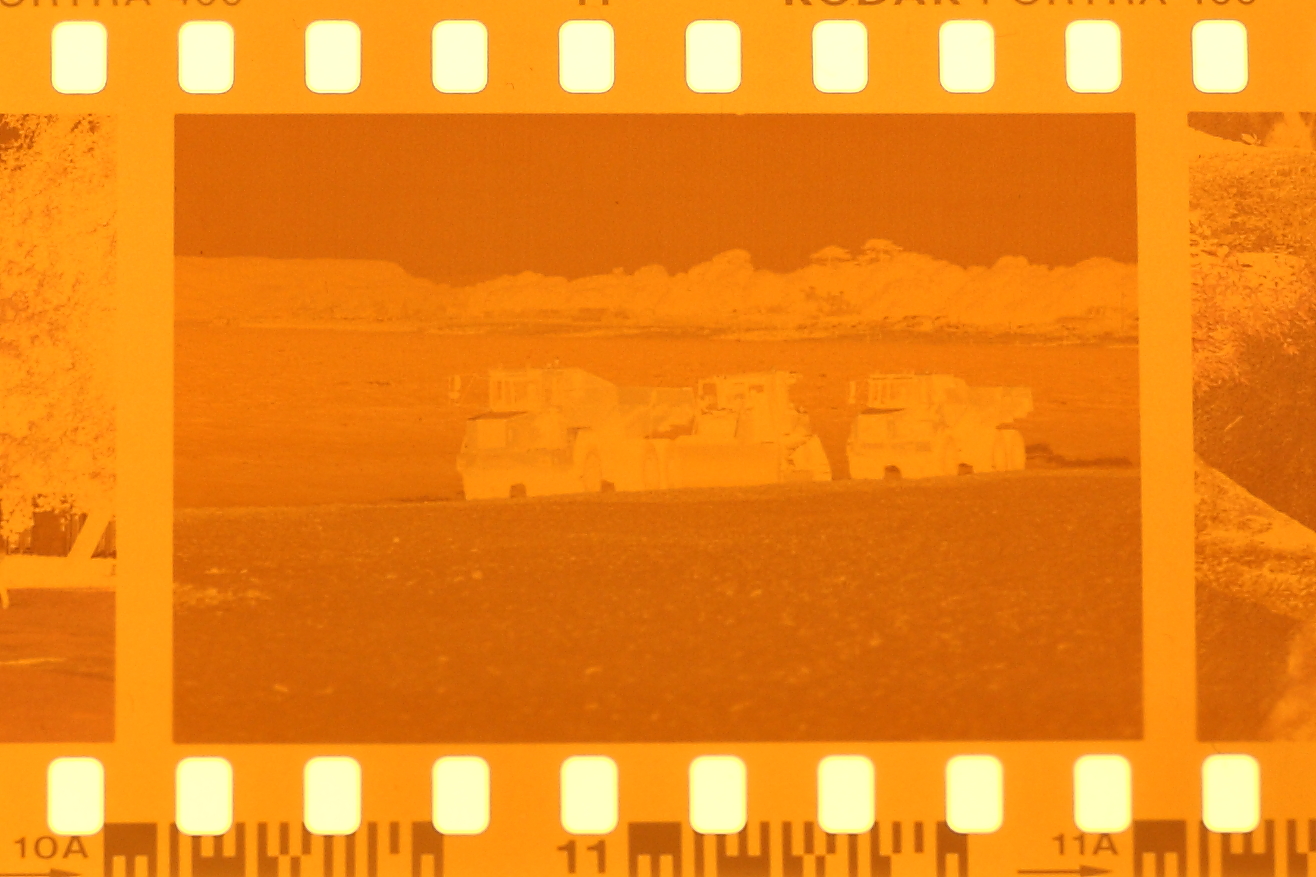

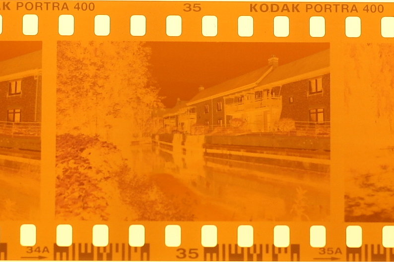

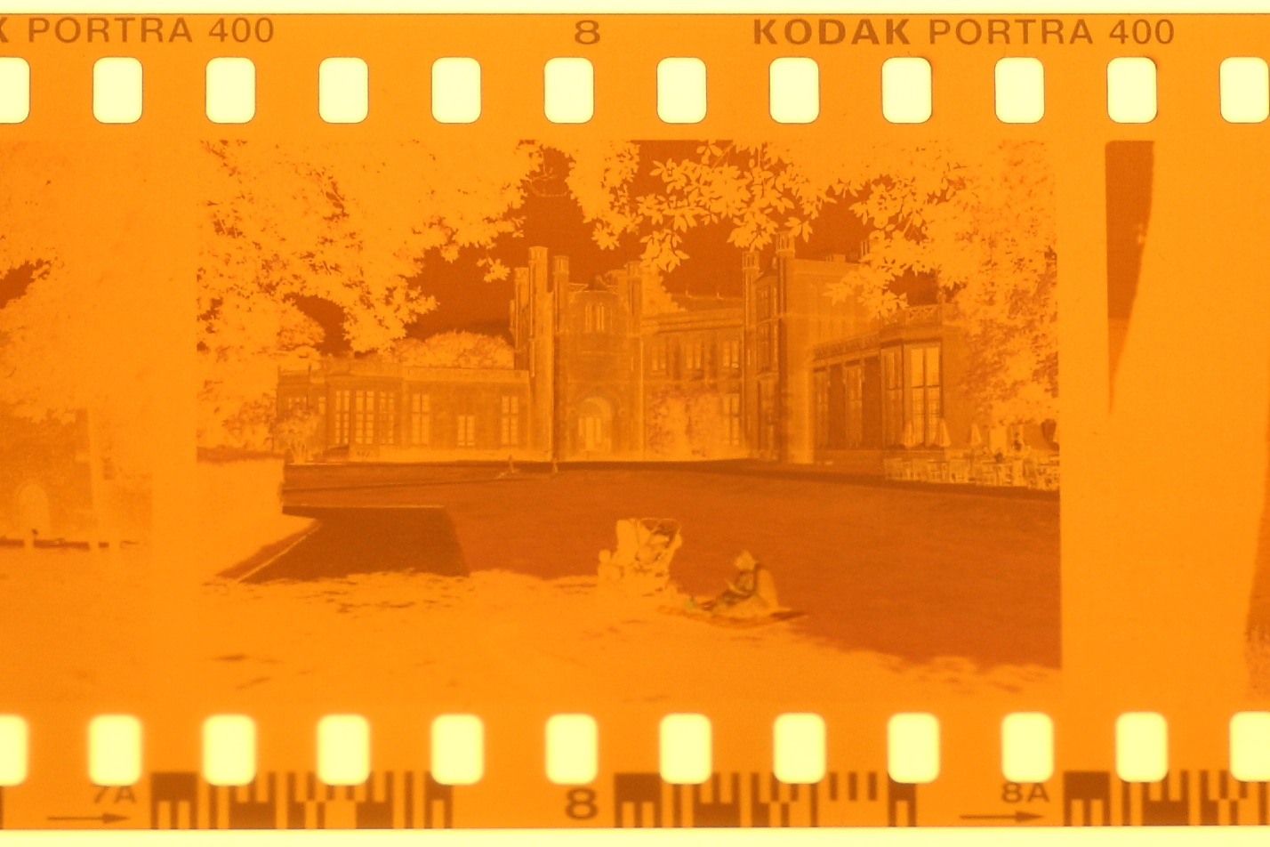

Here are the 3 negs (in the same order)
+ 1 extra
I hope they are clear enough, it seems DPP compressed them to under 1 Mb...

I'm sorry for making this clear, but these are 4 negs from the "badly underexposed" roll, received it yesterday.
If we can rule out the extender on what looks like the properly exposed negative and if the light conditions for each were much the same i.e. a relatively clear sunny day, then the beach and cliffs do look the most underexposed, the beach with trucks is still underexposed but slightly less so. The building and foreground picnicers scene looks to be properly exposed and the canal and houses only very slightly less so I agree with your assessment

OK then it certainly looks as if something went wrong with the exposure(underexposed) on all negs except the picnicers( related to amount of sky?) so my previous post stands. I am unsure if it is as much as canuhead is suggesting as that would mean reducing film speed to 100 but only a kind of trial and error approach as I suggested will tell you.
