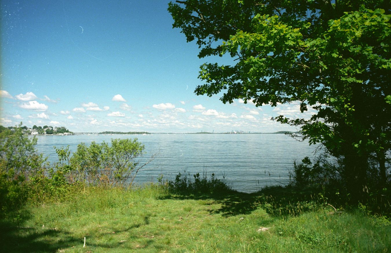

My first roll turned out decent with some very slight color shifts and uneven development, but overall passable and better than expected for my first attempt.

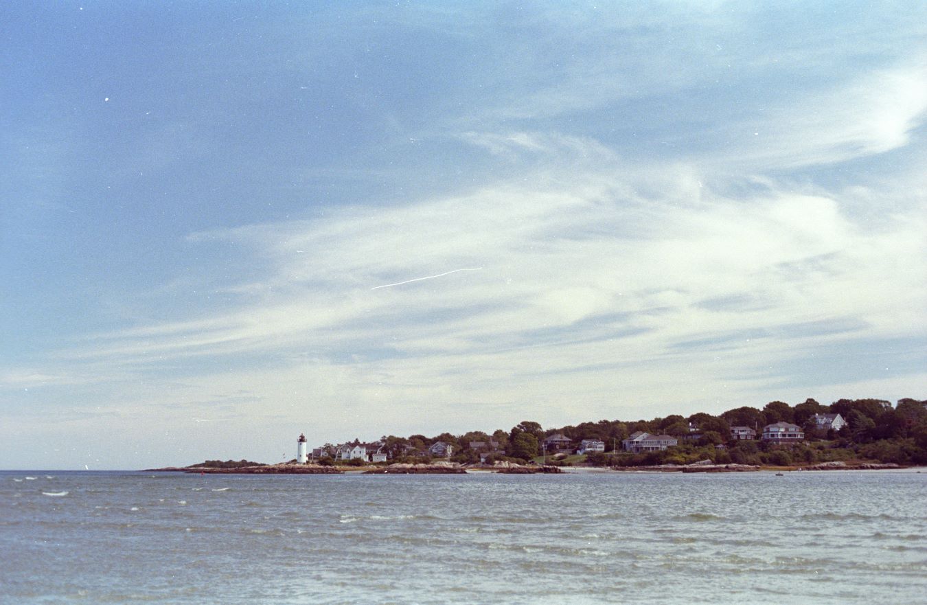

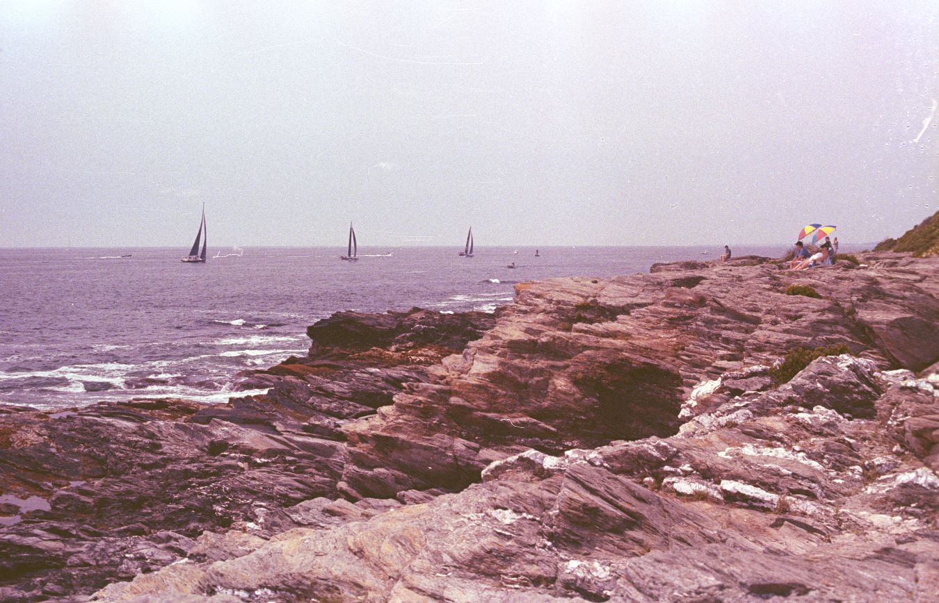

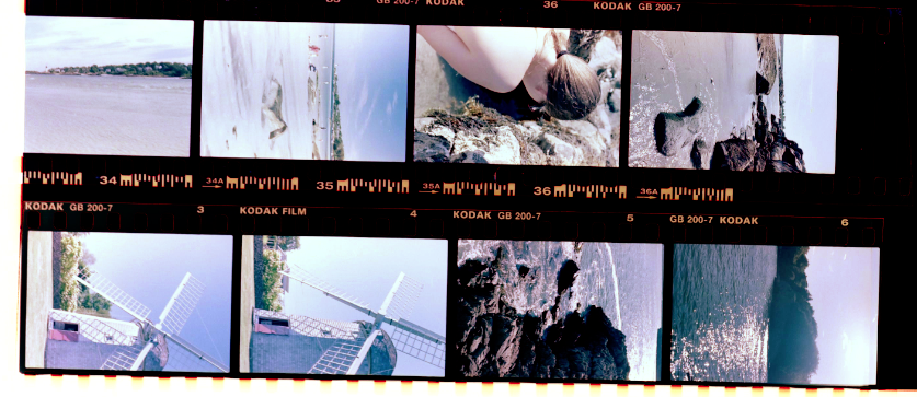

My second roll came out with heavy magenta casts, even though I followed the same procedure as the first roll and stored the chemicals in accordion containers will all of the air removed.

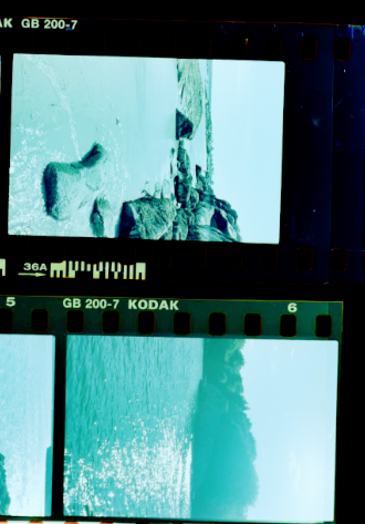

Below is an example of the difference in the negative base color in a roll developed by a lab and my roll developed at home, as well as a scan showing the magenta cast. What would cause the drastic difference in base color and magenta color cast? I am scanning with a Nikon Coolscan 5000 and can get accurate colors when scanning lab developed negatives.
I originally thought that it was due to poor temperature control and temperature fluctuations during agitation and pouring the solutions in and out of the Paterson tank. Before I developed my next roll of film I ran through the developing process using water in place of active chemicals and logged temperature measurements at different points. I found that from between removing the bottle from the water bath and pouring the solutions into the tank, I was losing ~0.5°C. Then after agitating via inversion once every 15 seconds, and the completion of the 3:15 dev time, I was losing almost 1°C. To remedy this, I increased the temperature of the water bath to 40°C and only started developing once the chemicals had reached 39°C so that dev would start and finish at 38°C ± 0.5°C.
This also did not help so I went on to mixing up a new batch of chemicals. Surprise, surprise, I still have heavy color casts and different colored film base when comparing to the same film stock that had been developed at a local lab.

The photo of the two negative strips is too small to make out much, sorry. If you could post a larger version, that would help. The only thing I can say is that the top strip looks all wrong; it looks like over-developed ECN2 film. The bottom strip looks more like normally processed C41 film. What kind of film are we looking at here? And how was the top strip labeled 'Lab' actually processed?
The inverted color image (that does look very magenta indeed) shows odd density variations that could have several explanations. They might be simply be fogging to light or the result of uneven agitation and/or fill/drain rate problems (taking too long to fill/drain).
I think the ADOX instructions do not instruct you to use a stop bath, but I would recommend using one in a manual process anyway. You can make a perfectly fine stop bath for this purpose by diluting unscented cleaning vinegar by about 1+10 with tap water (use one shot; discard after use).
For more sensible comments, please post a larger picture of some of the affected negative strips.

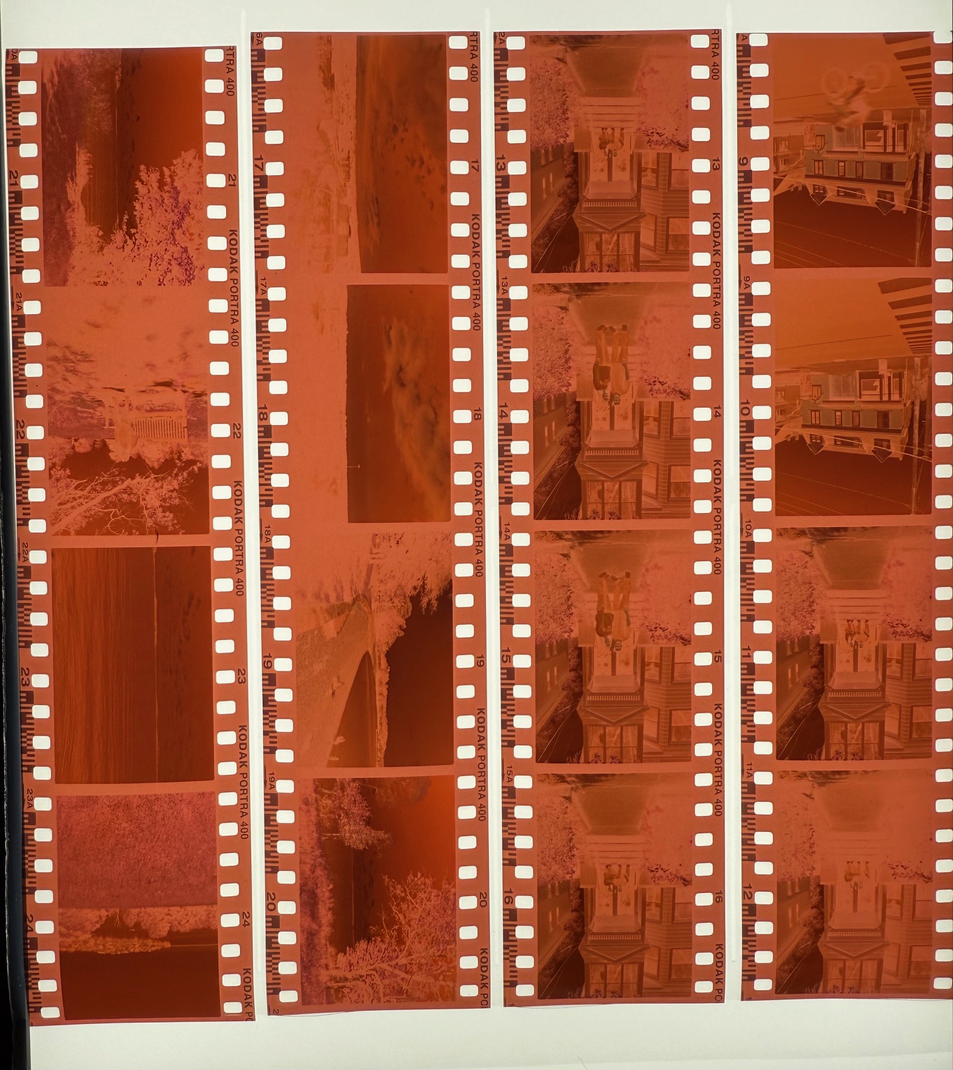

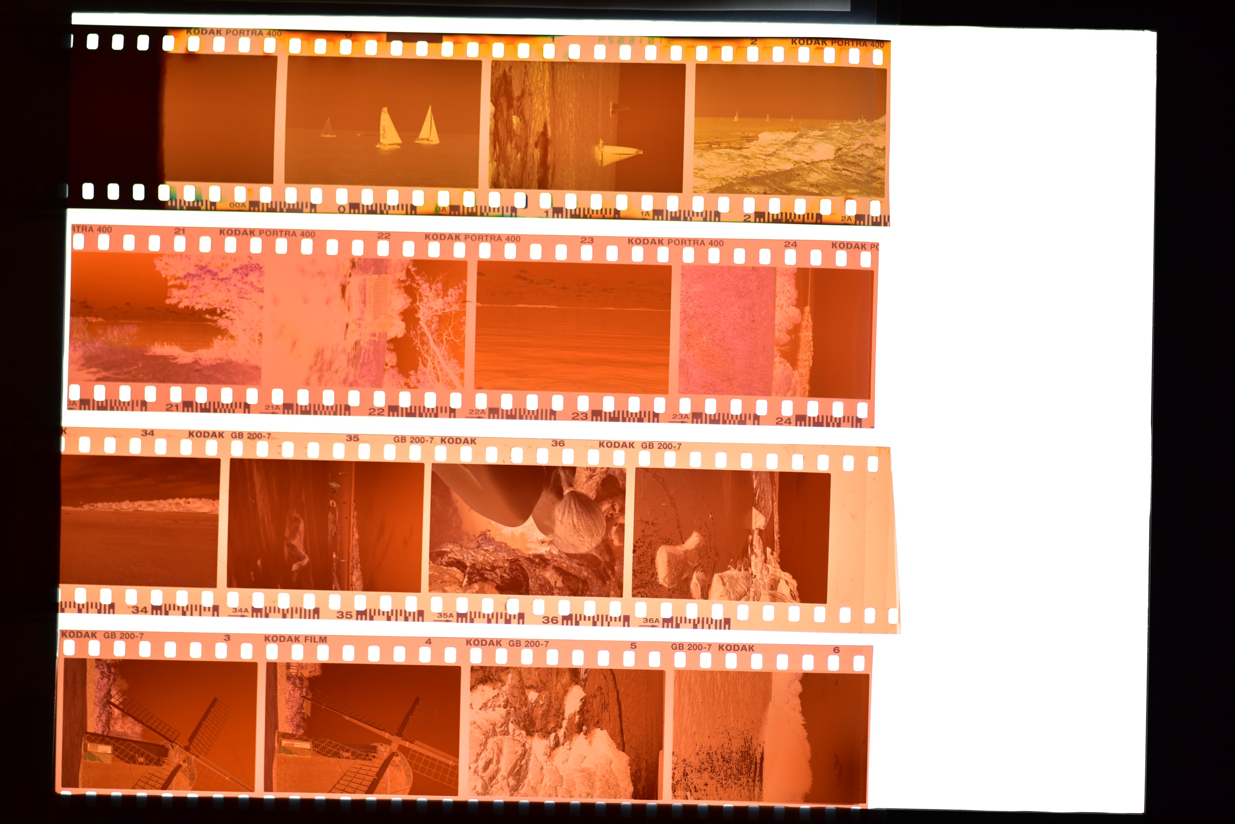

Here are better photos of the two batches of negatives I’m comparing. They’re both Portra 400 which were exposed and developed normaly. Neither rolls were out of expiration and they sat for maybe 2-4 weeks between being exposed and being processed.
Lab developed negatives:
Home developed negatives:
Side by side:
semi-stand development
I'd be hesitant to draw parallels between agitation schemes with 10+ minutes between cycles and a scheme that approximates continuous agitation. It's correct that you can usually dramatically improve the problems in a fully stand development scheme by introducing one or two agitation cycles somewhere in-between the process. But this issue is different from the question how vigorous agitation should be in something like a C41 process.
The color of the base and overall color of the negatives is far more red than how Portra is supposed to look. Either the white balance of the digital photo of the negatives is extremely far off course, or there's a serious problem with how that film was processed. I suspect it's the latter. Is this a small 'boutique' lab or a large commercial outfit? Do you know how they process their film?

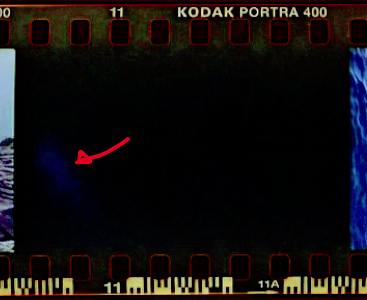

These look more normal, but there is an odd shift towards blue. I do see some signs of light leak problems, potentially in the camera:
I'm not sure if this explains the overall blue/yellow shift entirely.
The odd blob in the second snippet above seems to be of the same general shape and in the same spot as the one you showed earlier:
My first guess is that this is a camera-related light leak. What kind of camera did you use for this film?
I’m shooting with an Olympus OM-2n which I’ve never had any signs of light leaks from since replacing the seals about a year ago.

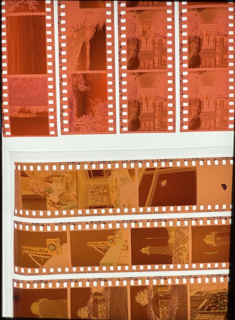

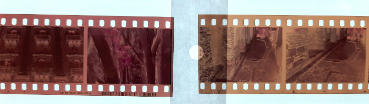

Yes the Porta 400 has a deeper base color than Gold 200 developed by the same lab. Both scan perfectly so I have a hard time believing that they were processed incorrectly, it must be something with the iPhone photo processing. I’ll scan a couple examples as positives and post later on.
Perhaps this illustrates my concern. Both strips are the exact same film. Left was overdeveloped due to a gross mixing error in the chemistry. Right is normally processed.
Healthy Portra looks closer to the sample on the right.
To be sure: the film on the left scans just fine.

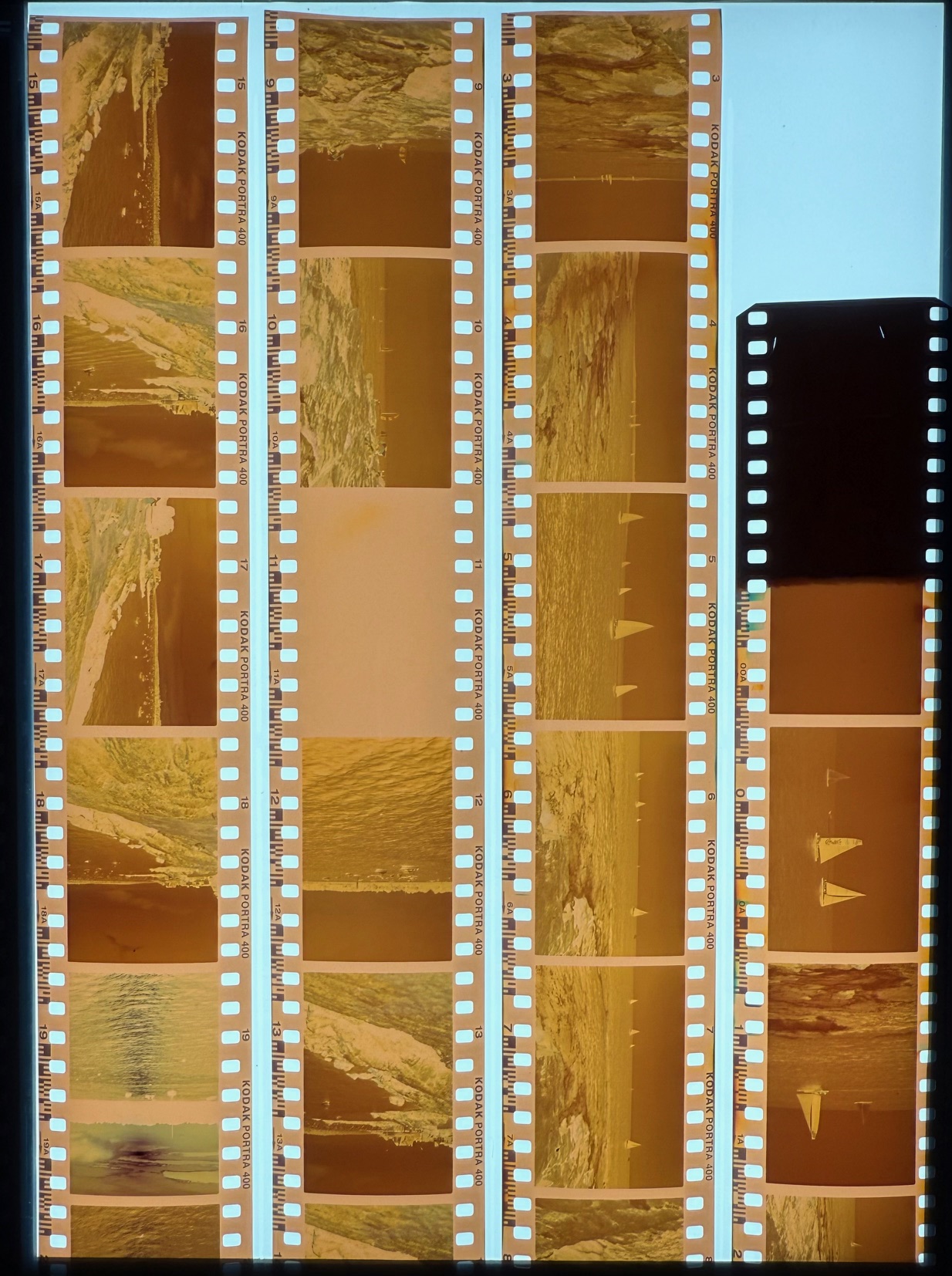

Maybe this will help more. Here is a photo with white balance set to 5000K.
Top to bottom:
1) Kodak Portra 400 - Self Dev
2) Kodak Portra 400 - Lab Dev
3) Kodak Gold 200 - Self Dev
4) Kodak Gold 200 - Lab Dev
Everything that I have developed has a color cast, with the roll of Portra being the worst. The gold I developed came out pretty good, but still leans magenta
Here are the inverted negatives with no edits:
Portra 400 - self dev
Portra 400 - Lab dev
Gold 200 - Self dev
Gold 200 - lab dev
OK, it looks a little more normal now; thanks.
The Gold doesn't look too weird, but I agree that the dmin is very different. Inverted and crudely color balanced, the self- and lab-developed samples aren't worlds apart though:
This suggests that whatever is happening on the base is likely some relatively minor fogging on either roll - and I'm not convinced that your own roll is the one that's problematic.
I agree that the Portra roll is basically FUBAR. There's almost no color information in it. IDK what went wrong there; my first thought would be a major problem with e.g. chemical contamination, fogging to light etc. Was this the same chemistry (as in, the exact same batch) that you used for the Gold? Did you first develop the Gold in that batch of chemistry and then the Portra, or the other way around? If it was first the Gold and then the Portra, my guess would be that there's a contamination problem in your process.

Referring to the Gold 200 rolls, the interesting bit is that his home-processed roll has a lower d-min than the lab-processed film:
Thinking about this a little more: the difference seems to be that the lab-processed film as a more magenta base. This makes perfect sense if you keep in mind that the lab apparently uses a minilab machine, which means that the wash cycle will be pretty minimal. @avose55 mentions doing a 6 minute wash at 30-40C, which is pretty thorough (assuming it involves at least one or two changes of water). This will wash out more of the magenta sensitizing dyes; I think we recognize how stubborn these dyes can be (try to get perfectly clean wash water from a Kodak C41 film - there's always a little magenta!) Perhaps this is the simple explanation behind the difference in base color between the Gold films.
With the Portra film something odd is going on. That one has significant yellow dye stain all over the film apparently, and the color balance is out of whack even if you correct for this yellow/blue bias.
