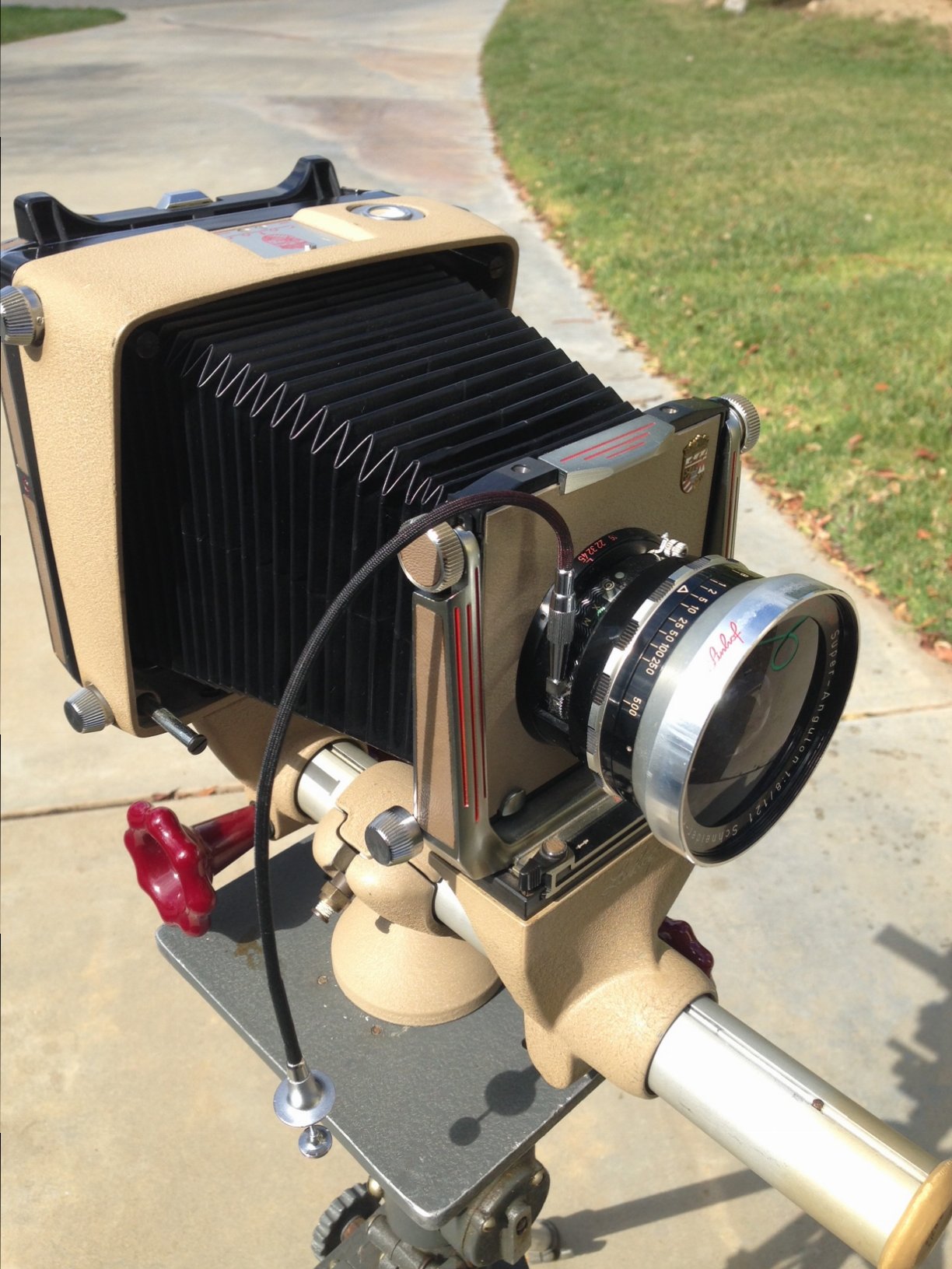

No worries :smile: how often did you use the 6x9 back? Not so much seeing you sold it?
You know Dan, I never used it...probably silly of me, but I only used my Fuji 6x9 for that format. I have had a Fuji
for many years and love it., and honestly have never had a reason to try any other camera in that format.
I sold the Linhof Technica (Schneider) 100/2.8 and two 6x9 backs to a collector to finance some of a Leica purchase.
I will say this though...the Linhof Technica Color is a wonderful 4x5 camera, and I use it a lot...they pop up here
in the U.S on ebay from time to time...they have some limitations perhaps, but it's such a classy little camera
and serves me well. Mine is in absolutely beautiful condition.
