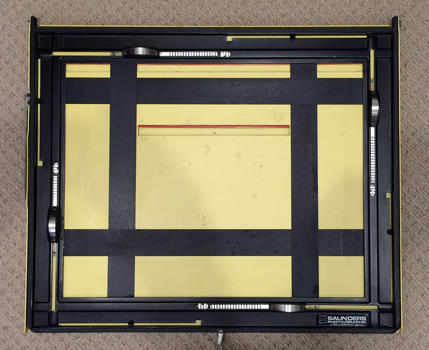

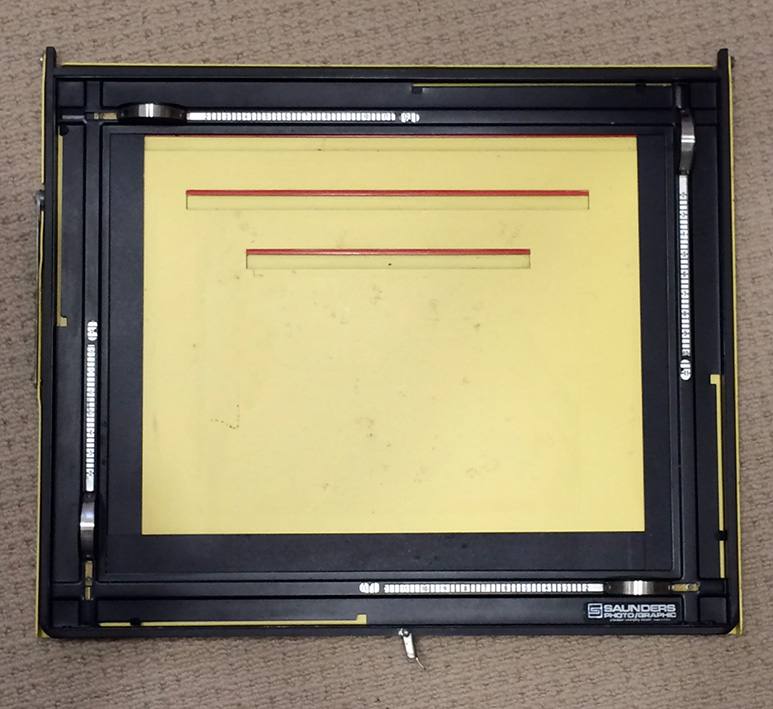

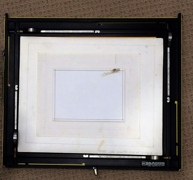

Another plug for the Saunders 11x14. Very well made, sturdy and reliable. It has 3 paper holding slits for 11x14, 8x10 and 5x7 and the 4 movable blades makes for great versatility. I use the backs of test prints to mark out standard borders and also use those for composing and grain focusing. 6x6 format enlarged on 11x14 paper makes for very attractive size prints in my view. You can also trim one side of the paper to provide a supply of test strips.
