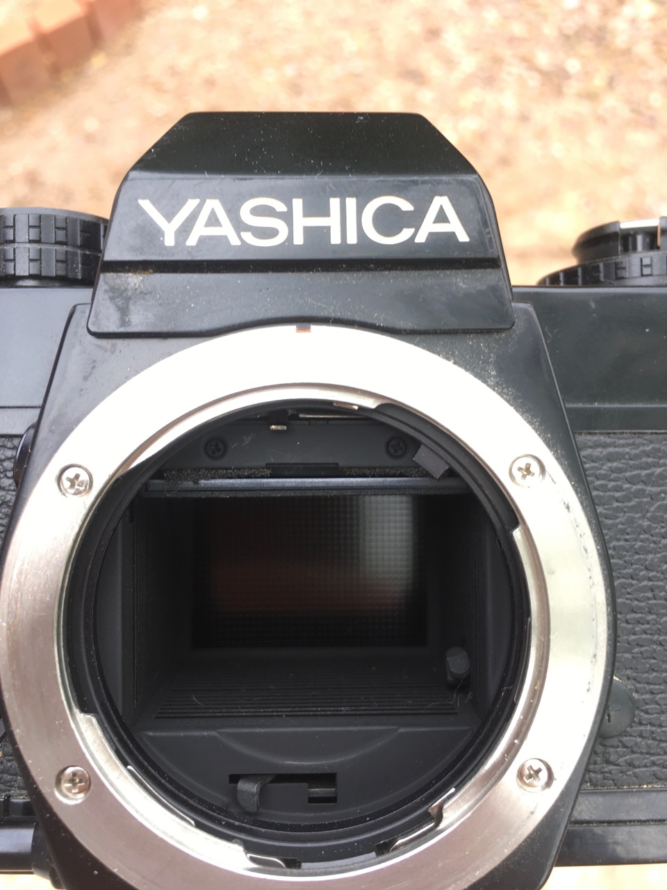

This is what a Yashica FR I looks like fired on bulb, so you can see where the lever ought to be.
The photos are helpful, but I get a permissions error if I try to click on them to enlarge. Either they are too small or you have some Photrio access permission set that doesn't allow people to see your attachments. The files all have names like "wechat-image-something", try uploading the photos taken with the camera app, not sent through Wechat.
But anyway, from the last photo on "B," I can tell that the stop-down lever is not moving far enough to the left. It should move all the way left, to a point behind the bayonet flange. I don't know if the lever is bent, or if there's something wrong with the DOF preview mechanism that is fouling it, and from the small photo one can't say more. (BTW, it doesn't look like the upper aperture sensing lever for the meter is out of position. It should move from that position if you push it to the right, and then spring back.)
