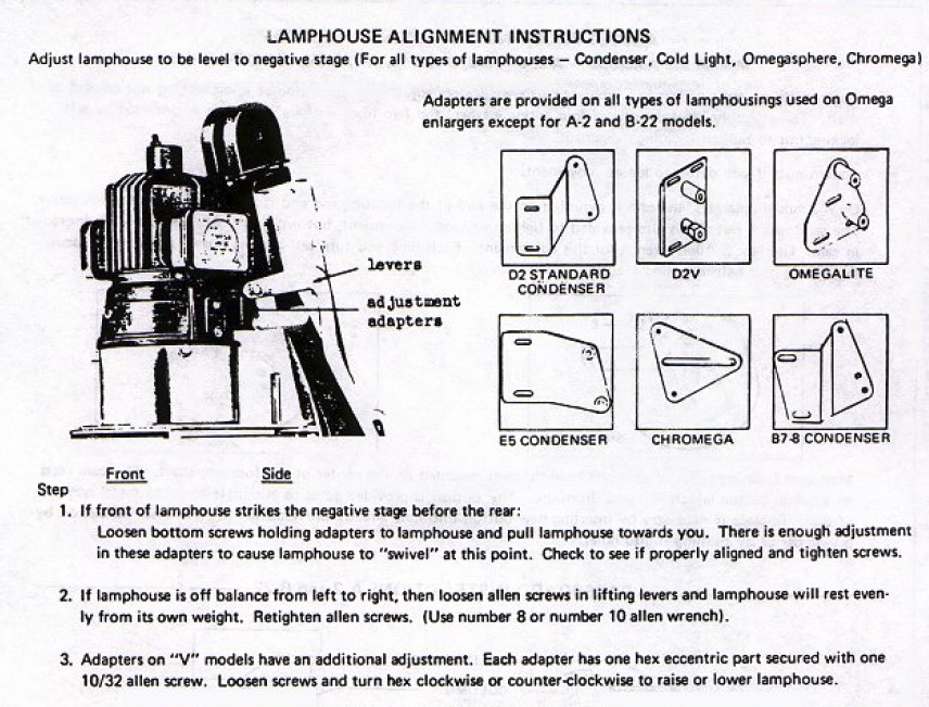

How does the lamp house/condensor head fit on the negative carrier stage? Improper alignment might cause uneven illumination (although I doubt it). The reflector in the housing could also be an issue. You might have to improvise some sort of shim to position the bulb/socket in the head.

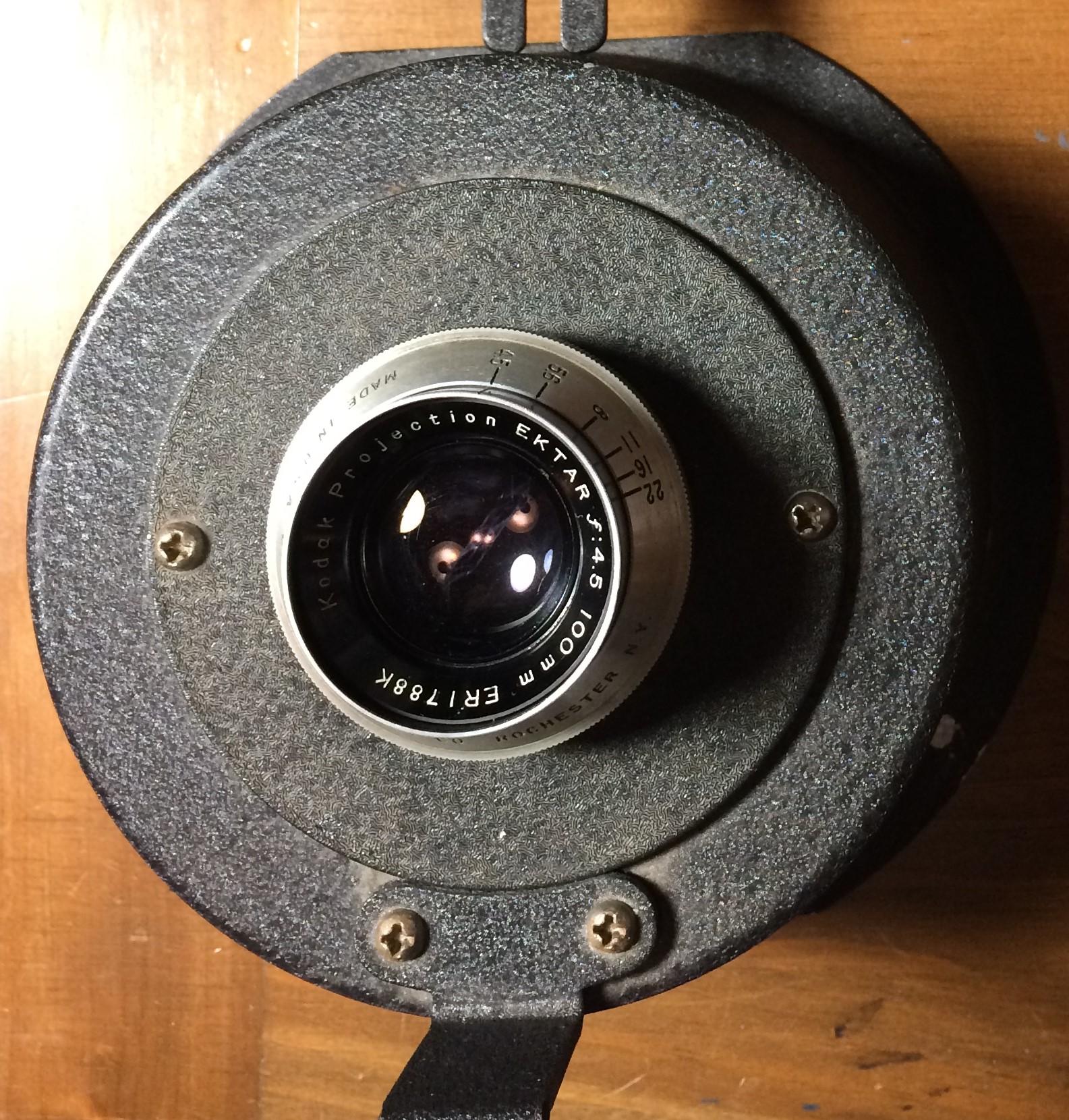

do you have the right cone for the lens ? sometimes the wrong cone does weird things like vignette ... I don't use the lens cones but I do use an auxiliary focusing bellows which was originally used to make jewel prints/ reduction prints... if you find one grab it ! you will never need to buy a rail or cone again...
when you are talking about the condensers. are you talking about the auxiliary condensers to put in the light-stage? my enlarger has a pictograph when you flip up the door. make sure your aux condenser is in the right place or it will do weird stuff too. ... and 100mm lens is a bit long for 35mm. ... usually people use a 90 for 120 and 50 for 35mm ( think normal taking lenses ). ...
All good points. most of my enlargements are 4x6 or 5x7 and I find the 100mm lens is positioned at a comfortable spot and the choice really is a convenience factor. I use the 50mm for 8x10s as the 100mm would require too high a setting on the enlarger. Conversely, the 50mm sits too low to comfortably do 4x6s. I probably could switch to the 75mm lens and do away with any swapping of lenses.
You are correct, the photo above shows the 100mm lens on the 2-3/4-inch cone with isn't right but that's how it looked when I purchased it. My 50mm, 75mm and 100mm Ektars all now sit on flat lens boards for the D2. I have several other longer enlarging lenses that I currently do not use that are normally mounted on the cones. I also have the auxiliary bellows but I've never used it - I did snag it when I could for the exact reason you stated.
My D2 does not have the variable condenser lamp housing you refer to and has the earlier 'colorhead' version which has a small door to insert 6x6 colored filters (see photo). Unlike the more versatile variable condenser head that came later and to which you refer, my version uses separate condensers which externally looked the same with varying diameters of glass, optimized for the length of lens you were using. While I do have one of each of these condensers, I never change our the 4.5-inch.
Optically speaking, I think my mismatch of lens-to-negative and condenser-to-lens affects only the relative intensity of light hitting the negative. However, that could be faulty thinking on my part.

Thanks, Pieter12 for the graphic - that's more in line with what I might need. From my previous post, you can see my lamp housing doesn't use brackets as the attachment points are cast in. However, the adjustment description looks like it's still valid so I'll give it a try tonight.

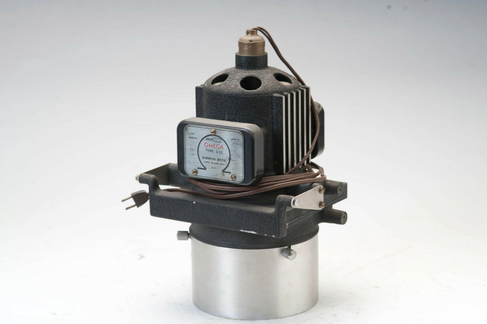

fyi - harry taylor once told me that they are the same enlarger, (i have a d II), one a military version. i needed the counter balance springs, here's his explanation...
"The only D-Series enlarger that used a CBS with "two bolt holes" was the model originally named Omega D-II. This was the first of the "modern" Omega enlargers and was in production from 1937 to 1955. During the last few years it was sold as "Omega D-2".
Then in 1955 Omega brought out a redesigned model which was also called "Omega D-2" This model was made until 1980.
The new model was an improved D-II (D-2). The parts that made the image, that is the lamphouse, condenser system, negative stage, bellows and focusing mechanism and lens stage were unchanged. But the column, was redesigned into a heavier one-piece column with gear teeth and a crank and gear system to move it up and down the column. They also used a different CBS, with one bolt hole that was mounted on the top of the column. That's the CBS I sent you."

Thanks for the information. There are photos on http://www.khbphotografix.com that show both the D-II and D-2 with their respective CBS locations. Further, like you said, the CBS is not interchangeable between the D-II and D-2. Fortunately, mine was complete and I didn't have to find any parts for it to put it back in service with the exception of lenses.

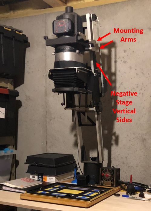

After reviewing the advice here, I looked at the enlarger lamp head mounting and determined it was just slightly off (just a few hundredths of an inch) causing the lamp head/condenser to sit slightly left of centerline. My lamp head version (the "colorhead" version) doesn't use any of the brackets displayed in Pieter12's post above and the fasteners are threaded directly into the casting. As jvo pointed out above, the D-II and D-2 versions of the enlarger had essentially interchangeable lamp heads and several versions of those are out there. As I suspect with my enlarger, I have an early D-II frame with a later D-2 "colorhead" lamp housing. The mere fact that heads may have been changed may have led to misalignment. The only adjustments I could make were to: 1) the arms that raise/lower/hold the lamp head on the enlarger and 2) the vertical sides of the negative stage. See photo.
After minor adjustments to the arms and some tests, I'm getting no noticeable impact to my prints. I suspect the brackets, arms, and/or vertical sides are where you'll have to make adjustments.
I've seen a number of these enlargers over the years in various states of repair. Due to their size and awkward footprint, it's possible many have been damaged or misaligned over the years due to falling over or general disregard for proper storage, use and handling. As an example, my first D-II (not the one I'm currently using) was buried in falling books during a California earthquake. I'm guessing it might have needed adjustment after that but I wasn't using it at the time and never made any adjustments before I gave it away.
In short, here's my advice:
1) Check the alignment of the lamp head brackets (if your enlarger has them) and the arms that hold the lamp housing on the negative carrier. There appears to be lots of adjustment potential here so that should do it.
2) If that doesn't do it alone, I would also check to ensure the vertical bellows/negative stage framework (the two vertical sides) are parallel to each other as well as parallel to the rails.
To affect an adjustment, you may be able to GENTLY bend the parts back to the correct alignment. If it's just a left-right adjustment, you may be able to shim the mounting with washers.
Hope this helps.
One last thing, I think it's possible to incorrectly install the mounting arms on their shafts. Basically if they are on backwards, the whole lamp head will be shifted left or right by about 3/4 of an inch. Might be worth a check there too.
