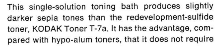

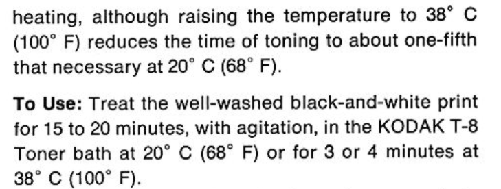

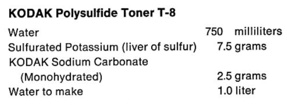

Was this the formula your chemist friend mixed up?
In Processing Chemicals and Formulas, Kodak claims it's very similar to Brown Toner.

Brown toner, just stinky old direct sulfide toner?. I had liver of sulfur, I think I tossed as it's so hard to isolate.
That’s the stuff! Confusion comes in whether it’s working solution or concentrate…
My bet is that's working solution and may need to be used after mixing. Perhaps it lasts longer than that. But there is no indication in the text that you should dilute it.
