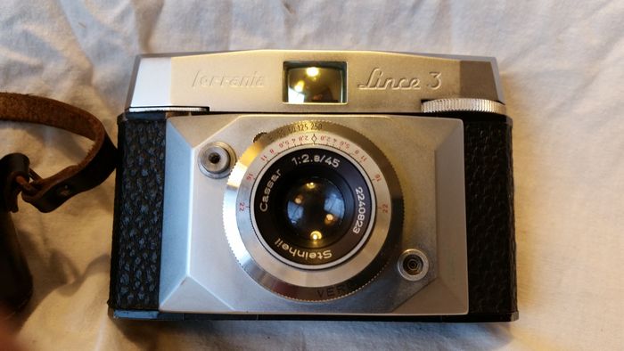

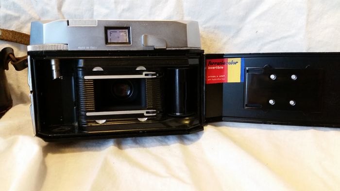

I saw a local (online) auction for a Ferrania camera, model Lynce 3 (from 1962?) with Cassar 2.8/45 lens.
attachment.php
attachment.php
attachment.php
Would be fun to load it with real Ferrania film again - if my (low) maximum bid survives.
http://veiling.catawiki.nl/kavels/1540555-ferrania-lince-3

I guess you made a typing error:
Not Lynce, but Lince. (Or Lynx in English.)
The approaches on the etymology of the roman and germanic versions of this name are interesting too...
I did, didn't I? I can't corrected it but I stand corrected :wink:
Thanks AgX
