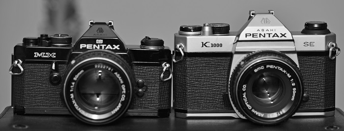

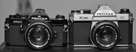

I own both a K1000 and an MX. I prefer the MX because it shows shutter speed and aperture in the viewfinder, and has a brighter finder. The MX is compact, but can seem too small to someone with large hands. I sometimes put a winder on the MX just to make it feel bigger in my hands. I rarely use the winder to advance the film, because it can be a little noisy. The K1000 is actually my wife's camera, but she doesn't use it any more. Once she married me, I became the official family photographer. The K1000 does have sentimental value though, because my wife took a photography class to learn how to use it. I was the instructor, and that is how we met. I have sold many film cameras over the years, but the K1000 will stay because of it's meaning and because I will teach my son photography with the same camera. You can't go wrong with any of the three you listed, or with an MX. Good luck.
Here is a photo of the K1000 next to the MX to give an idea of the size comparison.
