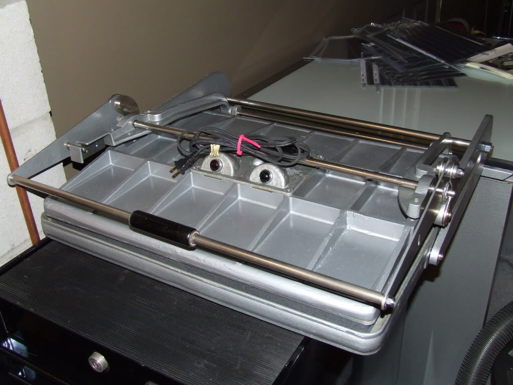

I had one of those heated metal plate and canvas driers back in the 70s. Very frustrating to use. Most attempts had blotches of incomplete ferrotyping. Worst part was the successes. Had it been only failures I would have binned it. Getting a blotch free ferrotyped print from it was glorious and had me trying again and using a lot more paper per final print.
If memory hasn’t failed me, when I used the ferrotype dryer for making glossies, I first coated the print lightly with a solution I made, in which the key ingredient was beeswax. No blotches resulted. Of course, all of this is passé with arrival of computer reproduction.
I would not consider a ferrotype dryer for flattening prints, if only because the canvas cover usually become contaminated. A ferrotype print was not intended for archival prints.

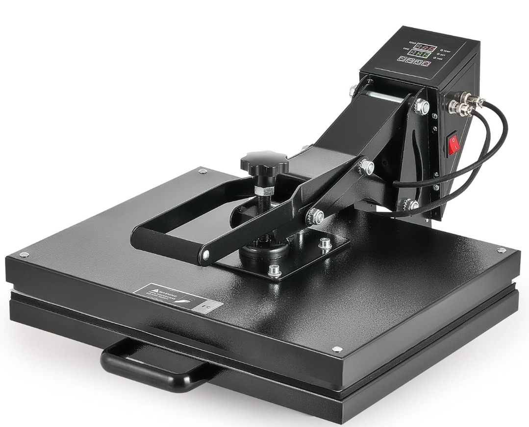

I'm just wondering, is there anything really wrong with such a device? For a similar price (200€) I can't find anything better. It's 40x50cm. I've been watching ads for an older hot press for a while now, but nothing has appeared in the area.
I just bought a similar one because I make t-shirt transfers a few times a year and thought it would make it go better - it does.
I used it to dry mount a dozen 8x10 prints in about 15 minutes. I'm pretty sure it'd flatten prints pretty well, too. It dry mounts way better than a clothes iron does.

I've seen the well-known Vevor press before, but it was smaller and since I work up to 40x50cm, I was interested in this one.
I mainly want it for flatten prints that I dry on a fiberglass screen, but the occasional dry mount is also possible.
I use a similar one regularly and I am very happy with it. Unfortunately when I bought it the 30x40 version was too expensive, but for 200€ I would take it immediately

Just before buying the t-shirt press, I saw one that looked good for $100 that I would've bought, but I would've needed to drive for almost 4 hours to get there - in the middle of winter (no fun). 8 hours of driving adds about $140 to the price. I decided to opt for something that would be delivered and could be returned if it didn't work.
That said, I don't expect anything near the service life of an old Seal dry-mount press from this no-name thing. So, while I say there are unknown problems, they're of a limited number.
Thanks Austin. Roughly that's what I've been doing. But in my case, I let the prints lay flat after drying under layers of books/bricks in between 2 mat boards for a couple of days. I would then iron the mat board with the print still in between. But, I'm just toying the idea of acquiring a press machine to make the process easier.
adry-mount press is undoubtably the best opion!
Why is it the best option? The t-shirt press has a temperature control and clamps solidly. It essentially is a dry mount press.

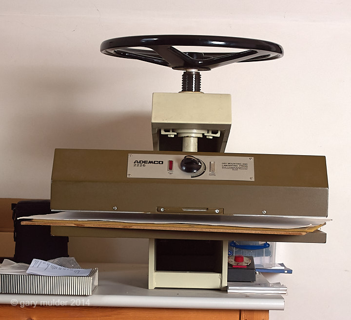

Looking at the examples you referred to shows me that with one exception the platen size is quite small (around 12 inches). I think you would need the largest version which has a platen of around 16x23 inches. I was very lucky to get a 20x26 Ademco press for under $100 but a friend and I nearly did ourselves an injury carrying up the stairs to my spare bedroom
Put my back out moving my Ademco as well.... must be a rite
of passage....
