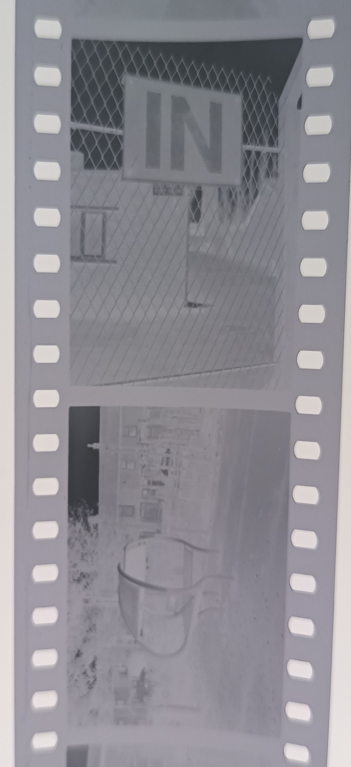

I forgot to upload an image of the negatives. This is how they came out
I see underexposure AND developer failure.
Leave Hc-110 in the dustbin, it was never a developer tailored for 35mm anyway. To me there are far better developers for the smaller format, depending of what you want to achieve.
