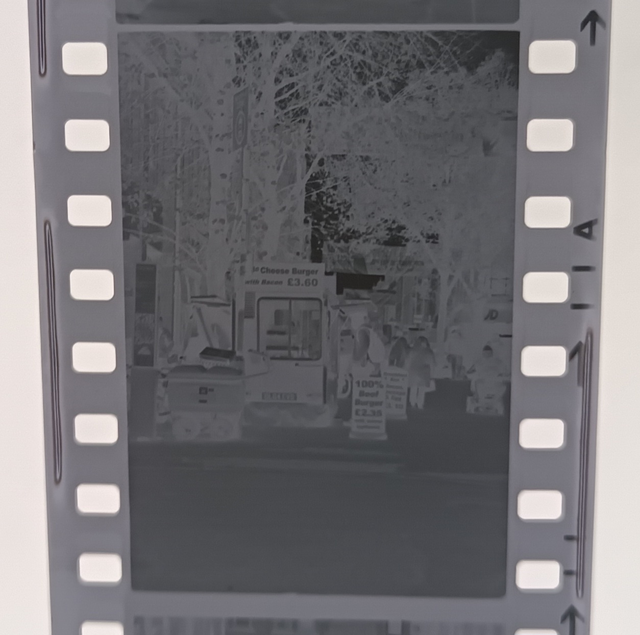

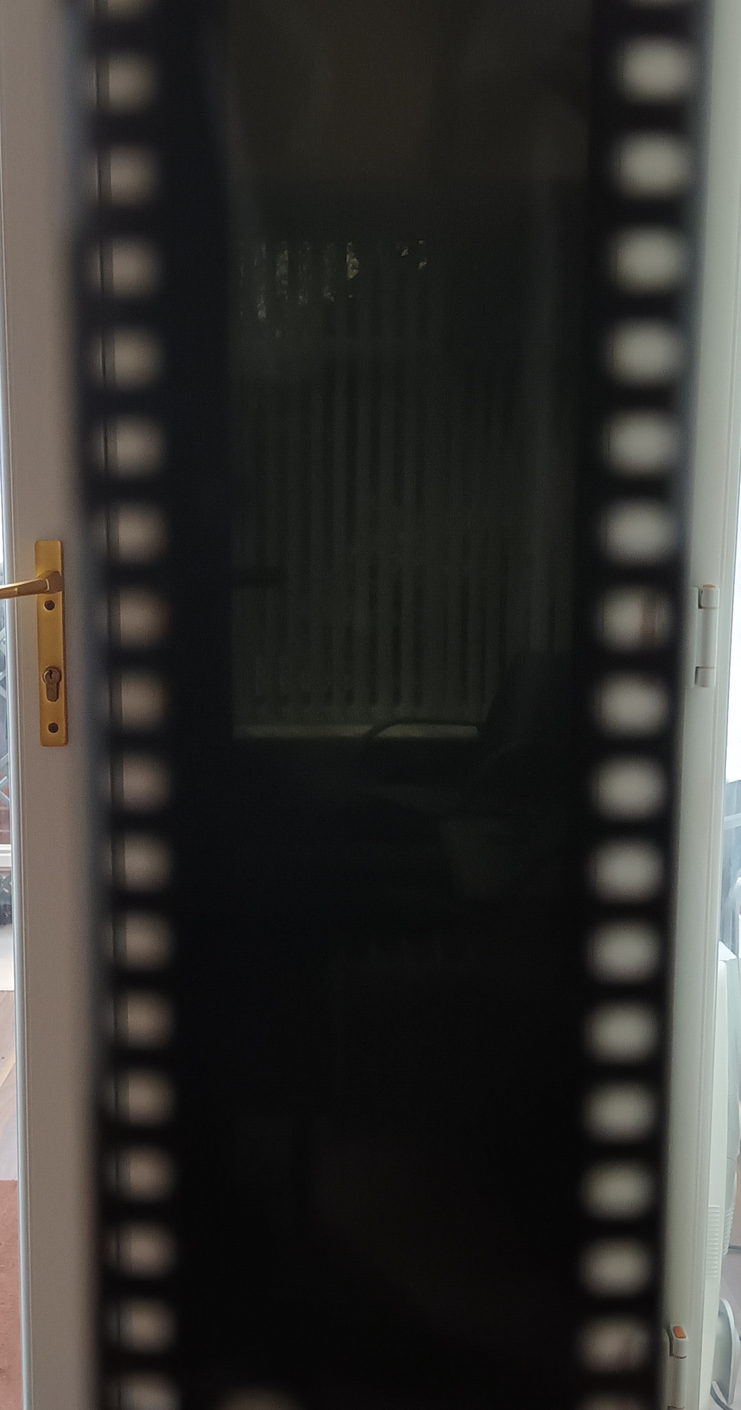

Well, that made a difference. I took my time start point from the film's datasheet rather than MDC, I added 1/3 of a stop to the time, and a further 25% (dilution B 1:31 to D 1:39, I like longer dev times) taking me to 7 minutes. The film was the expired Plus X from a well tested bulk roll, shot at iso64. It looks like I was basing my dev times off duff info. Moving forward, I will only use the HC110 when I have a 100% reliable time so as to build up my confidence with the dev. Thanks for all the advice once again :smile: I have attached an image showing leader opacity. This is pretty much where I like it :smile:
Frame numbers, rather than ghost images - well done!
FWIW, I never trust leader density, but frame numbers from film that I have had previous good negatives from tell you a lot.
Does the exposed film tail have good density? That would give you a clue about the problem.
