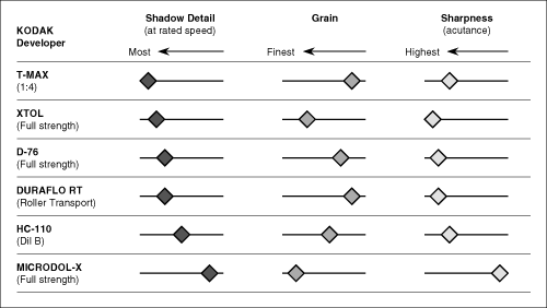

I have found that HC110 is a bit more grainy (my observation and process) than D-76. I notice this the most on 35mm enlargements--on MF and LF I can hardly tell. I really appreciate its ease of storage and one shot mixing. I can mix up enough for a roll of 35mm or just as easily 12 sheets of 4x5. Almost every image in my gallery is HC110. Can't speak to Xtol as I haven't gotten around to trying that one out. Its cheap, predictable, stores superb and gives a lot of option with various dilutions. HP5 and HC110 is what I use 80% of the time. My two cents.
Typically there is a pronounced alteration of the curve shape of the film with HC-110 compared with D76 and XTOL. Not a bad thing just different. Depending on your goals it can be great or not so great. as a for instance TX400's when processed in HC110 curve is a little more toward the curve shape of TXP in D76 give similar activity levels.

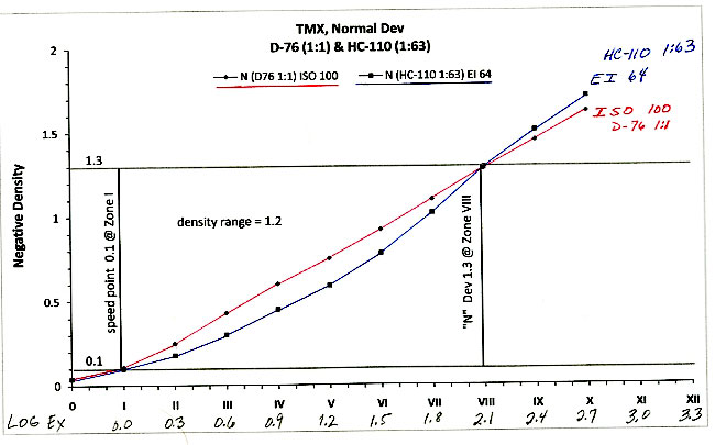

Typically there is a pronounced alteration of the curve shape of the film with HC-110 compared with D76.........
I've shown these before but they apply to your comment. Here's an example of the difference in curve shape between d-76 (1:1) and hc-110 (1:63) in the case of TMX. With the speed target density and the normal development target density controlled, the difference in both developers and dilutions can clearly be seen in how they developed the remaining points along the curve. For equal increases in log exposure, hc-110 develops a longer toe than does d-76, meaning, it builds density/contrast more gradually with each one zone increase in exposure in the toe region.
