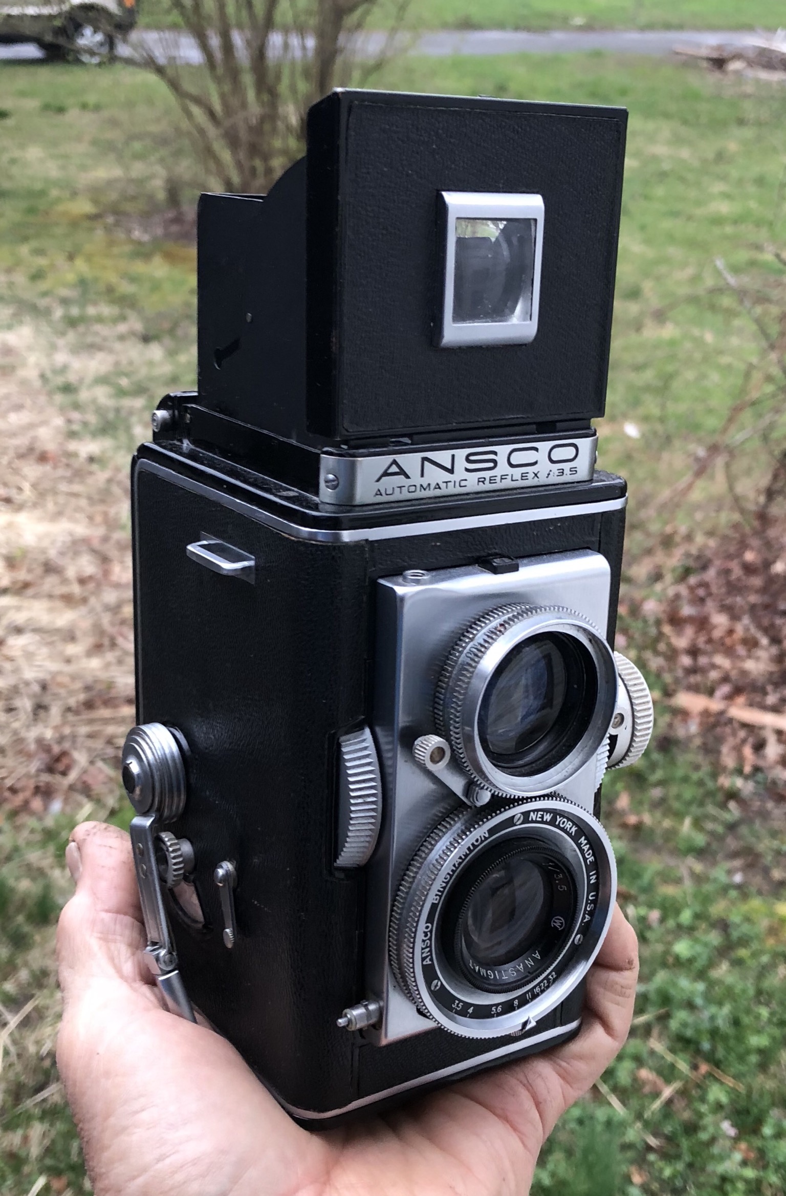

I will heartily recommend the Ansco Automatic Reflex. This uses an 83mm Cooke Triplet made by Wollensak. A Beautiful well engineered camera on all respects. And, American Made!! I made the decision to buy and use one after reading Mike Eckman’s extensive write up on the camera. The images he posted from the camera show just how magnificent this Cooke Triplet really is. The AAR is an awesome camera in all respects!!! https://www.mikeeckman.com/2018/09/ansco-automatic-reflex-3-5-1947/. The Name, ANSCO, takes us back to Edward Anthony who started making gear in 1842.
Have you used it? I ask because mine is flaky as can be. Wind mechanism problems.

..thanks for all the replies and photos. Looks like a Yashica may be the best combination of 'triplet character' and availability. 'RM' - I like your Ansco, but these are rare and working ones rarer still.
