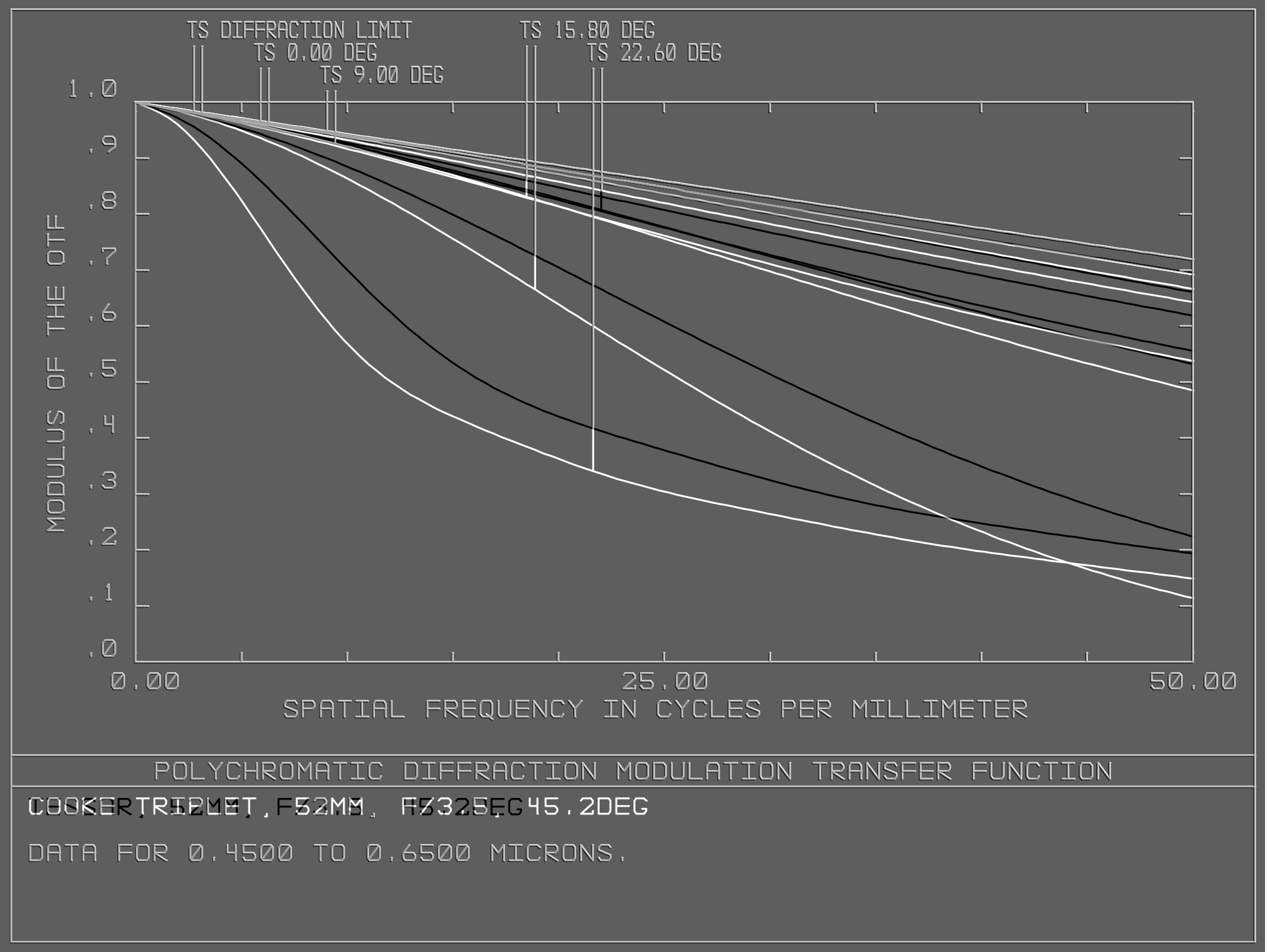

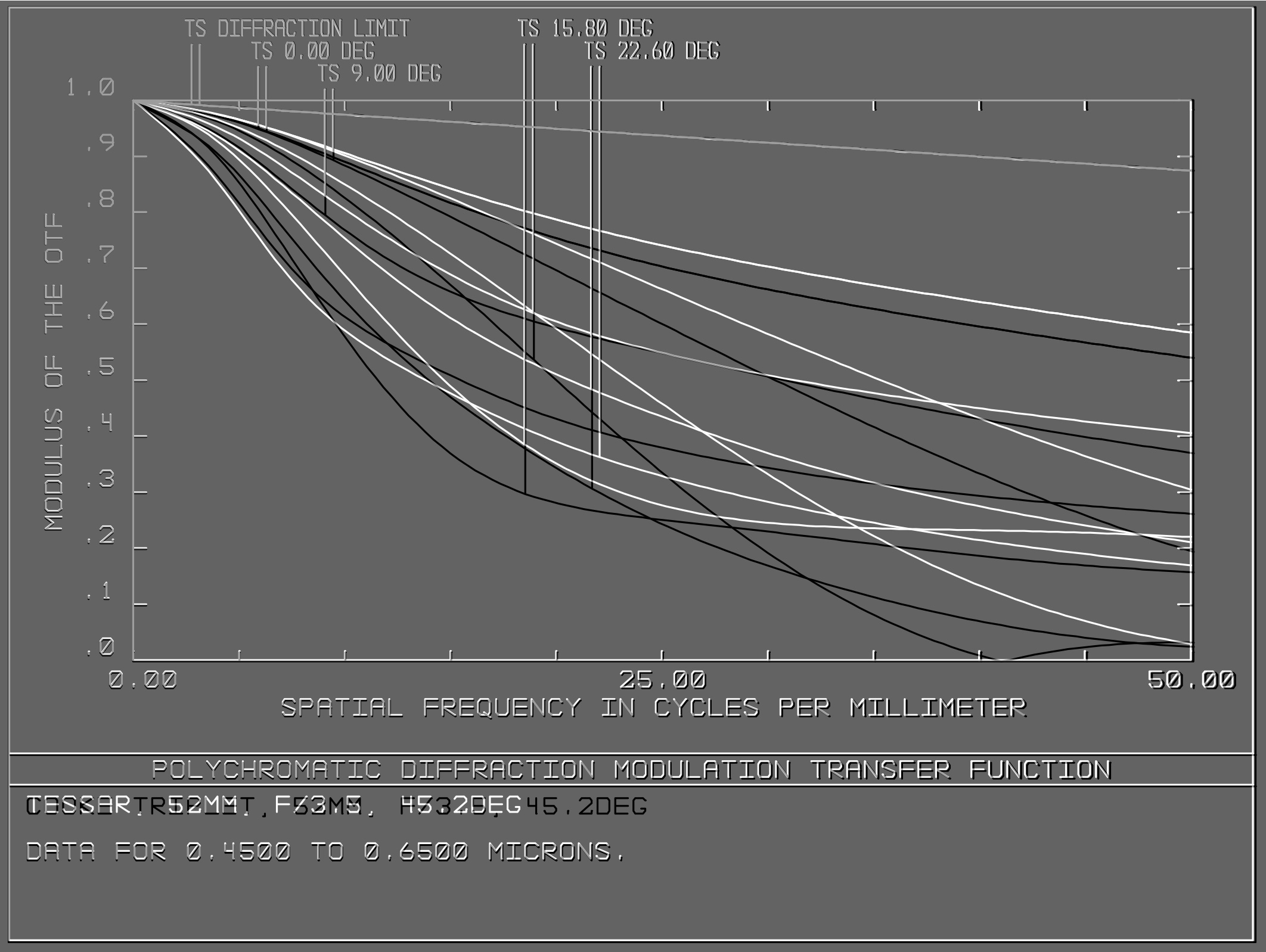

A very quick and crude super imposing of the two graphs from this paper comparing the Tessar and Cooke triplet: https://www.willbell.com/tm/ChapterB.3.pdf
It's very important to note that this is lenses for 36x24mm.
For medium format things are going to look different/more skewed toward equality.
But this still gives some idea of the fundamentals of the differences between the two lens designs.
First is @ f3.5
Second is f8
Edit: I managed to screw up the order of the blends, So on the first the white is the Tessar, and on the second it's the black that is the Tessar.
