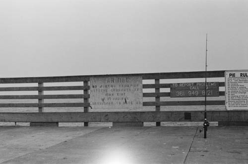

Having an issue with these white spots on the bottom of my negs.

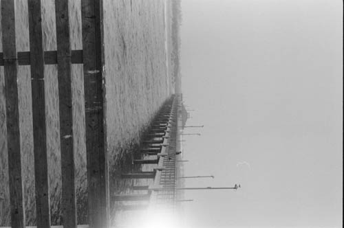

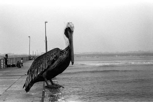

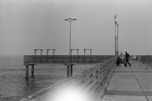

Check these photos I linked to out. I'm having an issue where within a roll of film I have a few but not all images with a big black spot (white on the print) They don't appear to be evenly spaced.
I have three theories on what it could be:
1.) My neckstrap hanging out and getting in front of my lens. I considered this more when I saw it on the first roll but have since developed more rolls from all various times. I think it would be crazy that I have such a habit like this, though not impossible!
2.) Something wrong with my camera. All were shot with a Leica M6, something could happen at a certain aperture, I don't know.
3.) My metal developing tank has a light leak.
All of the times this has occurred the images were shot on a Leica M6 and various films and developers have been used.
Any thoughts. I have some ideas on how to begin testing and eliminating variables but thought someone here might have just seen it already and know what my problem is!

Does the black spot on the negative extend into the rebate and sprocket hole area?
Looks like an in camera light leak to me.

Wouldn't a light leak in the camera produce this effect on all images, not just some?

Looks like a light leak to me from the top of the camera or back somewhere. The most likely place is usually the back, so open it (or flip that folding part out on an M camera) and see if there's something wrong the w/ the seal or the metal on that door or the camera's body. Light leaks are not always consistent. Depends on where the sun is at, where you have your hands at on the camera, which way it's pointing when you took the shot, etc.

if the leak stops at the frame line its not coming in the back. Pinhole in shutter curtain?

I guess I'll probably rule out the strap idea, since thinking about it, that should make the negative clear due to no light and print black.
I also suppose it's not a developing tank leak since the light wouldn't stop at the frame lines.
So I guess it is the camera.
What's a good way to check for pinholes? Flashlight in the dark?
Sounds like an expensive fix, oh well!

Given that it's in the same spot each time, then it's not a problem in the back, nor is it a strap/cap or it'd be black.
I'm voting for pinhole in the shutter. Try to think back to when you took the photos, were the ones with less leak (like the Smellican), shot sooner after the previous (in which case, less time for a pinhole leak to invade), and the ones with more leak (like the first) had longer time sitting behind the shutter for a pinhole to get that bad?
Or, it's a leak when the shutter is opened, coming from somewhere in the space twixt shutter and lens. Were the worse leaks longer exposure times, and the lesser leaks shorter times?

It's a pinhole!
Just got home and shined a light on it. It's right at the top of the shutter which I guess translates to the bottom of the negative. I hadn't thought of the pinhole idea so I'm glad I posted this, thanks everyone!
I'm going to head to Home Depot and try to get some liquid electrical tape cause I heard it works. The camera had a CLA before I bought it about a year and a half ago so I'd rather not send it for a replacement curtain.
What's likely to have caused the hole? I don't use a lens cap but it seems strange that it would burn a tiny hole so far in the top, I also try to keep the lens wide open.
Thanks again, sorry if this ended up in the wrong sub forum, I didn't realize it was going to be more about my Leica then film or processing.

Glad you found the culprit. Lens inverts the image. Pinhole on top. Leak on top of film which translates to the bottom of the image.
