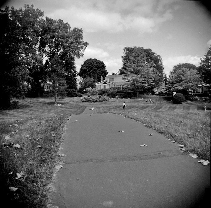

With my 635 Yashica shooting 120 film I found significant vignetting on both the Yashica aux tele and wide angle..Center was ok so some cropping would be necessary. Attaching the aux lenses did not seem as secure as I wanted as the are heavy. See images. 1st w/o aux lens.
