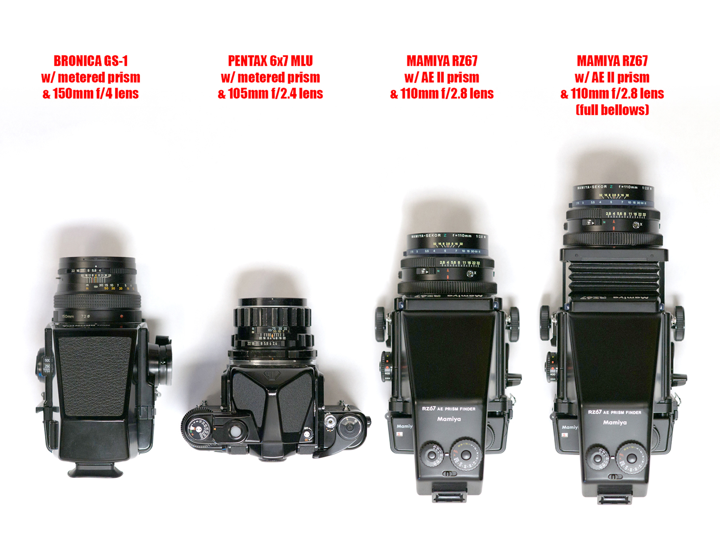

I'm looking for the most portable Mamiya RB67 alternative (based on size and weight) in that narrow focal range (125mm - 150mm) with the least tradeoffs. I landed on the Tele Rolleiflex.
It's called "Bronica GS-1".
And if you don't need leaf shutter lenses, the most portable is the Pentax 6x7.
And if you don't need reflex viewing, the most portable is the Mamiya 7 rangefinder.
If you care about size...
(Note: image isn't mine)
