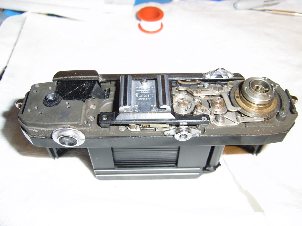

With that stated: Contax IIIa, cleaning the Viewfinder and RF prism. Picked up a Contax IIIa and Nikon S4 that had been stored in a very humid Safe for years. Bought a collection of bodies and lenses. Spent lots of time cleaning them, got to all but one lens in time to prevent permanent damage. The S4 finder: easy, 20 minute job. The Contax IIIa: about 4 hours. Not designed to be easily repaired and cleaned.

IIa. Easy.
RIMG0753 by fiftyonepointsix, on Flickr
IIIa. Not Easy, I filled Two Ice Cube Trays with parts in order of disassembly.

The open Ice Cube Tray: I use this to keep the parts in order as removed, when putting back together- just go in reverse order. Start and finish the repair, never store the parts in the tray. I tend to do a repair from start to finish, or at least in stages that can be completed in a session.
