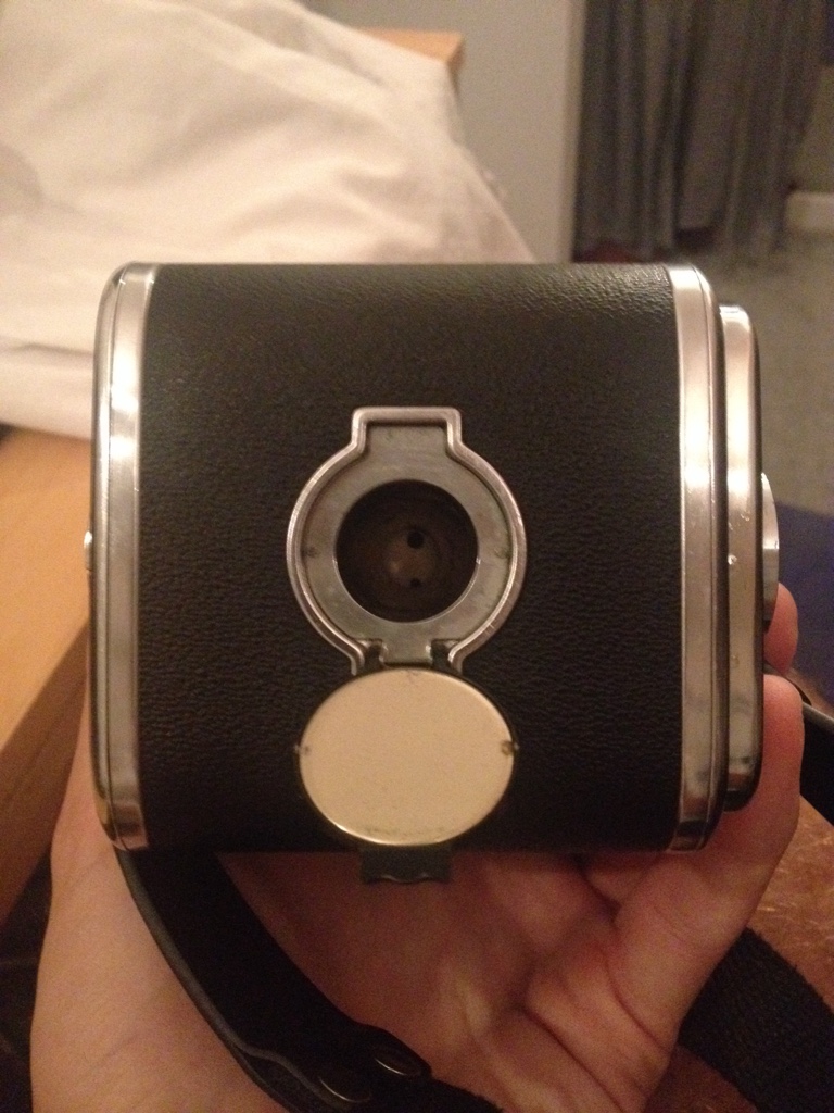

Hi everyone,
I recently picked up my Hassy after a few weeks of not using it and noticed for the first time that the frame number isn't visible through the window at the back of the C12 back when the shutter is cocked and both indicators are white. Only when I wind on to the next frame can I see the number going past the opening and then once I've finished winding all I can see is two different sized circles. Is this correct or have I loaded it incorrectly?
Thanks for any advice and insights!
Rowan

Thanks for the reply but my question wasn't how to load a C12 back, but what you should be seeing through the tunnel when the shutter is cocked. Should there be a number (matching that on the side of the back) or two circles (one larger than the other.)? If you can lend anymore insights to this that would be much appreciated! Here's a picture too: ImageUploadedByTapatalk1441144268.778826.jpg

Thanks for the reply but my question wasn't how to load a C12 back, but what you should be seeing through the tunnel when the shutter is cocked. Should there be a number (matching that on the side of the back) or two circles (one larger than the other.)? If you can lend anymore insights to this that would be much appreciated! Here's a picture too: View attachment 115750
You should see the frame number in the opening when the shutter is cocked. You have loaded the film incorrectly or the numbers would be there. I don't use those backs any longer and have forgotten the exact loading procedure.
bdial
Jan 2, 2005
7,516
North East U.S.
The tunnel is only there to get the roll positioned for frame 1, from there on, the gearing determines how far the film advances. If you're getting 12 frames on the roll with reasonable spacing, I wouldn't worry about what you see or don't see in the peep-hole.
Like Jim, I've not used one of these backs in a long time, so I don't know what to expect if you look in mid-roll.
Sirius Glass
Jan 18, 2007
50,836
Southern California
There is a conical pin that sticks up. It is not fully out so the counter did not reset. I just had that happen to one of mine so I sent it for a CLA.
