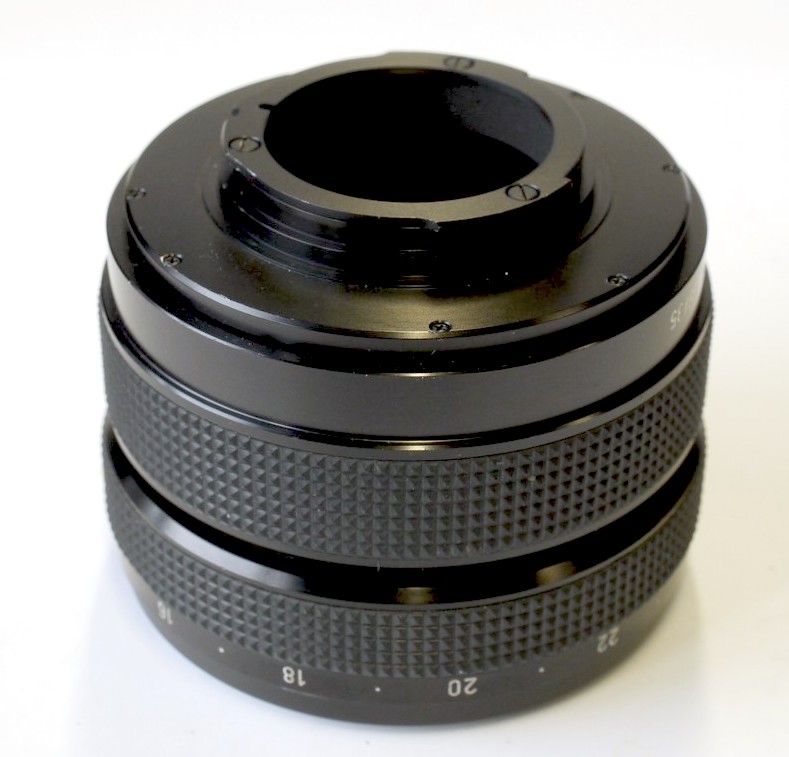

I'm considering purchasing some Hasselblad lenses and adapting them to my Mamiya 645; any thoughts?
My M645J has been a flawless camera that only needed a simple light seal replacement. I've used its native lenses as well as lenses from the Pentacon Six mount and both have worked wonderfully.
Maybe this is where you got your idea, but if you have not seen it, this is the Rollei SL66 to SL35 adapter. It accomplishes a similar task to which you seek.
It may give you ideas for construction of your adapter.
Looking forward to seeing your solution.
