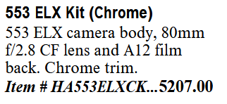

I wanted to mention that there is a gold mine of information on late Hasselblad cameras and accessories available here:
1998 sourcebook... go in and look at the prices for the gear and then adjust to today's dollars and be shocked at how high they were. Certainly primarily for professional use because who could afford that otherwise?
Anyway, the catalogue has all the Hasselblad products and the Hasselblad item code from that time, so it's handy. Want to figure out the focus screens? You can with the descriptions in there. Hoods and prisms? Yup, at least for those that were available at that time. All the accessories you can no longer find? Yup... and weep at your inability to find them even with constant searching on the web...
You mean like this?
Recent working sold one, no back, viewfinder, or lens, went for $378.

You mean like this?
Exactly! That's why I bought a 553ELX whether I needed it or not. One of the greatest bargains I have run into. Mine was about $100 less than $378.00 when I bought it more than a few years back. It also didn't show hardly any wear in the area of where the back is coupled to the body. That is usually a very good sign of light use.
