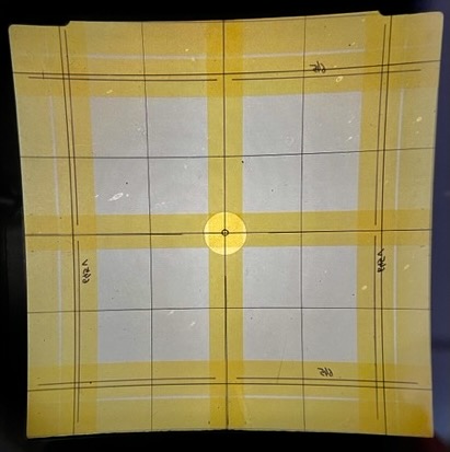

OK, test is done, good enough for basic pimping purposes.
Conclusion is quite simple, full view in the finder is larger than actual on negative, and the corner marks are for 645, except also quite outside of actual negative.
Corner marks fall about in the middle between 645 limit and full square negative. So using these marks as actual cropping aid for square 6x6 gives some margin of error, to me safer way in most cases. Where there is a need to take advantage of full negative area, the only way to go is with focusing screen adapter, finder is not good enough.
Pics below are not perfect, would have to toy around with proper D set up to get, especially finder view better, but show enough I think. In the finder you can see area outside of target (shown as on-screen), that's how much more you see in the finder vs. on the focusing screen. Note that pic for finder view taken after dropping camera to compensate for parallax.
Zoom into finder's image to see better.
Grid lines on the focusing screen match 645. In the pic they are not exactly aligned because of the pain getting the whole thing aligned.
Side note, had 3 bubble levels on this set up, tripod head itself, Hasselblad quick release plate and camera. They never came together, just in case anyone wants to argue their application for critical work, i.e. testing.

Different enough to chop toes off and any appendage that's close to the edge. I only did this to see what they meant, and they really should have explained it better, not leaving a user guessing. I'm glad I've used corner marks thus far for square framing though. It's kind of same "close enough" only the other way.

Gee, there is a mismatch and it is good to know there's one and how much. Hasselblad was not clear, so I cleared it up for them.
I realise SWC does super wide stuff and edge detail is not much of a concern for the most part. But sometimes it is. You called me WRONG by saying corner marks are not for the square framing. Turned out, I was only somewhat wrong as they fall just about in the middle of what I said and what the whole view is showing. So Hasselblad's "slightly" is not really all that slight.
So I've been using the corner marks for square, and now I am happy, as stated, I have and will continue to. Just now I know I can compose right over those marks and I will be sure to still have it all on the negative.

Thanks this clarifies. Although I feel like doing my own test :smile:
Pics are distorted because of several issues doing it quick and dirty. Absolutely do your own. I just now know what to use and where, and 645 framing, to be safe, needs to be done on the imaginary line between the INNER ends of those corner marks. That will show tiny bit less than on negative.
