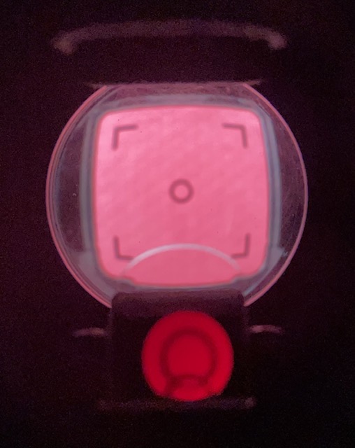

Hi, I'm thinking about getting a A16 back for my SWC/M. My model has the later plastic viewfinder. I can't seem to find a mask that would help composing 645 in the viewfinder. The Hasselblad mask that's rather easy and expensive to find fits the first version the viewfinder. Also, I assume there is a proper mask I can use with the focusing screen adapter and Rmfx Viewfinder? Want to be sure before spending more money...again. Thanks.

My viewfinder only has 4 corner marks forming a square? It does not have marks for 645....

I have just looked at my SWC viewfinder and while there are certainly no 645 mask lines, it looks like an imaginary line between inner ends of corner marks is a fairly close approximation.

To be frank, I don't know what prevented Hasselblad from putting actual faint grid lines in that view, so as to leave all the guessing out when composing. This reference marking will work most of the time, but tight framing against imaginary lines is not as good as actual visible line all across the frame.

But the corner markers are for square frame, and I would not be too trusty, if the whole view were to be what's covered by the frame, at least there is extra coverage outside the lines shown. I like it that way better.
