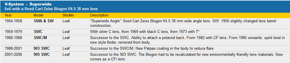

As for models I am still figuring out what the differences are - C/M/903/905/More ???

Its history is very complex, as many different models were released since the SWA introduction in the 50‘s.

The lens design remained identical (apart from coating) from the 1st version to the 903.
Then some element needed in lens manufacturing was banned due to environmental laws in the early 2000’s. A new lens was designed and introduced with the 905. The 905 lens is supposedly better in he corners and slightly worse in the center than he original design. (splitting hairs here) You can see the MTF charts on hasselbladhistorical.

Where does SWC/M stand in the model line up?
Some have the spirit level in the viewfinder. It is important to use the spirit level to avoid distortion.
