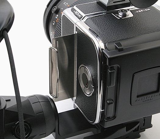

A word of warning, I have this on the SWC and it's great (all my cameras have Arca adapter). HOWEVER, on the 203FE, probably due to the size of the ball head / plate / adapter etc., it destroyed by plastic foot rest thing :-/ I "repaired" it using Sugra, but it ain't pretty

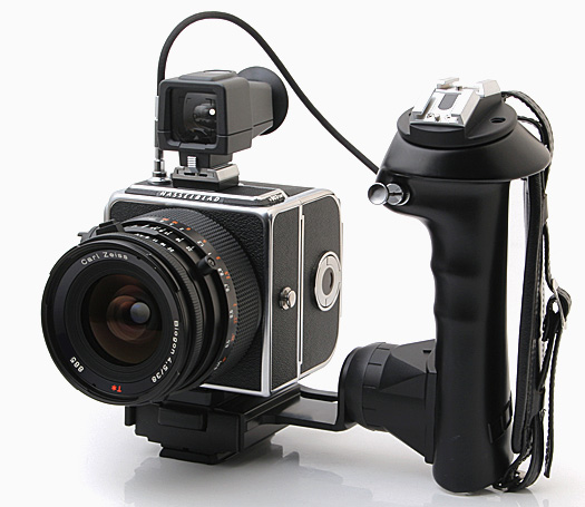

And what do you know, a side grip was made for the SWC
Hopefully this is not the case on any 500 bodies, as that is the only direction I will take V kit after SWC.

Further poking at SWC set up, is anyone here using this rig? or tried at least. I know this makes compact set up not longer so, but I'm asking about what it feels like in use.
Deleted member 88956
It's a bummer. Need to remove grip to work the dark slide, although grip is quick mounted, so not end of the world.
You answered the question on use of a totally useless grip on a perfectly functioning body. Nice film back; I do not have one that new.
