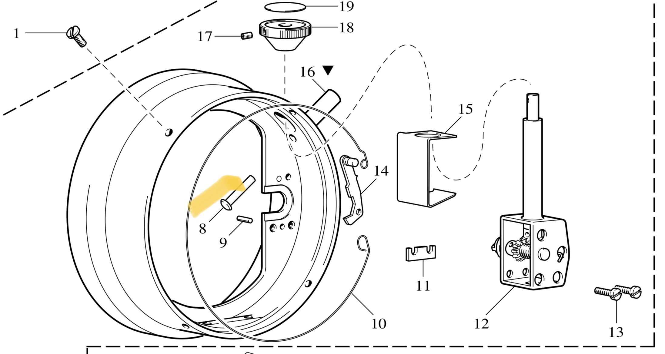

I always appreciate the wealth of knowledge here, the list of repair folks other than the usual suspects are certainly appreciated. Now then, on to more pressing matters. I currently have a replacement Hasselblad Flexbody on the way to me by FedEx in the Faroe Islands, I hope to get it in hand by mid next week and I am using my backup, a recently CLA’d 501CM in the meantime.

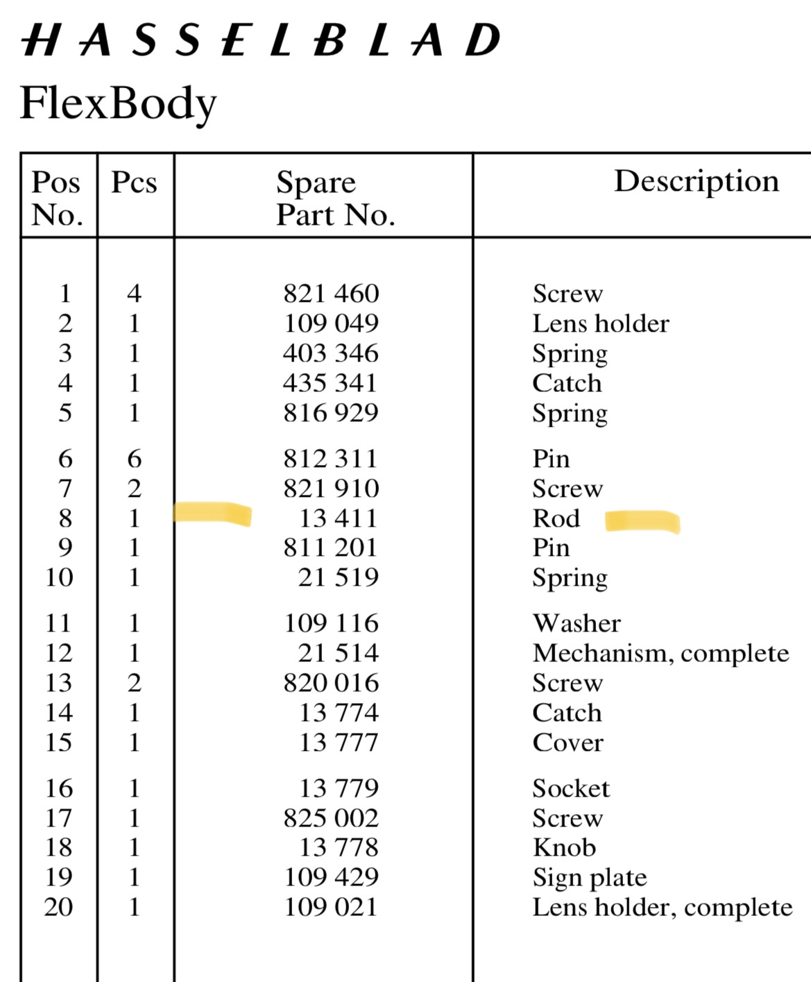

For some reason and I suspect it could be because the cable release I was using might not have retracted all the way back in, the flat tip or retainer part of the rod that serves as actuator for the shutter has sheared off. I tried to cobble a solution together with my limited toolset but no dice. With the flat tip gone, I put a flexible cable release extender in to keep the pin in place but it only resets the shutter part of the time and is really rough to fire. I don’t want to damage anything else so this camera is officially down.
I contacted both Hasselblad NJ and David Odess and neither said they work on the camera, NJ says they no longer stock the parts. I have also reached out to the other people listed above and await their replies. As you can see here, I have got the problem nailed down but need to get expertise on this when I get back stateside, even if the repair person is outside the U.S.
So with that, any go to people in the EU?

Steve's is pretty busy right now. They're referring all Rolleiflex work to Harry Fleenor and won't do digital at the moment. Not that that's your issue, just know they're not doing quick turnarounds. On the other hand, if you explain your situation and it is a simple enough repair, they might make an exception.
Thanks, since I am expecting the replacement Flexbody to be in good working order, I can certainly wait on the current one to get repaired.
If the part can not be had and I am betting it can not, I think a button head screw roughly the same size could be modified and filed into a shape that would do the trick. It’s a pretty simple camera really, not like the other V series bodies where several things work in concert.
