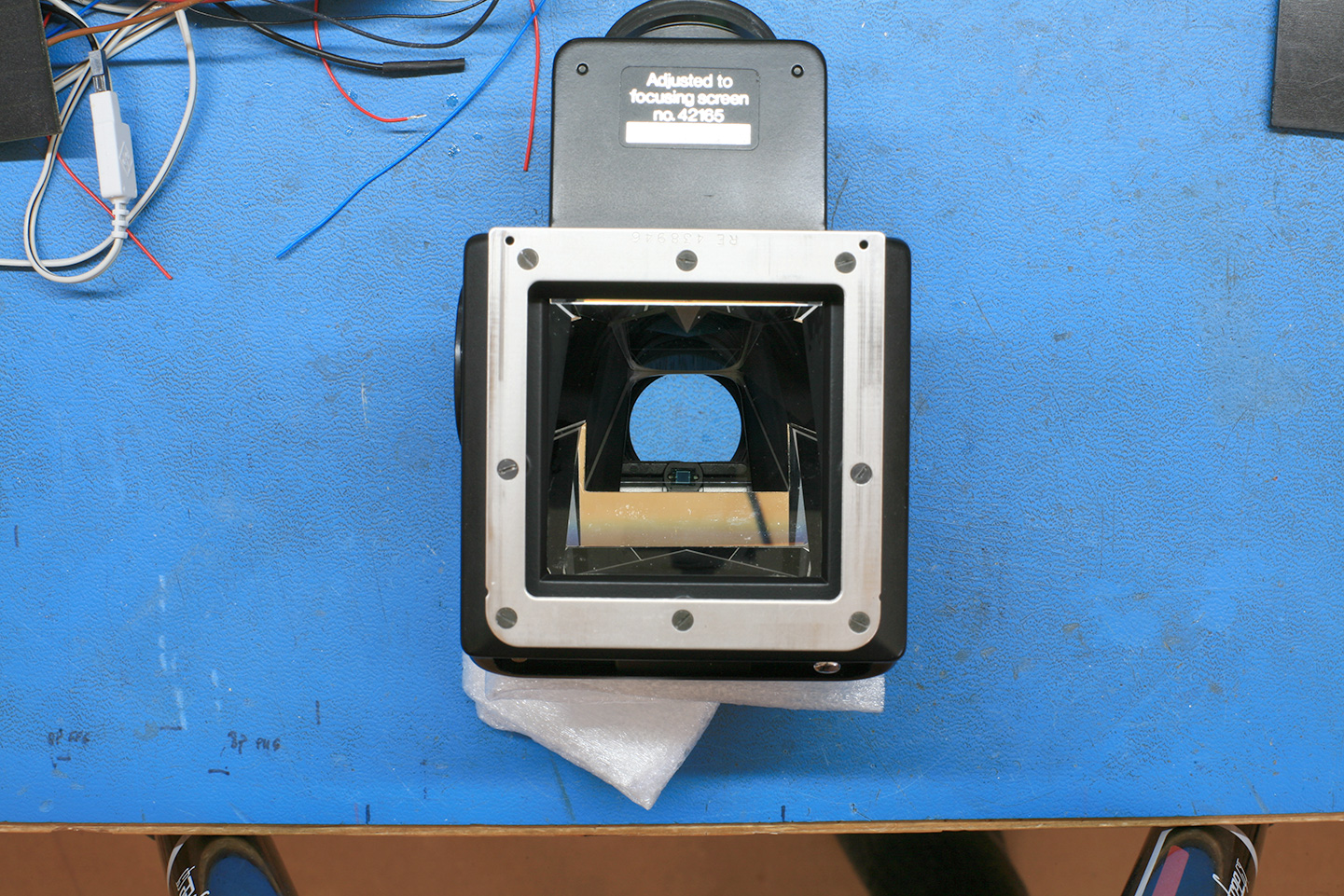

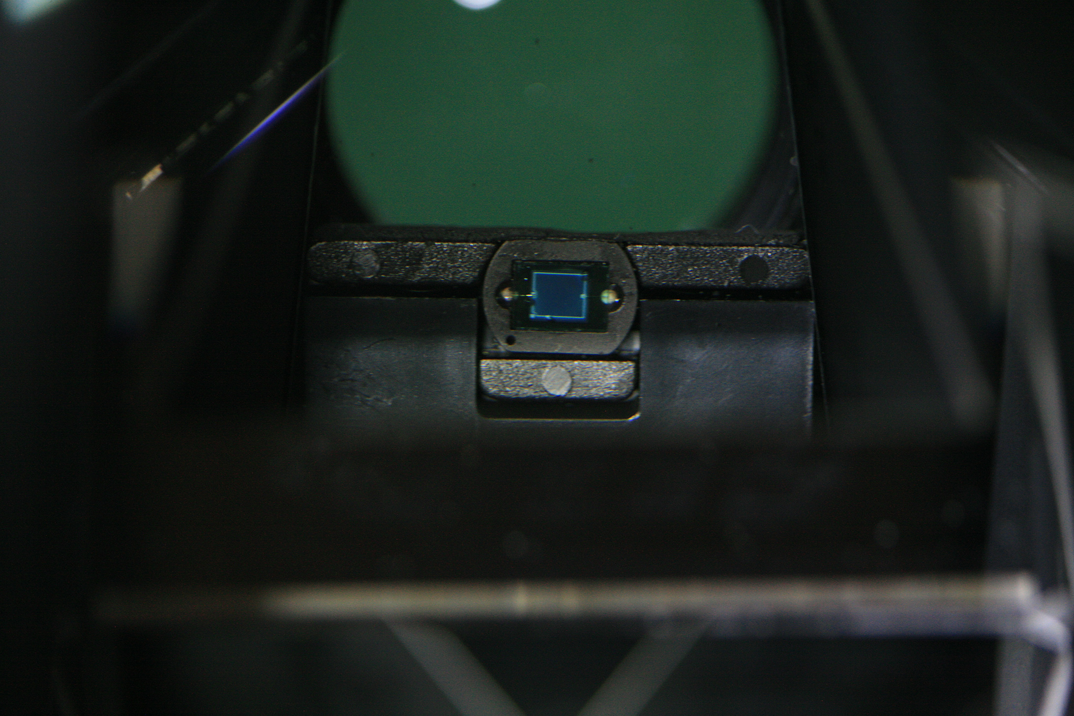

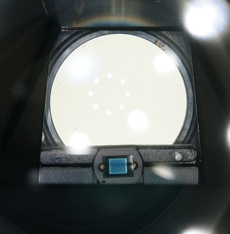

Does the bottom view of my PME3 look reasonable? Especially the "vertical" position of the photodiode. There is a ~1mm gap visible between the plastic frame and the plastic bracket that holds the
diode.
Maybe the diode got displaced over time?
Mine is more crooked than yours!
