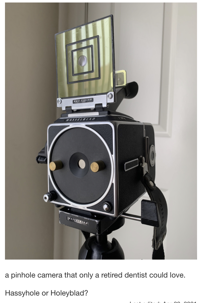

A little late but here are some snaps of my Hasselblad pinhole 'lens'.
