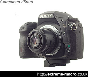

"Reversed enlarger lenses are one of the mainstays of extreme macro photography"
Please see this: http://extreme-macro.co.uk/reversed-enlarger-lenses/

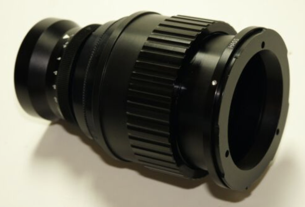

Apparently,Hasselblad "V" s\Series lenses can be used as enlarging lenses.
Seems oddball. Do you have a picture or link?
Do you mean an enlarging lens with a V-series mount (like picture) or a hypothetical V-series lens with a Leica Screw Mount to fit an enlarger?
Has anyone here done this and if so, what were your likes or dislikes about the matter? Eli

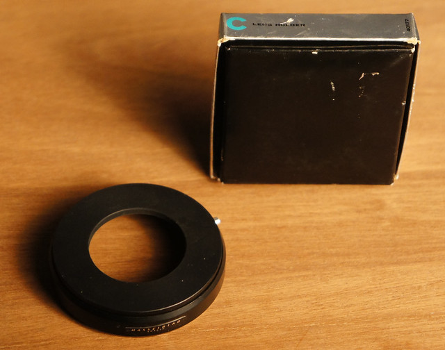

I think I have the item being discussed, the "Hasselblad C Lens Holder 40177" Need to try it out some day....
Hasselblad C Lens Holder 40177 2 by Nokton48, on Flickr
