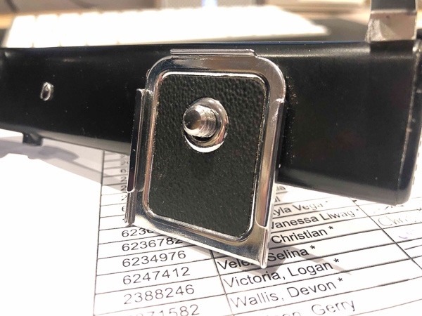

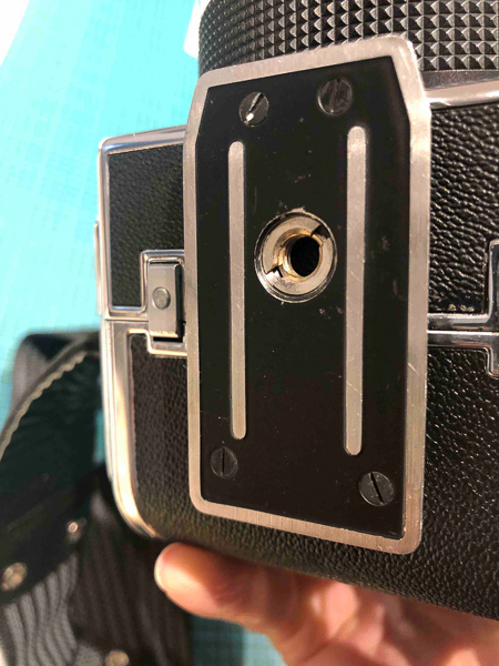

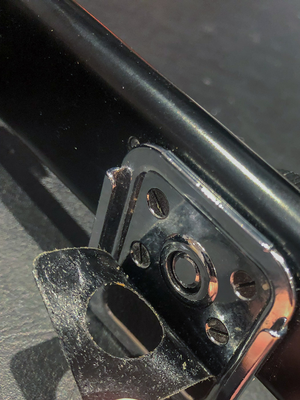

I decided to give the Hasselblad 45020 bracket a try with my SWC. It turns out that the screw that holds onto the base of the camera is in the wrong place. This is strange given that the systems chart shows this bracket working with the SWC. The screw hole on the camera mounting plate is about 1/2 inch further back than the screw on the bracket plate. I can't push the camera any further forward because the bracket plate has a lip that stops the camera moving any more forward. I thought about grinding away the lip but realized that if the camera goes any further forward the position of the handle will prevent removing the dark slide! Am I missing something here? Anyone else try one of the Hasselblad brackets with the SWC?

Your camera has the new style foot, the bracket you have is for the old style foot.
The easiest thing would be to find the correct bracket. Hasselblad had parts to modify old cameras to the new foot. Not sure if anyone made an adapter.

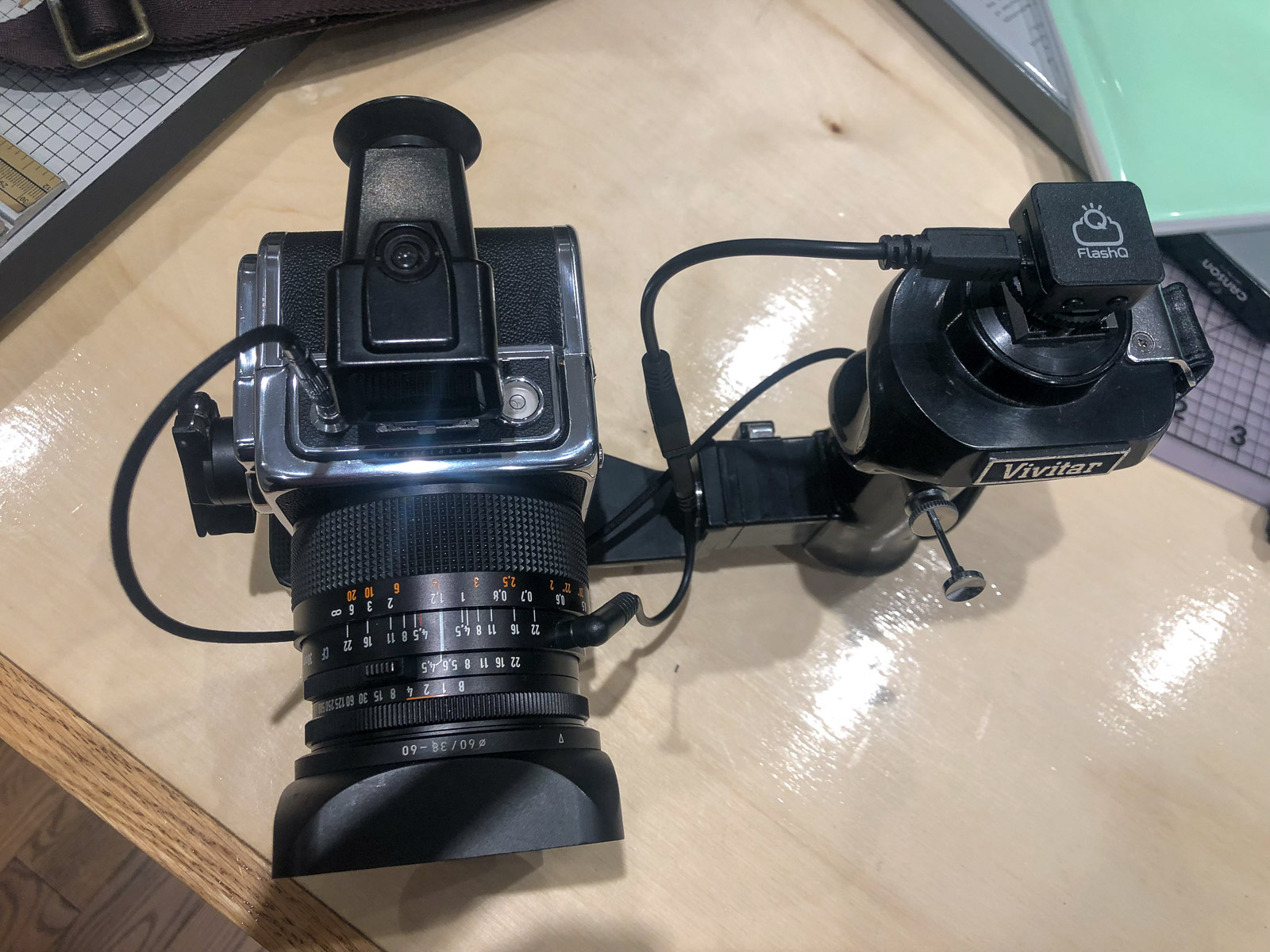

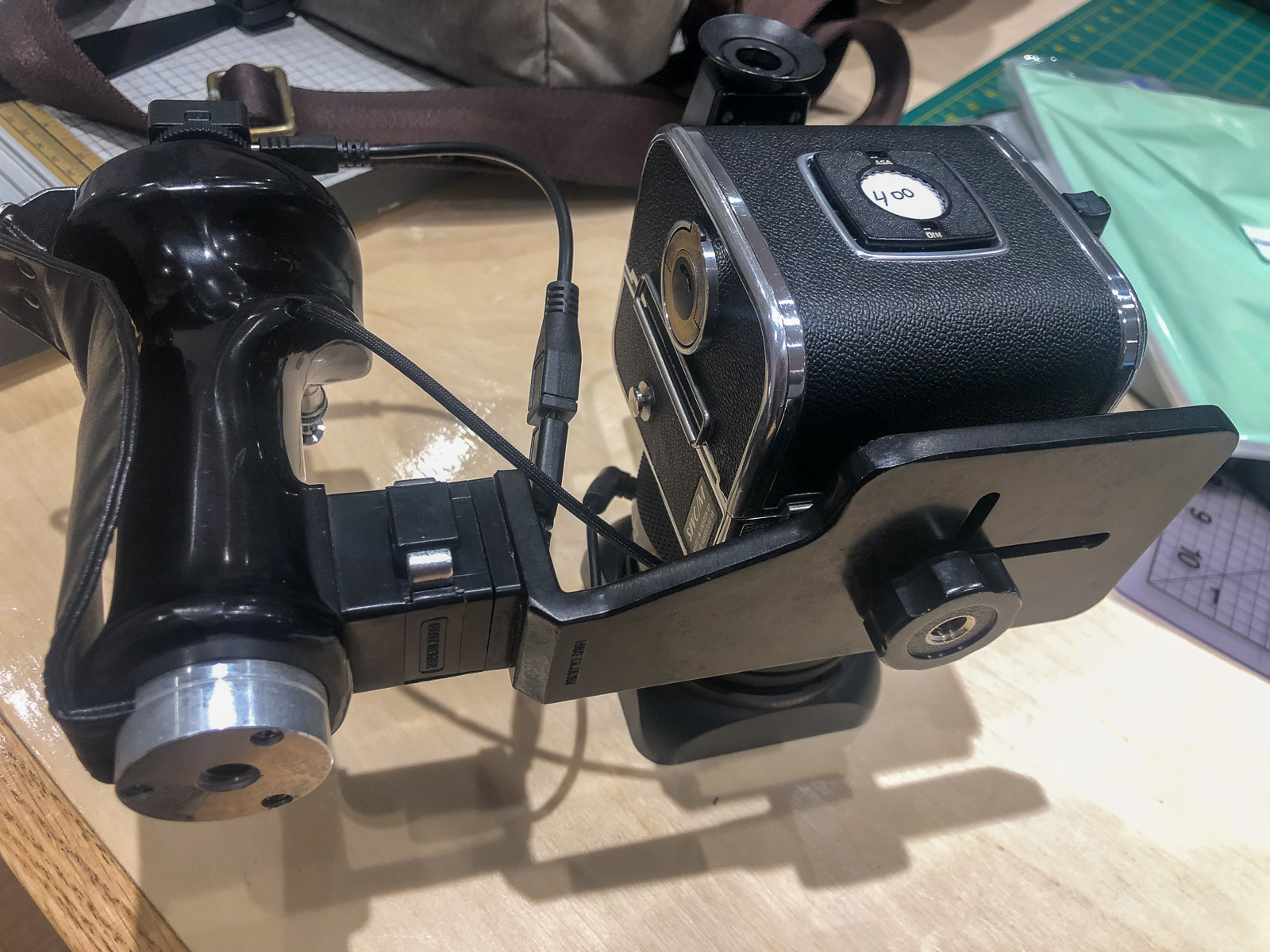

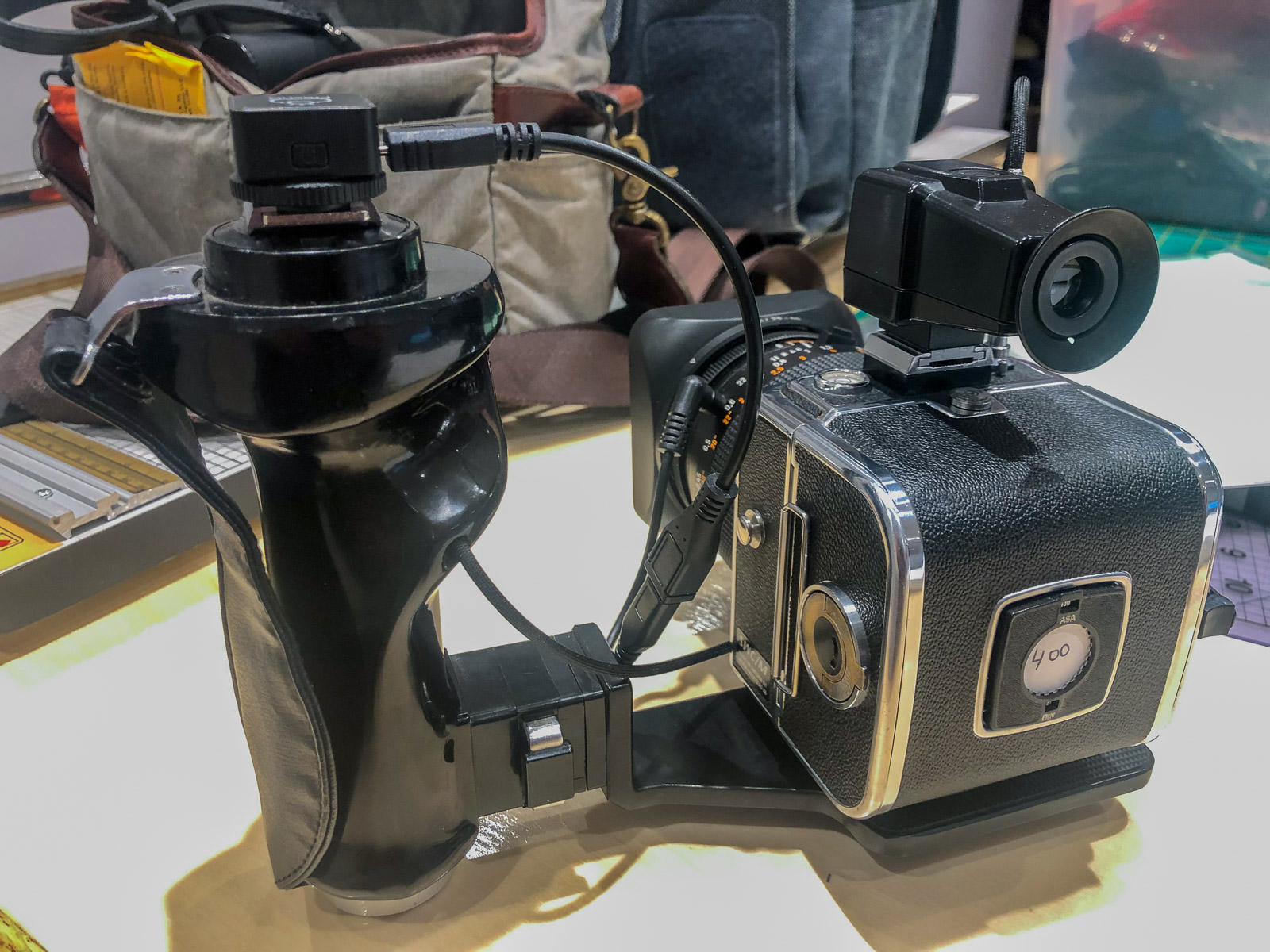

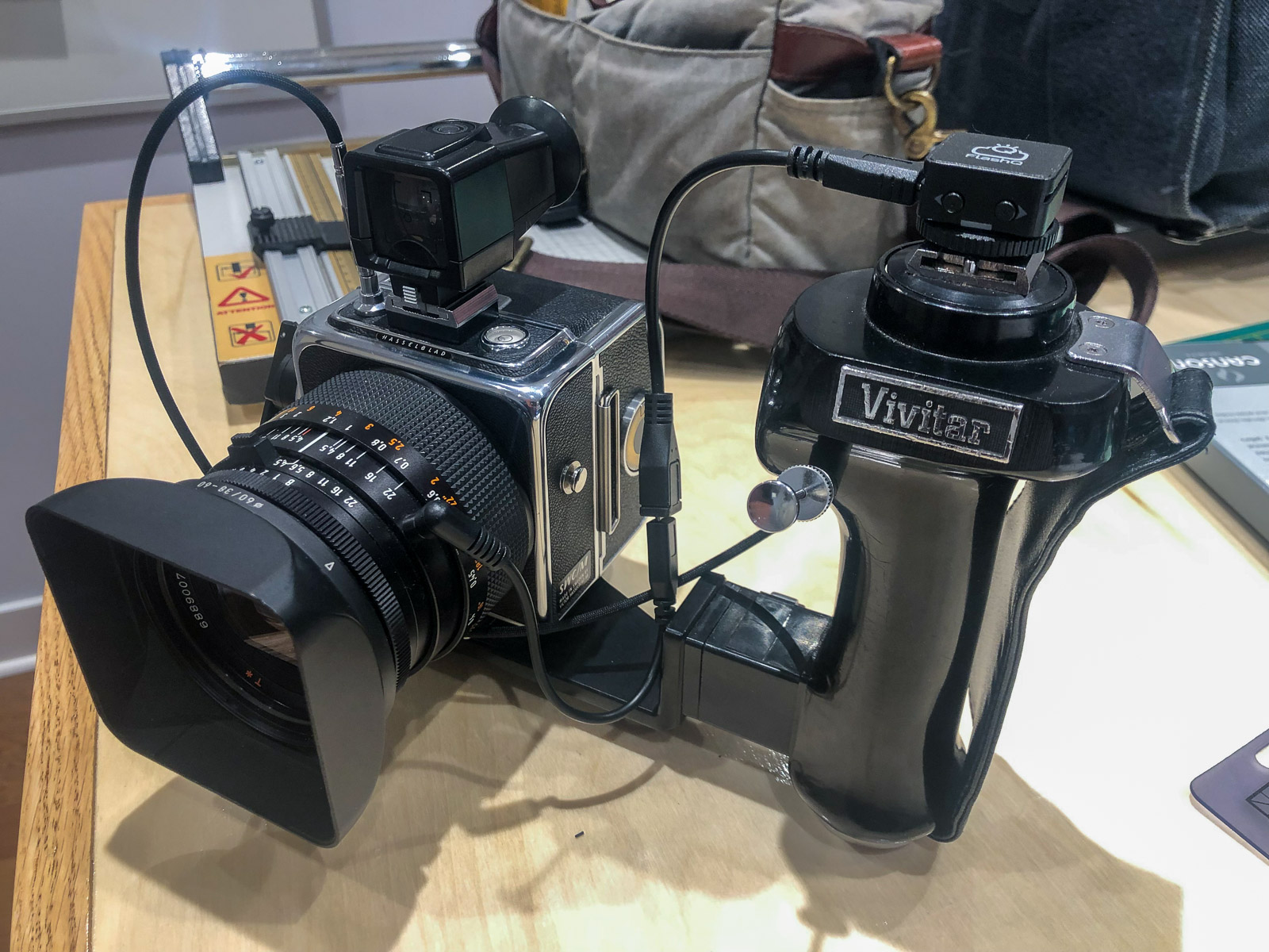

I finally got around to taking some pictures of my current SWC/M flash grip setup. I've found surprisingly little information on left hand grips for the SWC. Possibly because most don't need one. I find it very convenient, and for the way I like to use the camera, indispensable.
I've been using the Vivitar PG-1 left hand flash grip, with the CB-66 base plate. The grip has a rotating cold shoe and a replaceable/removable cable release. Both features are essential for me. I attached pictures of the setup I've been walking around with for about a month (less the neck strap).
This suits my needs well, which are to be able to shoots comfortably during the evening hours with a speed light in my right hand wirelessly triggered. I like to be able to do as I wish with a flash rather than have it fixed near the camera.
While I'm finding this a good solution, there are two issues that I'm not sure I can live with in the long-run. The first regards the distance between the camera and the handle. At its closest (as shown) the camera is about 4 inches from my wrist. I think this handle was primarily designed for larger medium format bodies. This didn't seem an issue until several hours of lifting the camera to my eye repeatedly. There is a twisting force applied to the wrist that really wears me down. The second issue regards the attachment of the camera to the base plate. This is straightforward, except when I need to use a tripod or want to use the camera without the grip it becomes a PITA. Quick releases for camera and tripod could be adapted but would add weight at the very least.
I'll keep this setup for now, but I am eyeing the Hasseblad 45169 grip which appears to be perfect for the camera :smile:
I hope this is helpful to some....

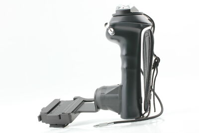

Just want to confirm that the Hasselblad 45169 snap lock flash grip is NOT fully compatible with the SWC. The dark slide is not accessible with the camera in the grip. This is problematic not only because changing the film will require removing the camera (easy enough with the quick release plate), but also because it requires removing the shutter cable and possibly the PC cable to the lens.
The Vivitar seems better now! I'll be meeting with a machinist on the weekend to see if a modification can be made to the Vivitar baseplate to move the camera body closer to the left side handle....

Is the Hasselblad specific receiver removable( are there screws under the leatherette) so it could be replaced with an arca swiss or stroboframe quick release?
Great question. Yes there are 4 screws and it could be modified (Hasselblad 45020 bracket). I'll be considering this option as well...I attached a picture

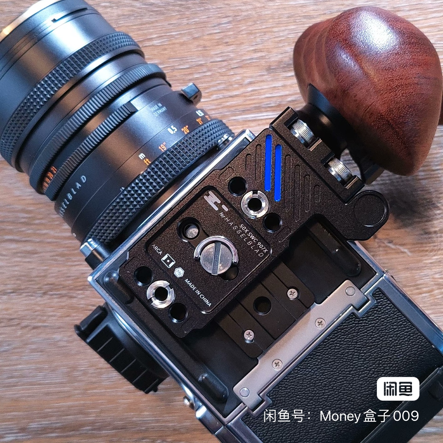

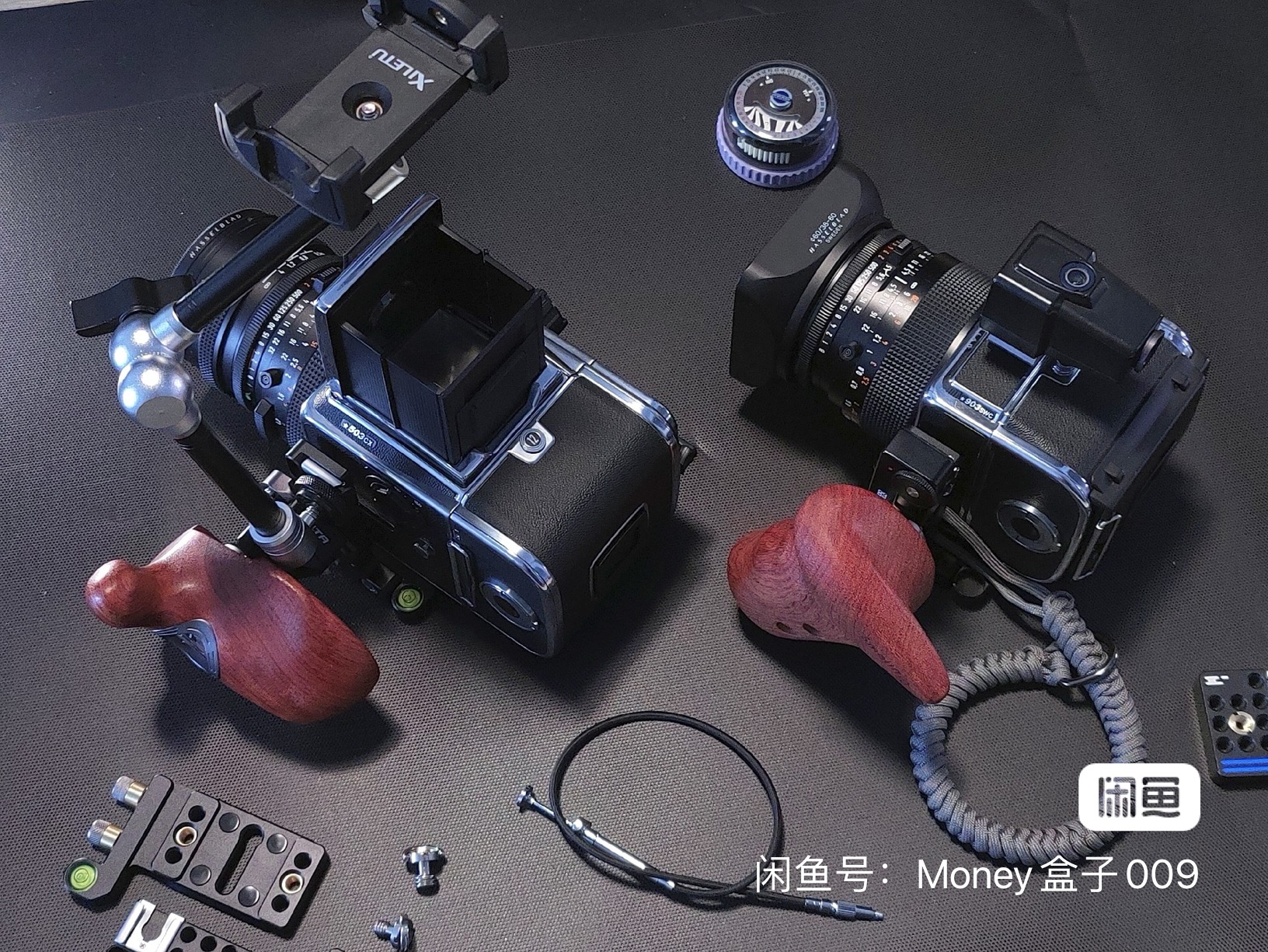

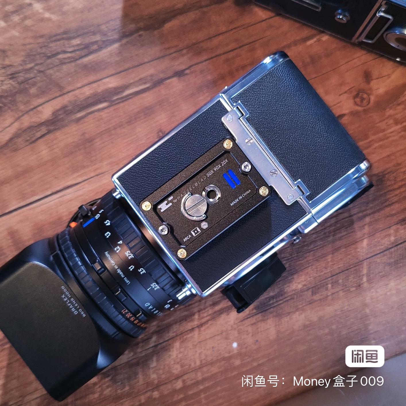

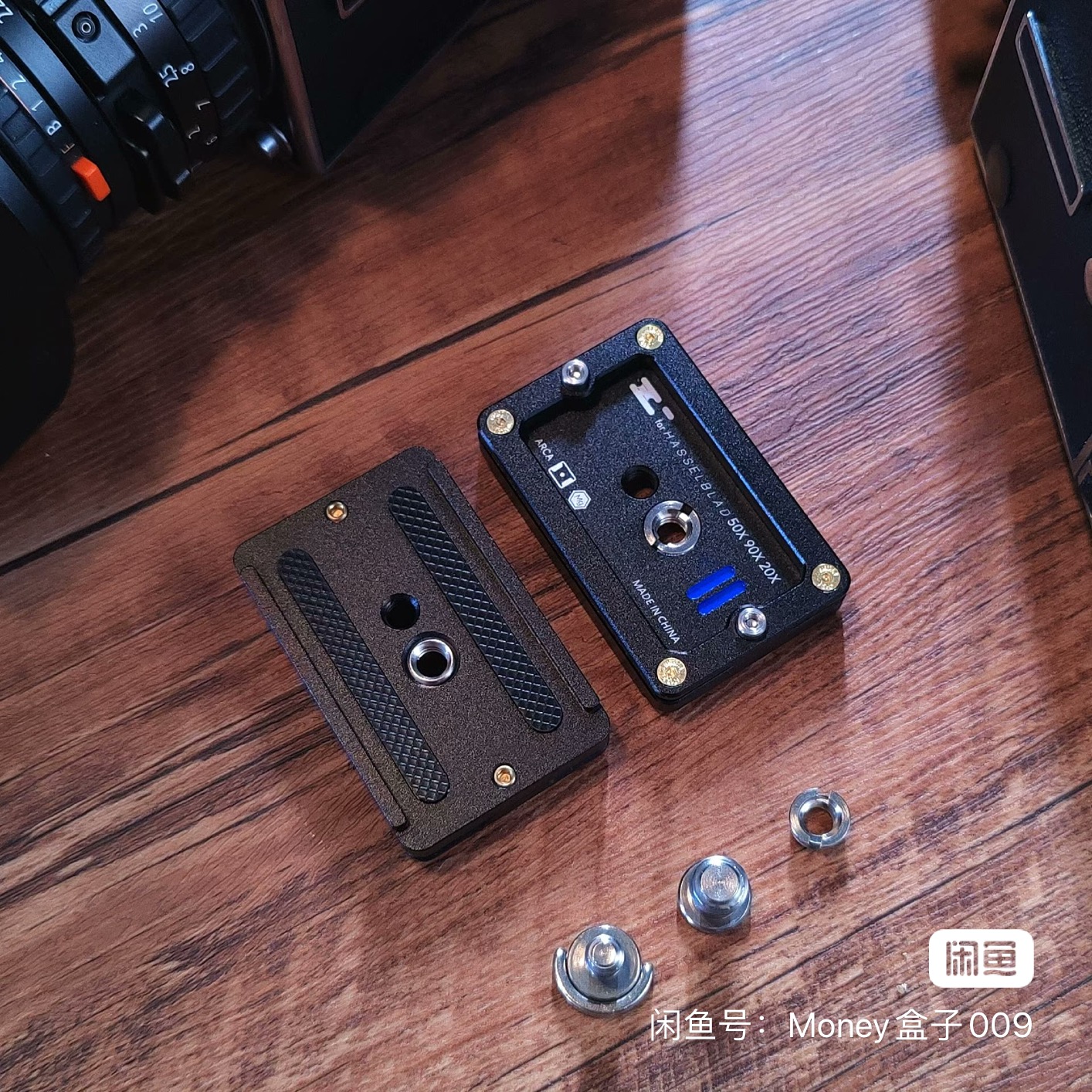

Nice. Where can you get that L-bracket for SWC? Thx
The L-bracket was made by a seller on a Chinese second-hand trading platform. I noticed that many Hasselblad film camera users in China buy products from this seller. The price for this L-shaped bracket is approximately $61 USD.My English is not good, so all the responses are translated using ChatGPT.
Thank you for sharing this information. The grip looks great. Welcome to the forum. 😊
