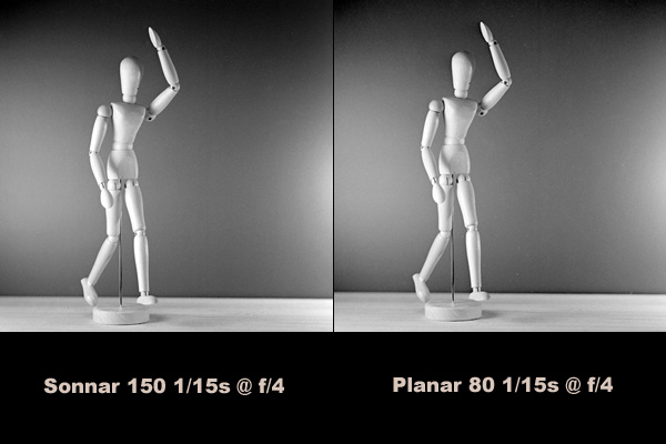

I've now developed another test roll. First I fired the shutter quite a few times, and then, in room temperature, exposed the roll at the following scheme:
Fr# Apt Time Lens
1 f/4 1/15s 150 Sonnar
2 f/4 1/8s 150 Sonnar
3 f/4 1/30s 150 Sonnar
4 f/11 1/2s 150 Sonnar
5 f/11 1/4s 150 Sonnar
6 f/11 1s 150 Sonnar
7 f/4 1/15s 80 Planar
8 f/4 1/8s 80 Planar
9 f/4 1/30s 80 Planar
10 f/11 1/2s 80 Planar
11 f/11 1/4s 80 Planar
12 f/11 1s 80 Planar
This time the exposures between the two lenses are identical. Some of it may have been evened out by the semi-stand development scheme, but there are still clear differences between the over- and under-exposed frames, so it would have been evident if there were any density differences to speak of.
So this means that the shutter mechanism fires well at room temperature. I'll be using it mostly in room temperature, or there about. I will still go ahead and get a CLA for it, but wonder if it's kosher to continue using it until I can afford it (my water heater busted the other night, and i had to spend $1,200 to replace it), as I don't dig into savings for photography stuff.
- Thomas
If it were still dragging at room temperature, I would say use it sparingly or not at all. But my gut tells me that if it was getting sluggish in the cold, there is old lube which is probably not doing what it should be doing at 100% even at room temperatures. I've heard of people putting a lens under a desk lamp for a couple of hours then working a sticky shutter or aperture until it freed up a bit; but I would not recommend that course of action.
There are two issues here. First, your lens seem to have had an issue with being stored without excersise, from which it seem to recover quite well. From your last post (Very early this morning, at least in Sweden. :smile: ) you don't mention if the 150 sounds like it's accurate on 1 sec, but from your report I can deduct it's about the same as your Planar.
Anyhow, it's quite obvious that the lubes have become stiffer over the years. Using the lens in freezing conditions will still put the mechanics under extra stress.
The second part is that the shutter have 2 different "clockworks". One part which is the one that usually needs attention is the slow times, from 1/15 to 1 sec. The second part with the faster times usually works fine even though the slower times have problems. So the faster times are probably OK.
//Björn
