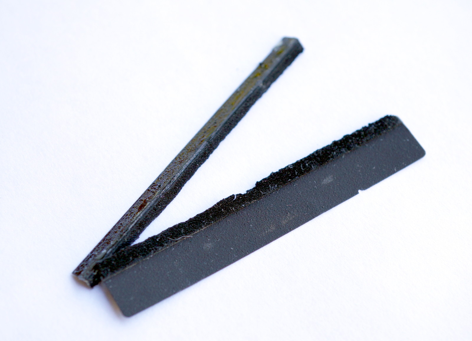

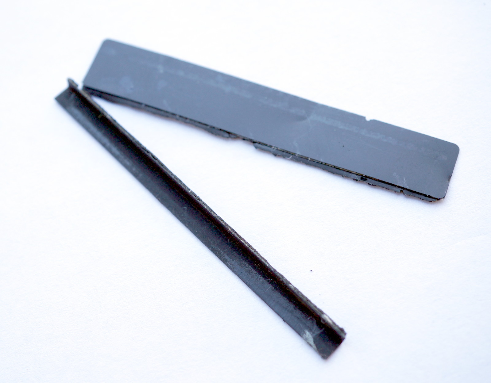

Now that we have our diagnosis, I hope this thread might be of use to others with the same problem. So I've attached a couple of pictures of the mirror light seal for future reference. I'm not sure if this light seal is specific to the 203 FE or if it also features in the rest of the V series. Thanks again everyone for all your help. Ultimately, I'll get the seal replaced by a Hasselblad technician.
Adam

For future reference, here is the complete (broken) part removed from the camera:
attachment.php
attachment.php
attachment.php

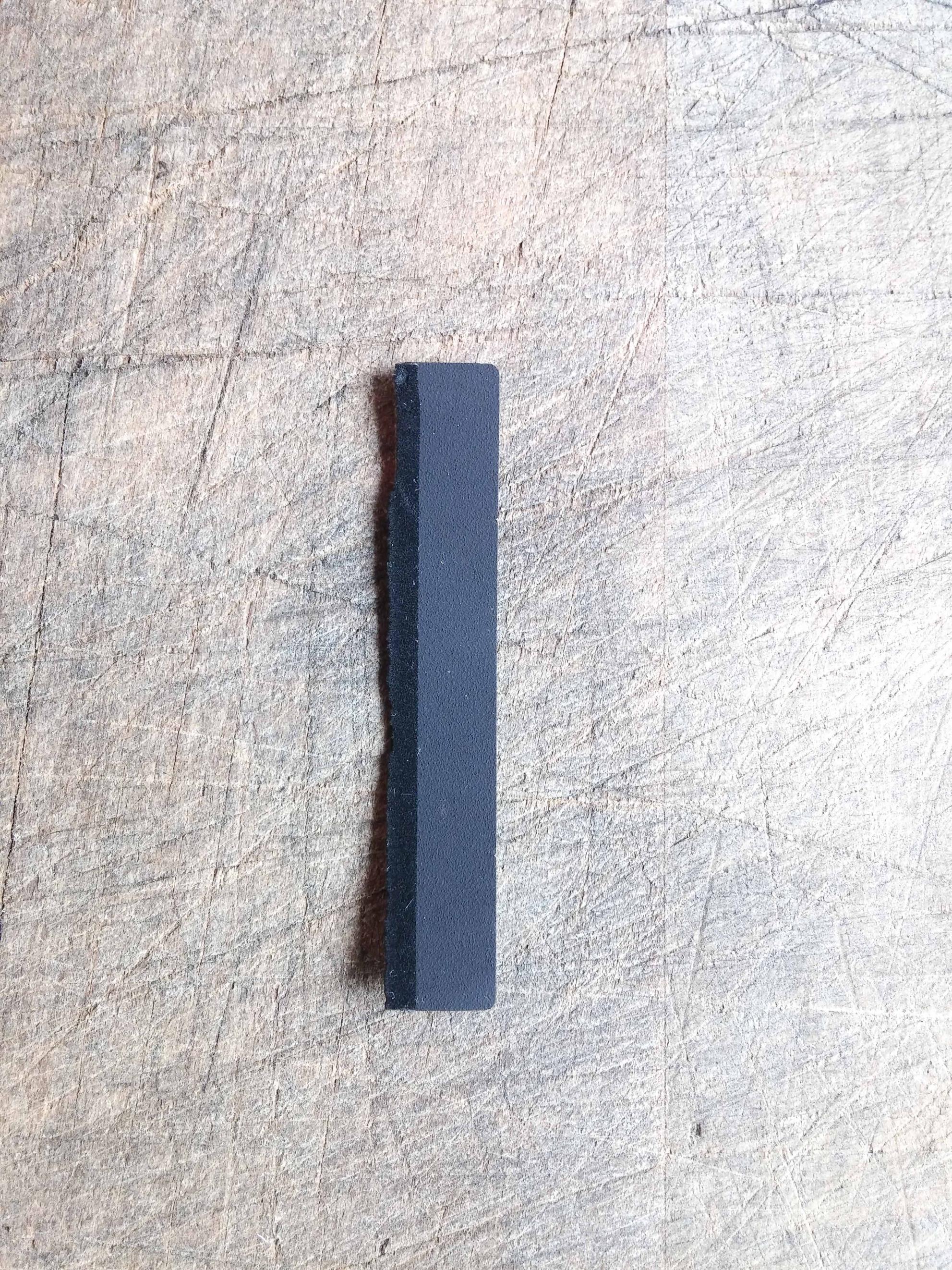

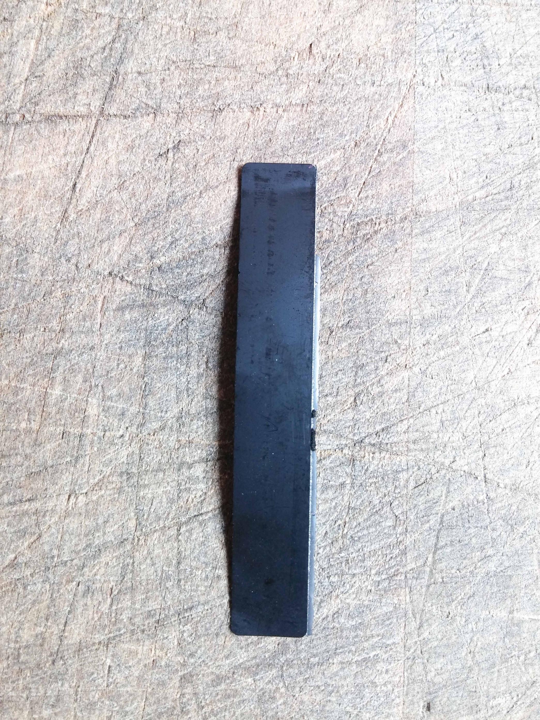

This is the last mirror baffle that I replaced (unfortunately I did not take a picture of the replacement before installing it).
The flap is flexible plastic.
The angled piece is metal, the rusty looking stains are the remains of the adhesive that attached it to the top of the shutter frame in the body.
A flexible foamy material attached the 2 pieces, which is what failed.
The new replacement one was more flexy (less stiff at the hinge) so it probably had the new shutter material as mentioned by Adam.

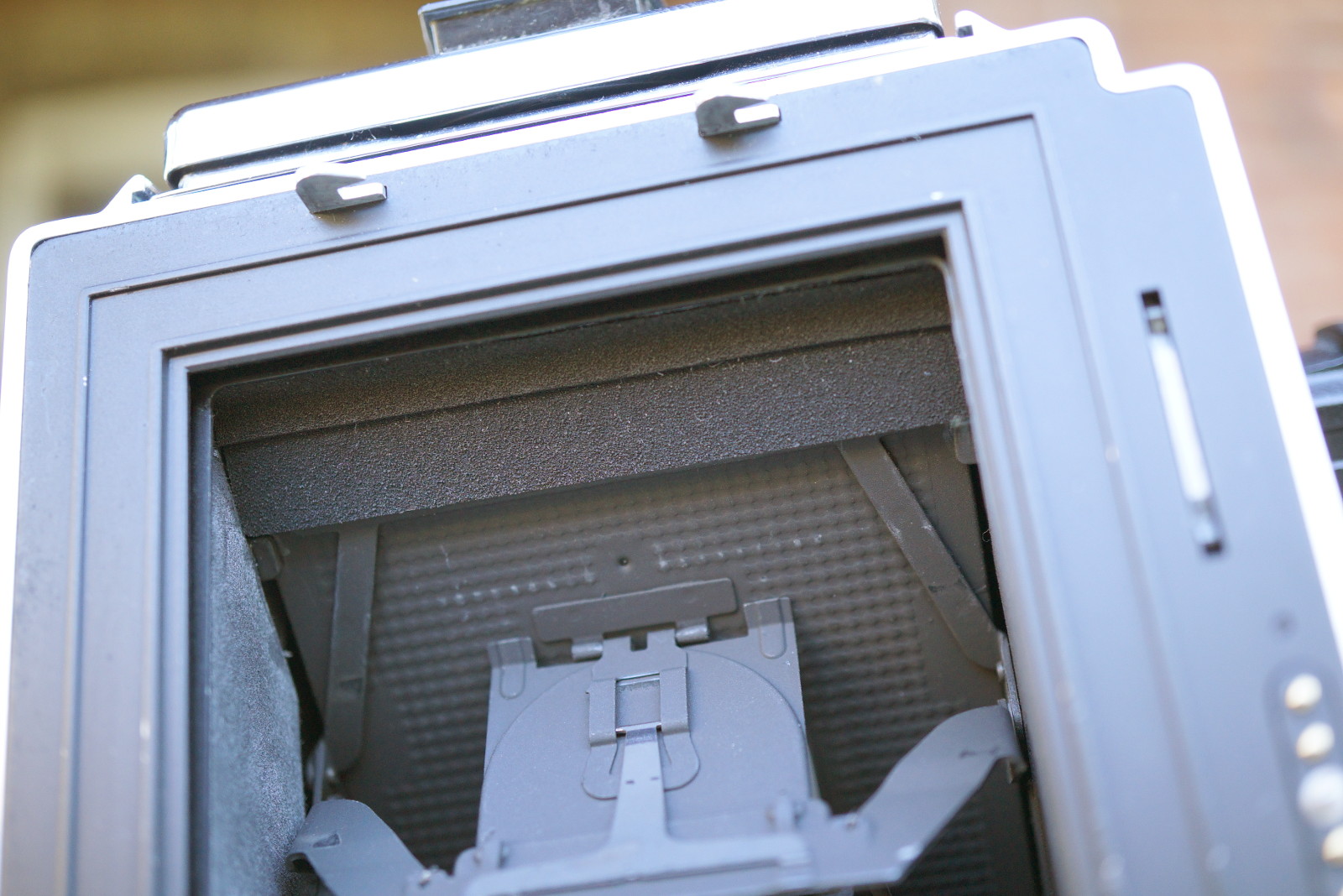

Here is how the light baffle looks when it is installed.

does the camera need to be dismantled to fit the replacement part, or do you insert the part through the back of the camera witht he shutter set to B?
I was able to install the new baffle without dismantling the mirror box. The shutter can be set to remain open by triggering the shutter and removing the battery as long as it is not in "C" mode. Cleaning the adhesive and aligning the new baffle is a little finicky this way, but doable.
