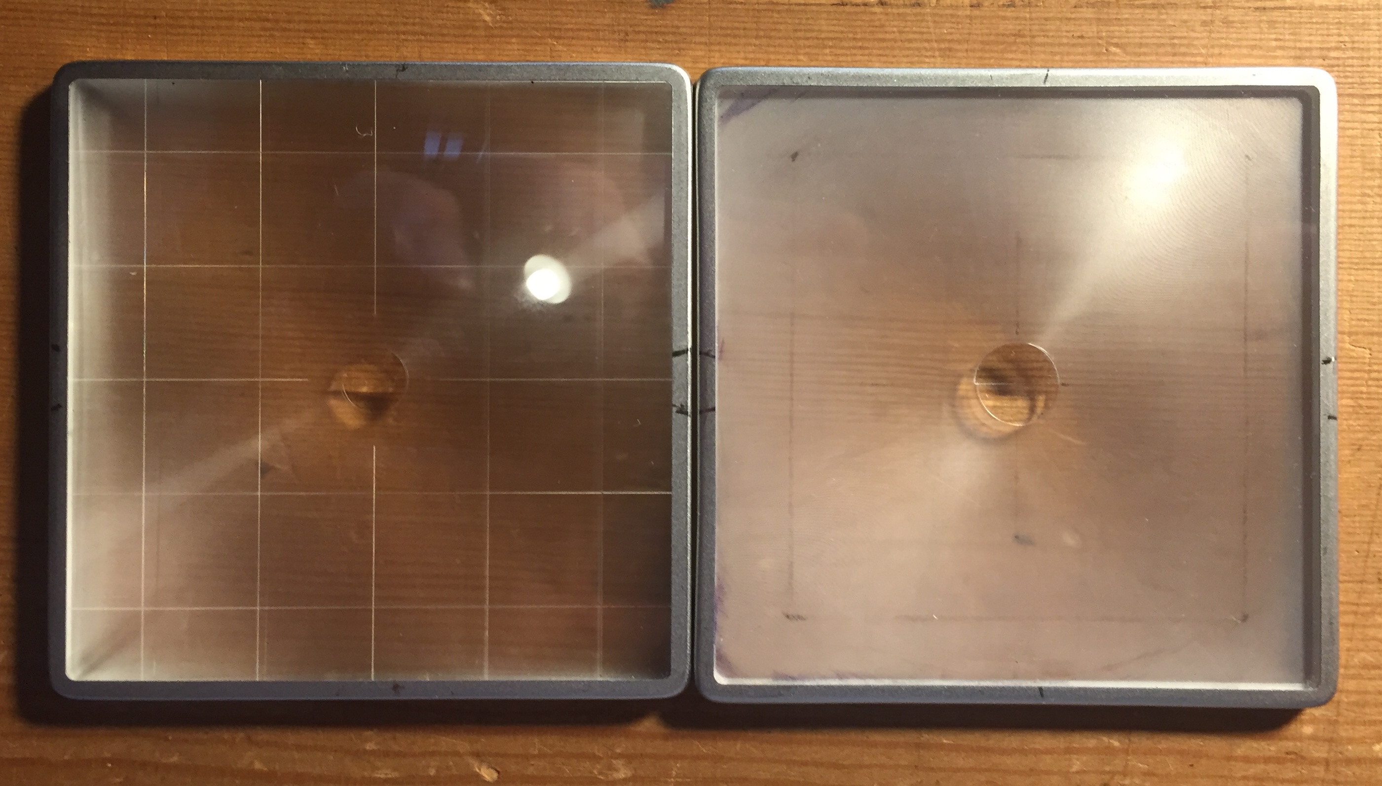

Left the Acute Matte and right the 'old' Ground Glass (with the DIY marks for super slide), both with a split screen.
The Acute Matte, a Minolta product, is clearly the clearest 😉 ( but absurdly expensive), although the split screen's diameter is somewhat smaler.
Hasselblad Acute Matte screens have a notch in the metal frame to indicate that, I don't see a notch on yours. It certainly looks like one though - if you hold it up to a distant point source light (ie: lamp on the other side of the room) you should see rainbow diffraction patterns from the Acute Matte prismatic surface.
if one looks through the Hasselblad literature, there is a part number associated with the various focusing screens. Are the screens themselves marked at all somewhere on the frame?
The notch is there to indicate that it is a 2nd generation Acute Matte, mine is a very 1st.
If the rainbow can't be seen here, is perhaps due to the hastily picture taken with a (simple-) iPhone?
But be reassured, it IS an Acute Matte (although not a 'D' which was a more recent version) at least it is what I payed for when it was marketed in the early 1990s...

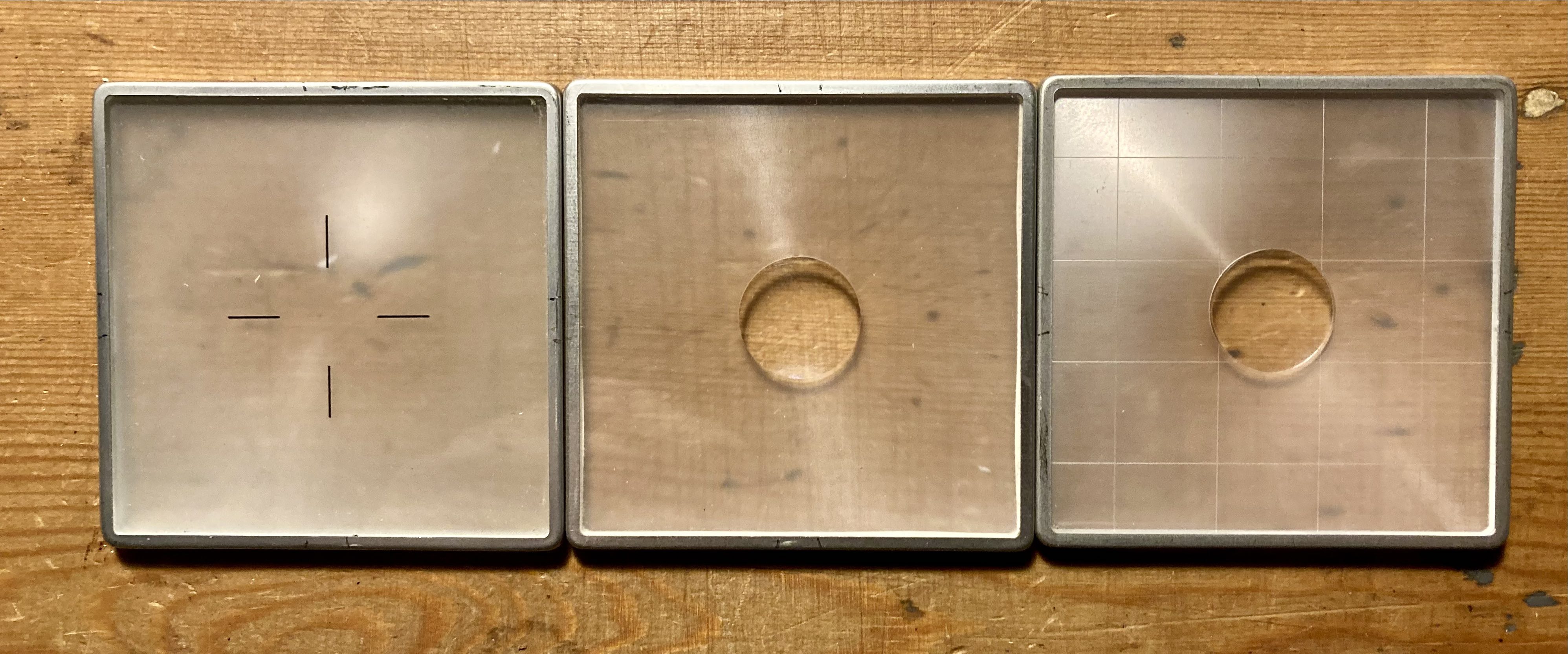

Here they are the more brighter non AM screens, compared to the old original one:
From left to right: standard, 42234, 42250.
