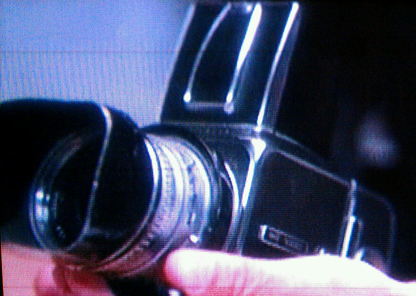

The latest trend seems to be men's clothing stores showing young men in suits carrying old film cameras. First it was Jos. A. Bank (Kodak Retina) and now Men's Wearhouse with a Hasselblad.
Here's a not so sharp photo of the advertisement on TV that I made with my phone. There is something wrong, as you can see. Rookie mistake.

hahahahaha the forgot to pull the dark slide trick.

For those of us who are unfamiliar with Hasselblalds, please explain the mistake shown in the photo.
goros
Jun 6, 2006
279
The Basque C
The guy in the picture is taking a picture with the dark slide in place. More or less as trying to take a picture with a rangefinder and the lens cap in place.
The Hasselblad allows interchangeable backs and the dark slide is used to protect the film when the back is removed. There are interlocks so that the shutter won't release unless the dark slide is removed and also the back can't be removed unless the dark slide is inserted.
Some people carry multiple backs because they want to have different film types in each back, others might have the same film type in each back, but have one back for low contrast scenes, one for normal, and one for high - this allows the film from each back to be developed according to its contrast. That would not be possible if there were a mix of contrasts on a single roll.
I just have two backs loaded so that I can shoot 24 pictures in succession without having to reload. Especially in the field I like to avoid the hassle of changing films (pun intended)
