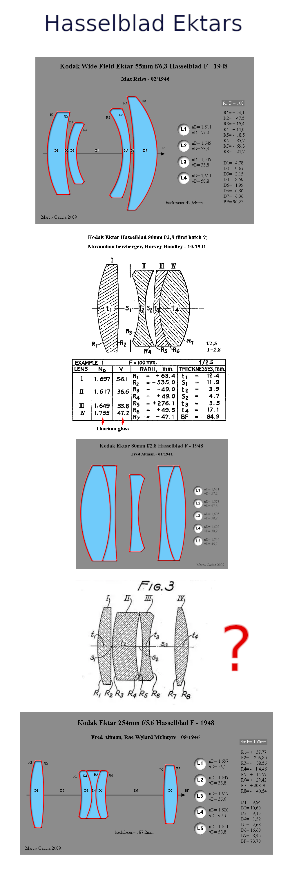

Digging through my archives, I've created this...
There is a "?" on fig-3 because Kodak's patent by Fred Altman showed 3 variation for the 3.5/135, so I just picked one. They were all 4/4 construction, but the double concave element was in either the 2nd or 3rd position.

Thanks for posting that. If I'm reading everything correctly, there should be at least three versions of the 80/2.8 Ektar. The early/prototype (an unusual Tessar design with the second element behind the aperture), then a Heliar, and then a more traditional Tessar.

No, the 1st Ektar 2.8/80 was the 4/3 thorium oxide doped expensive design, the second was the 5/3 design. There was no 3rd, as they switched to Zeiss.
Some Leitz Hektors use the 1-3-1 arrangement.
The only problem with that is I'm holding a 1949 80/2.8 Ektar which very much appears to be 1-1-2, 4/3, but not in the configuration of that 1941 Ektar diagram shown above.
The only problem with that is I'm holding a 1949 80/2.8 Ektar which very much appears to be 1-1-2, 4/3, but not in the configuration of that early Ektar diagram shown above.
