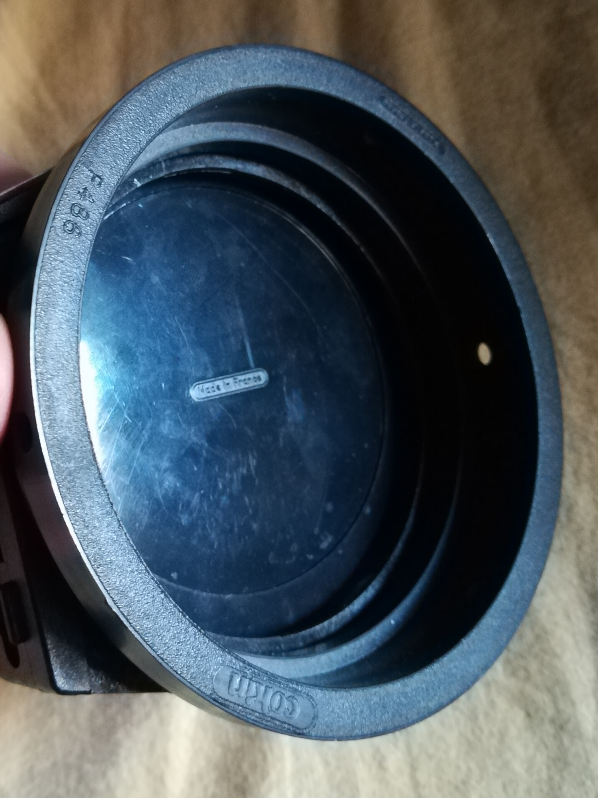

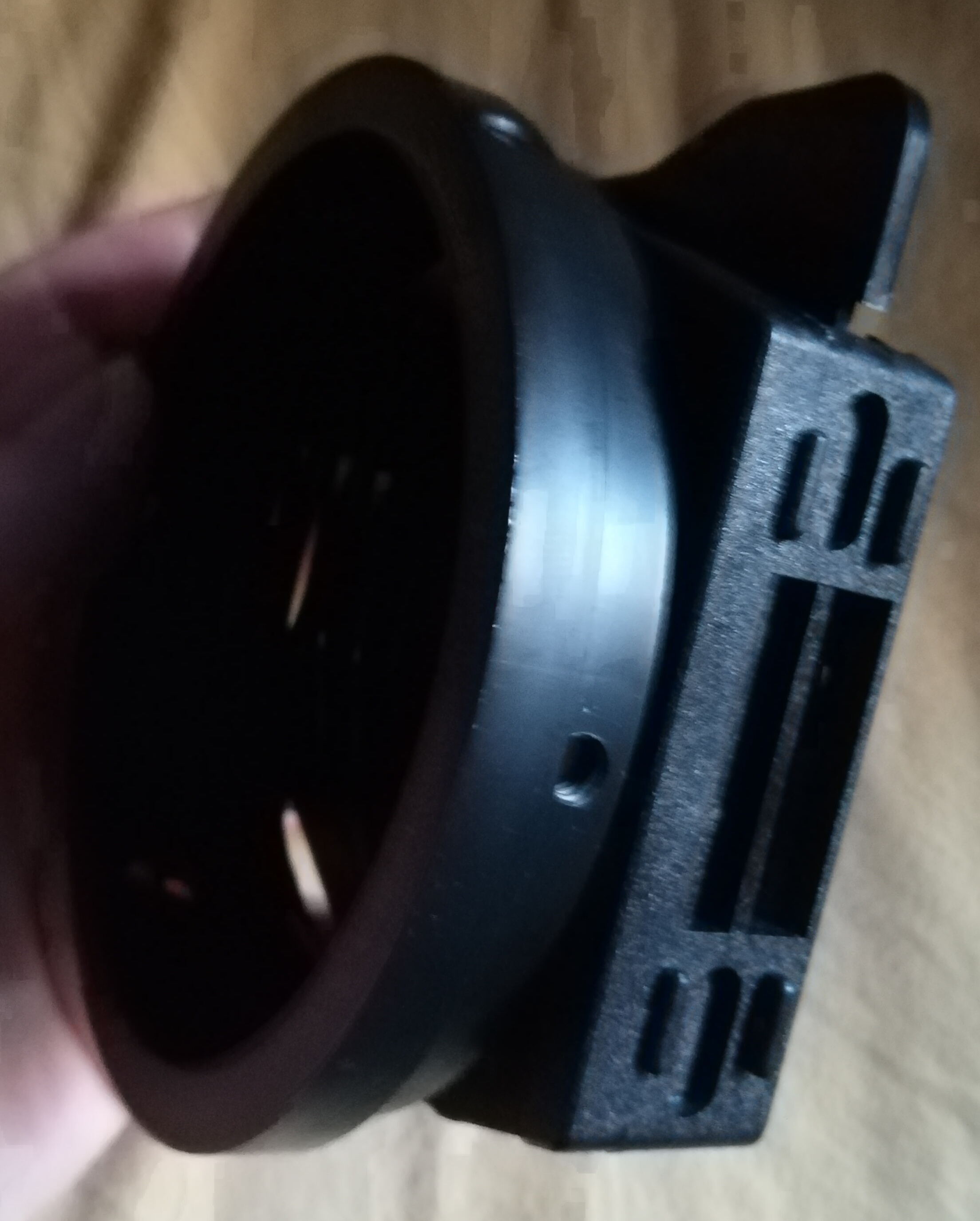

Hello guys, I received as a gift from an old photographer a Cokin plate (or gelatin?) filters holder that has been used on a Hasselblad. In these pictures you can see what I have.
Do you know how can I use that on my Hasselblad? Which filters does it need?
Thanks you all in advance.
https://www.cokin-filters.com/creative/rings/
A three part system: Adapter to fit lens, filter holder, filter.
Your adapter looks like the universal P499/P486 but seems to be missing the screws to attach to the lens.
Lots of filters and bits on the auction site.
Thank you, Chris, as always clear and kind.
For now I'll buy a Cokin P ∅52 ring and I'll use it on a b50-52 adapter ring, that's the best deal.
I'd like to experiment with filters, that's an unknown world for me and sometimes I feel like I want something more from my negatives.
As I saw I guess those filters are still widely available, right?
Thanks again
Francesco

Neutral grads if shooting colour will make the biggest difference, if shooting landscape type stuff, obviously yellow etc in B/W, just not super easy with that set up hand held I found, I have used the Pro-Hood which takes the "sheet" filters.
Ahahahah that's true!
You know, I'm sure it won't be that comfortable to use, but it will be so for my wallet. A complete set of b50 filters probably will cost me as much as a three lenses set, I don't know if someone made unofficial filters for that mount but I know for sure that the official ones are super expensive. I mainly work on tripods so it won't be that bad.
