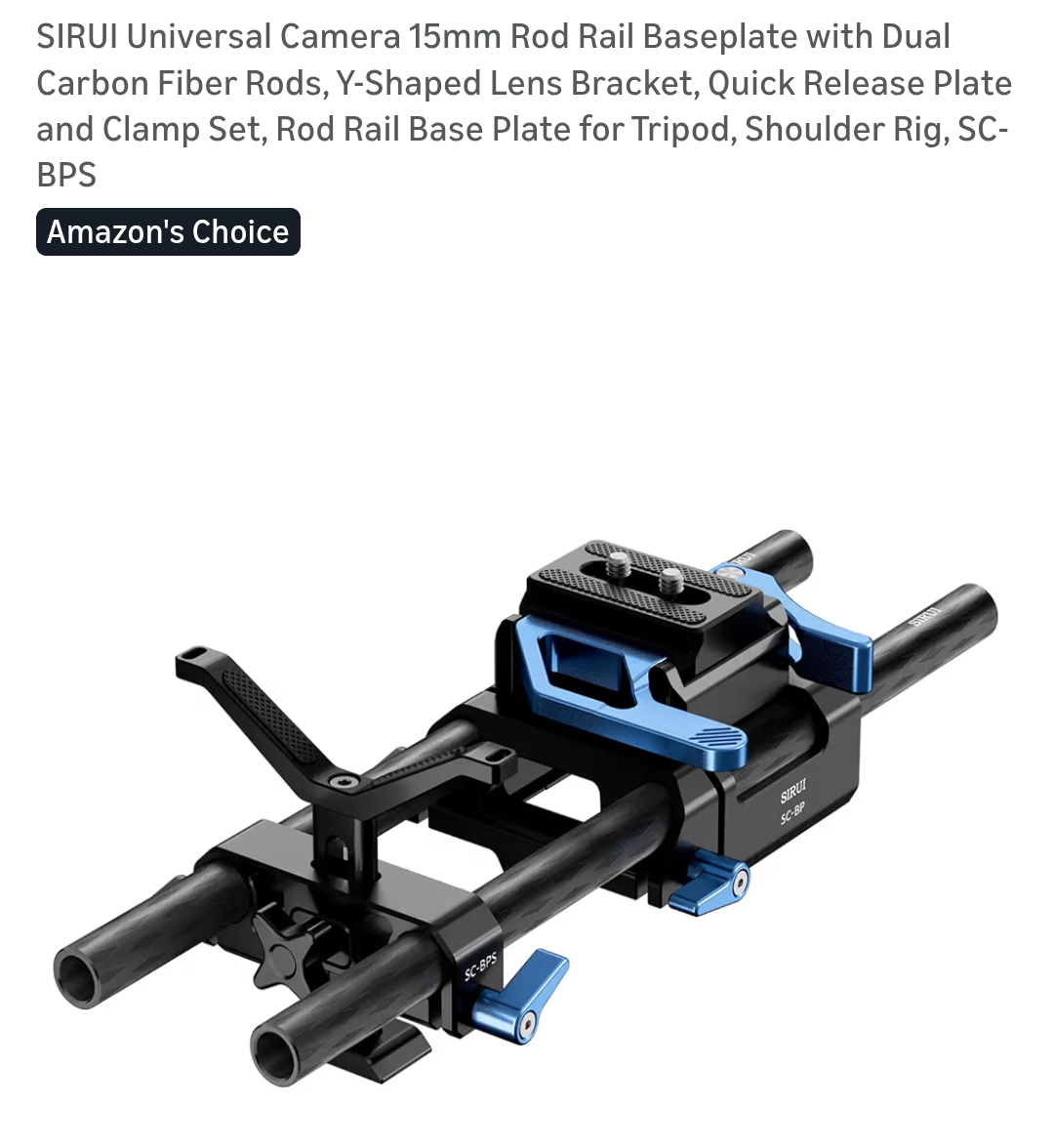

Also one possible solution for long lens support, if the lens does not have tripod socket itself
