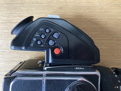

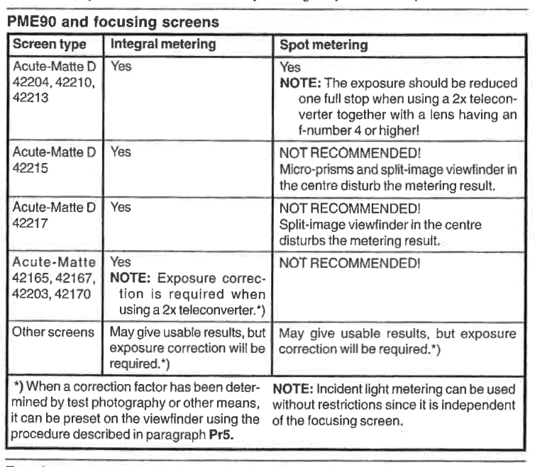

While it adds weight and you might think that it is ugly, I always use the 45° PME prism. My only problem with it is that it cannot be adjusted for the Accumat D screens and I have to set the light meter to half the ISO to read correctly. That was the best that Hasselblad New Jersey could do during recalibration. I talked to my Hasselblad repairman and the said the later metered prisms were so complicated that he has trouble using them and I should stick with the PME. That said, which I just did, the 45° PME gets rid of the left-right reversal, and is easy to use with eye glasses or contact lenses.
Strange that you cannot get a precise exposure with the prism. Are we both talking about this one? Which focusing screen are you using?
I could not find a manual on internet, and (obviously) I could not find the paper copy I had... but the PME90 manual (available on HasselbladHistorical) should apply.
For the record, I used a 42215 screen and recently moved to the 3042264 (for the digital back) - both have micro-prism + split image.
I have always had precise exposures, using spot about 1/3rd of the time and integral meter 2/3rds of the time. (Incident meter is too cumbersome, when I need this I grab my handheld meter).

In my case the prism did not require any re-calibration. (The previous owner might have done it, I do not know.)
If it helps, you can also program a permanent exposure correction into the meter.
EDIT: I assume that the max aperture of your lens is set correctly?
Hope this helps :smile:
I have this one
and it reads accurately. It does not replace the spot meter nor the incident meter when those are needed.
