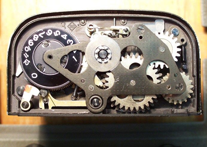

I also had a back with this problem and opened it up to have a look. The adjustment is via the three locking screws visible on the counter wheel in the attached picture. This was some time ago, but I seem to remember that a locking pawl (just visible near the "1" I think) falls into the cutout visible near the "7" to stop at the first frame. This needs to happen at exactly the same time as another pawl reaches the first frame position on the wheel which has cutouts for each exposure (sorry, I don't know the proper names). Anyhoo, if these two are out of synch, the first frame may overlap the second.
Thanks Gary.
Yep, loosen screws and turn the wheel to the right position, then tighten. The other wheel with the cutouts for each exposure is on the same shaft but underneath the counter wheel (as I recall - this is streching the memory). A pretty easy fix really. I contacted David Odess to confirm that I was on the right track before I made the adjustment. He was kind enough to reply and confirm that I had the right idea.
You can feed a sacrificial roll through the back and mark the position of the first two exposures with a pencil to check the spacing. This is a bit tedious with all of the interlocks, removing the darkslide, etc, but worth it to know that you've got the adjustment correct.
A note of caution - if you remove the black frame that's on top of all of the gears then things can go SPROING! Don't ask me how I know... although I did get it all back together.

Thanks for the input and the photo. How about some general information on how to gain access? I am looking at the back and don't see a way in except for removing the screws on the frame surrounding the dark slide. Is this the proper route?
I've got the later version, A12-6x6, with the dark slide storage feature on the rear of the back.
-Fred
You have to peel off the leatherette covering on the end with the wind crank. The screws are underneath.

Wayno,
That was pretty simple to repair. Thanks for the help.
-Fred
