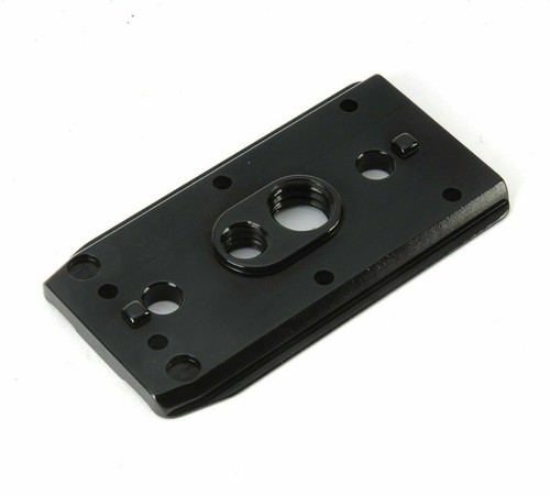

I think it would do the job, but there is very scarce information on that listing...
That does not look like an Arc Swiss compatible foot, it looks like one for the Hasselblad QR system.
The Markins part # you are looking for is P60H (as shown here: https://www.getdpi.com/forum/index.php?threads/hasselblad-v-series-tripod-plate.64551/post-765654)

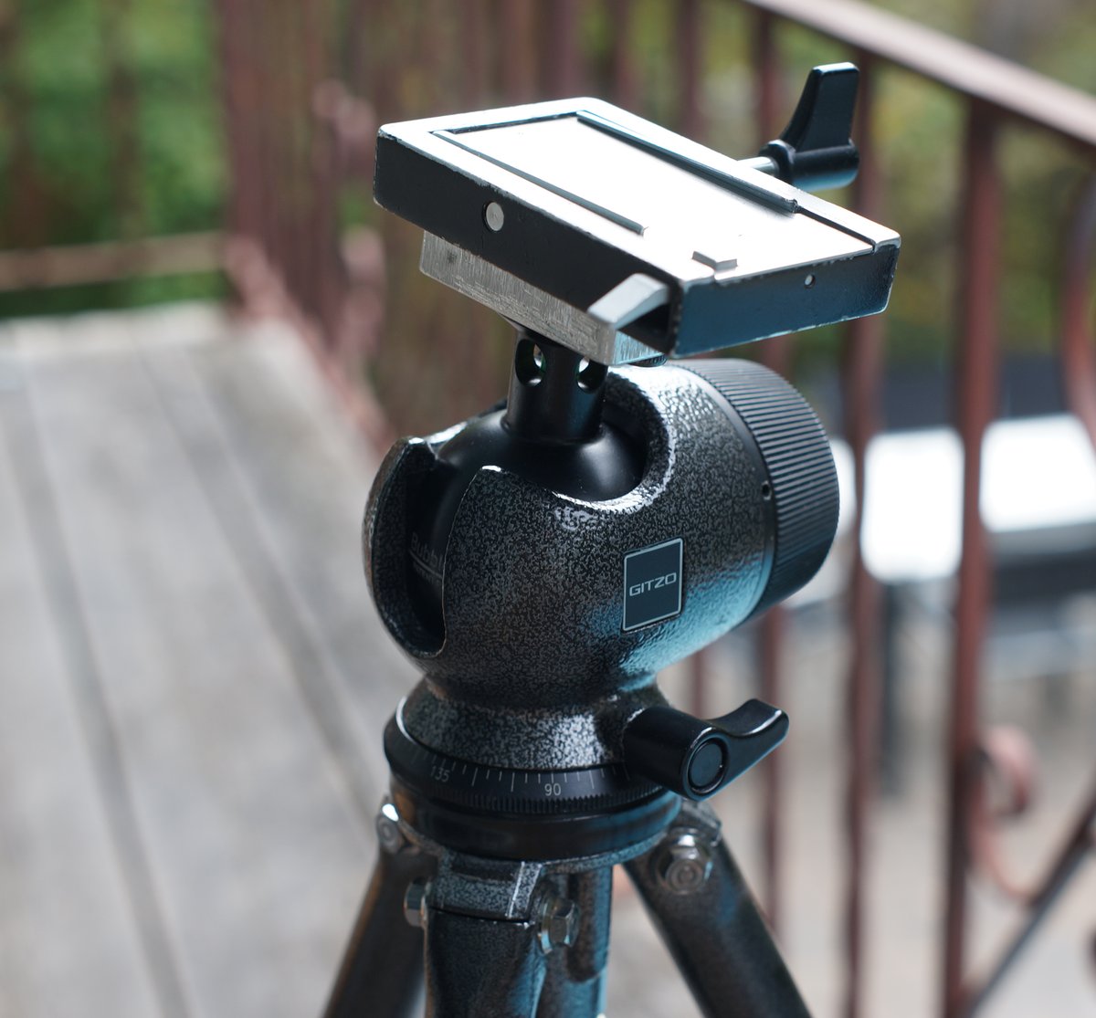

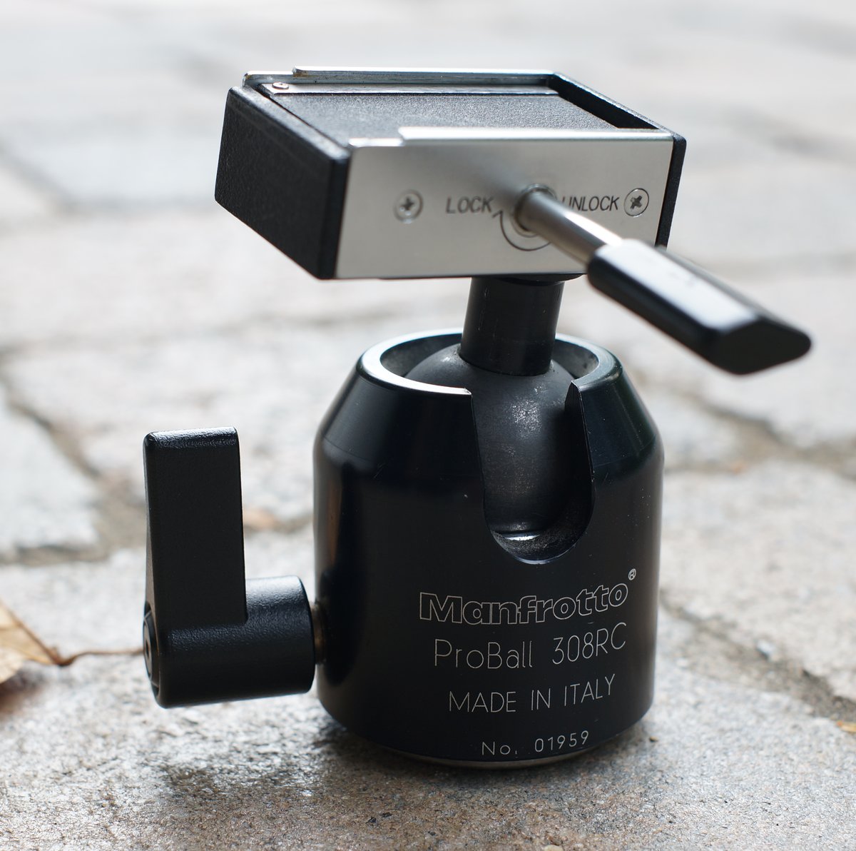

I've gone as far as replacing the ball head QR with the Hasselblad one for compactness:
Hasselblad QR attached to a Gitzo 2780 with a prototype (hack) plate
An old Manfrotto ProBall with a Mamiya made Hasselblad QR unit replacing the 1/4" screw mount.
You can just get the QR adapter unit for the hasselblad foot and attach it to your existing Triopd to see if you like it.
Or... you can pick up a Hasselblad QR unit for one of your ball heads, I find they work well and preserve the compactness and hand hold-ability of the body.

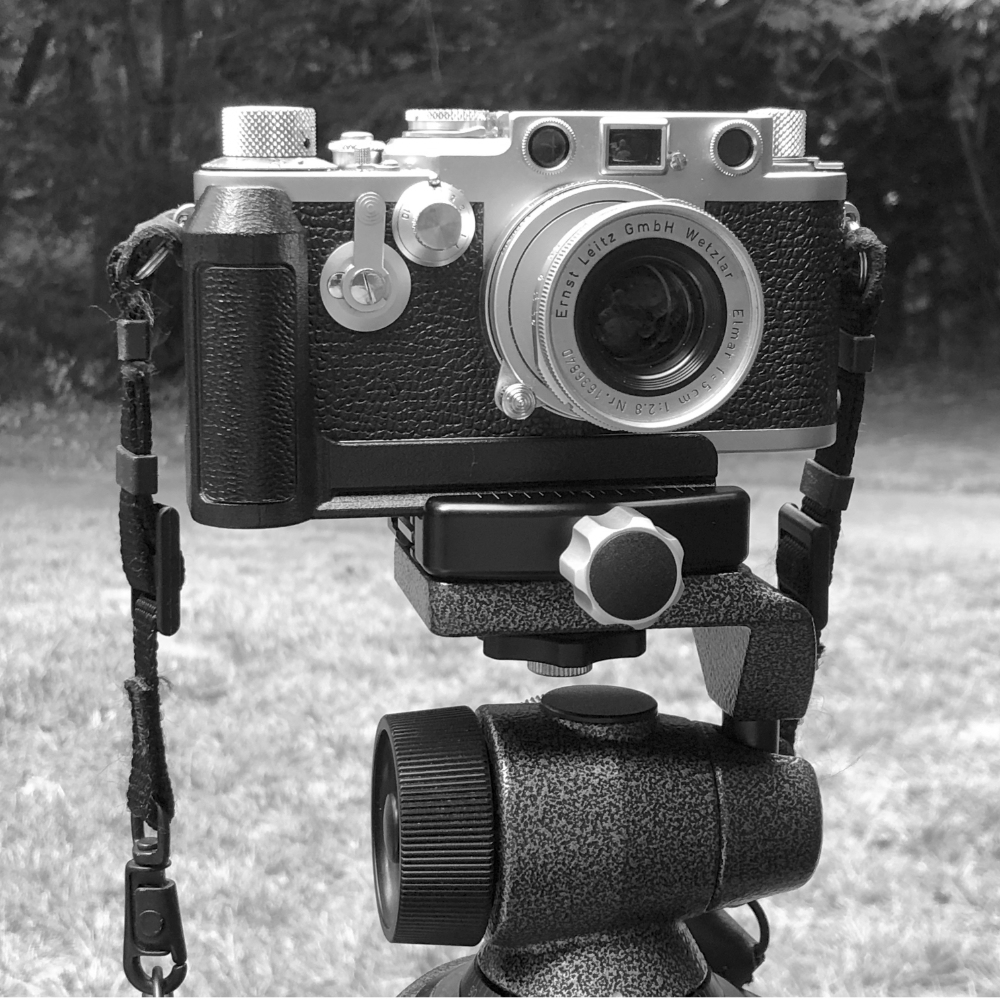

I use a Gitzo GH2750 Series 2 head for all of my cameras. For my Hasselblad 500C/M I attach an OEM Hasselblad QR to the Gitzo head.
For my Nikons or Leicas I put an Arca-Swiss compatible grip or L-bracket on the camera and attach a Kirk QR to the Gitzo head.
And for my 3.5MX-EVS Rolleiflex I attach a Rolleifix QR to the Gitzo head (no photo but you get the idea).
It takes me about 15 seconds to swap QR's on the head.
