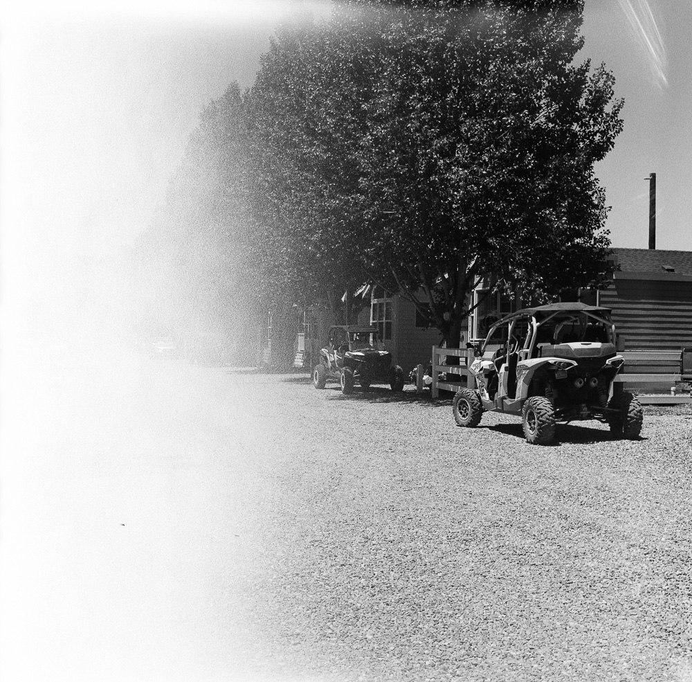

Put a test roll through my recently acquired H501c. The images have a larger light leak from the left. See attached.
The processor said he thought it was a shutter problem, but that didn't make sense to me. Any ideas?

Remember that the image is upside down in the camera. So a light leak on the left side of the image landed on the right side of the film back. The light came through a bad light seal on the left side of the camera body. Replace the film back light shield. I have serious concerns about your processor blaming a lens shutter.

Which frame # was that?
Seen on 1 frame or all?
Without complete information about the fault it’s hard to say for sure but I’d bet on shutterfinger’s suggestion over that of your processor.

All images look like this. 2 might be a little less flared, but still consistent with this one.

The processor was just talking on a phone message. He doesn't even know what camera that were shot with. I figured his comment was inconsequential.

Light seals on your back. Easy and inexpensive repair.

Thanks. I'll try the light seals and maybe it is a simple fix in spite of how nasty the effect looks! As I said....my first roll through a spendy camera. I think out of the dozens of cameras I've bought used, this is the most dramatic cockup I've ever had on first roll. I won't panic yet.

Report:
I bought the A12 light trap kit on Ebay for $13. It arrived today and I installed it. The instructions were good, clear, and there were good photos. The materials consist of a sliver of die cut mylar with a crease, and a sliver of gray foam to go in the crease. About 5-cents worth of materials, but I am sure the die to cut the mylar was a few hundred dollars. So, price was fair enough. Indeed the old trap was fully rotted away. The NINE tiny screws had me a little worried and sure enough one was frozen. Always happens, doesn't it? I carefully worked the stuck screw with some added leverage and thankfully it loosened.
I went right out and shot a roll and sent it off. Hopefully, this will fix the light leak. We'll see. The dark slide did feel tighter going in, so....
In the future, now that I see what the deal is, I will make my own, and save the $13. The nice die-cut mylar isn't going to wear out, just the sliver of gray foam will rot away.

Your processor said that because that’s similar to what shutter capping would look like with a focal plane shutter.
