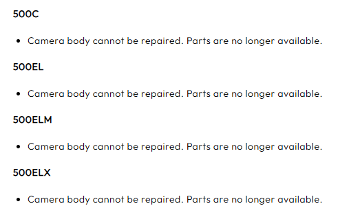

Based on what? Did you check with Hasselblad USA before you wrote this?
From the link BrianShaw posted in #23 above.
Also important might be what's not listed as it implies that they are still servicable by Hasselblad. A call or email might be more definitive on those products. Perhaps Pieter has already done that???

Hasselblad will not accept a camera for service if they don't have the parts to repair it. Since they don't know what it might need, they take the safe route of just not accepting those cameras.
