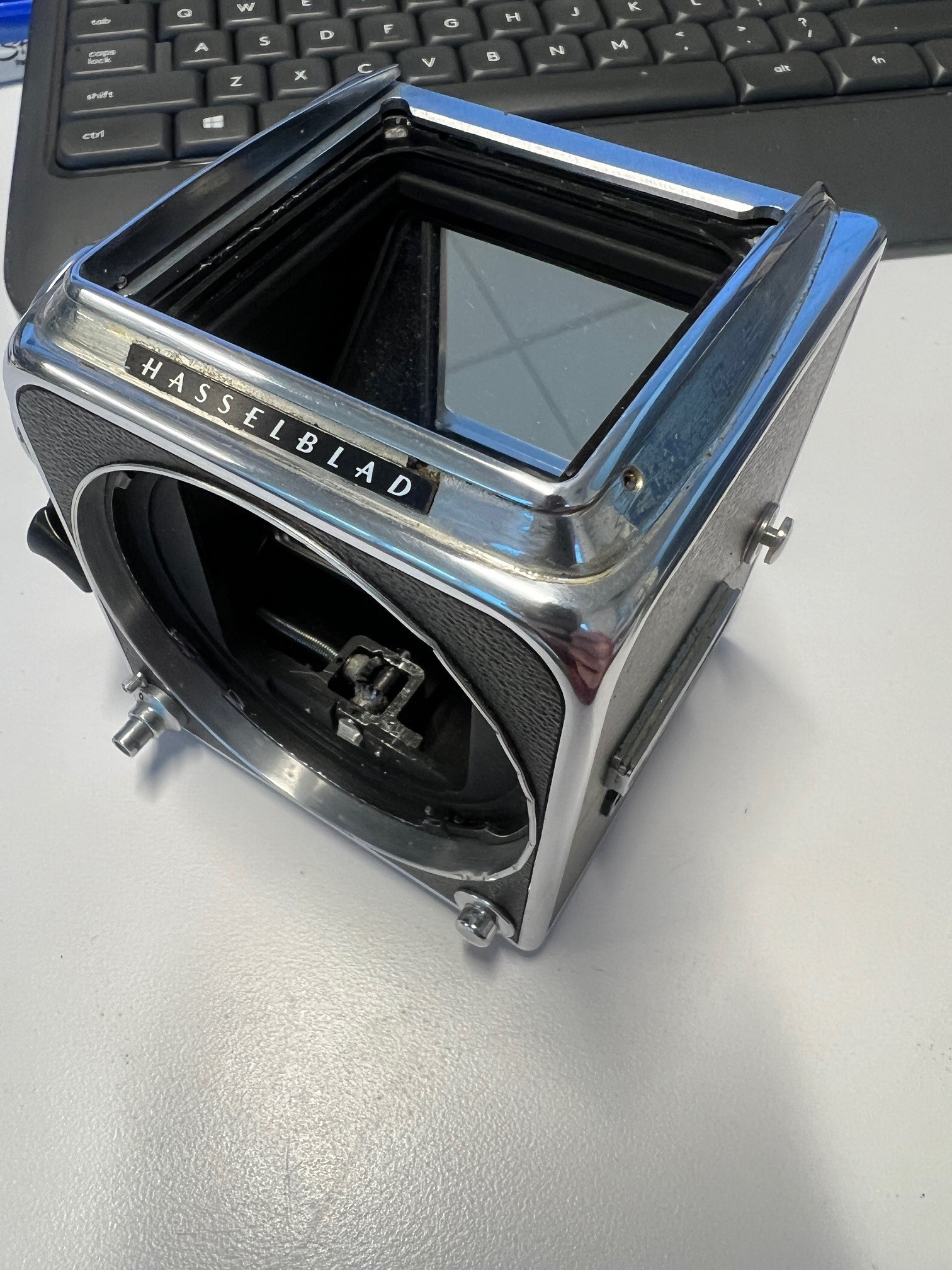

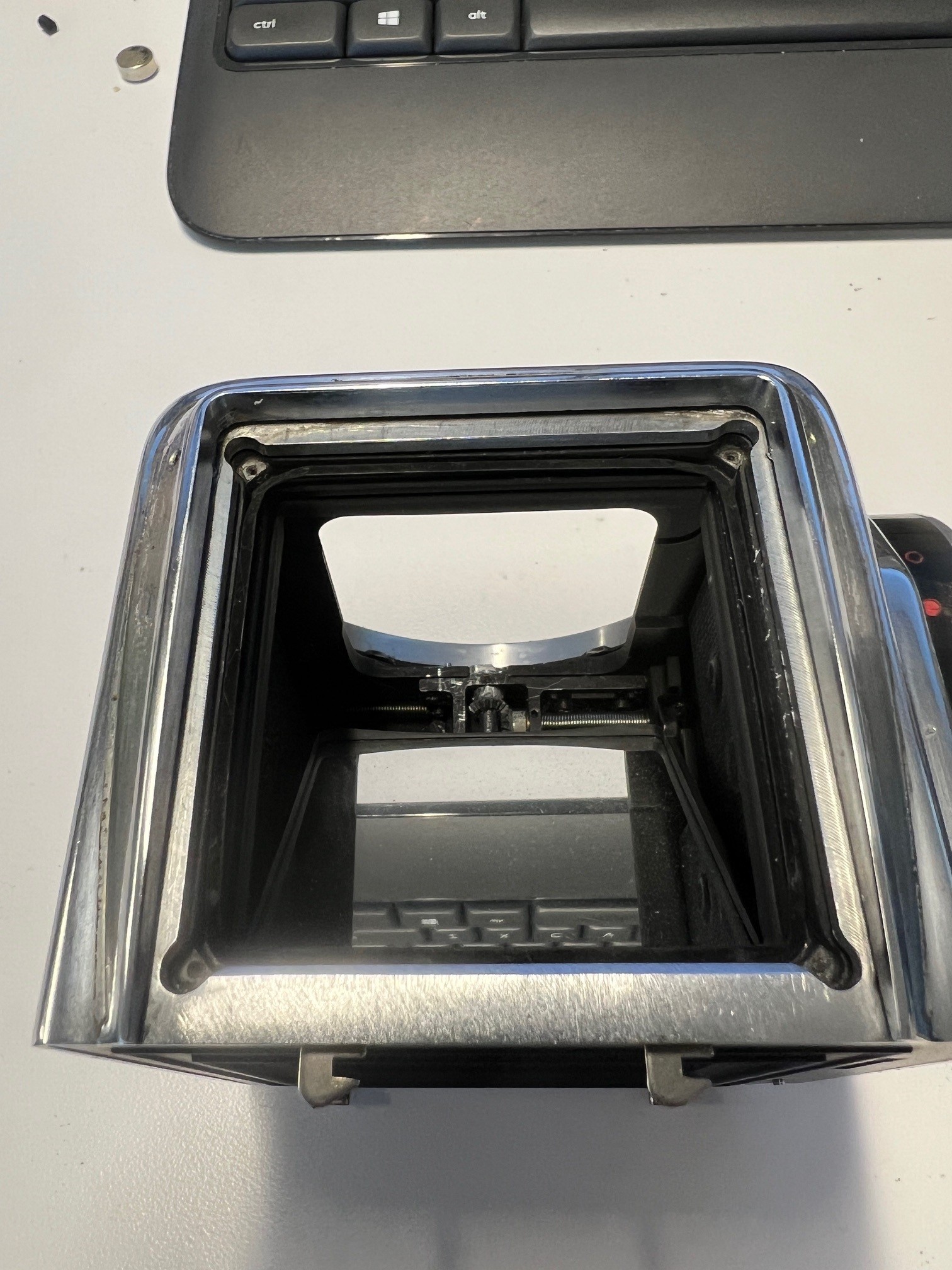

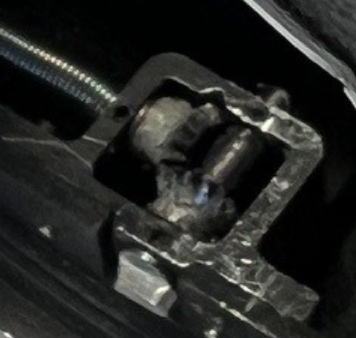

I recently picked up a Hasselblad 500C body in a trade, but it arrived without its ground glass focusing screen. Thankfully, the spring that holds the screen in place is still intact.
View attachment 411470 View attachment 411469
For those familiar with this model, I have a few questions:
  • What’s the best source for a replacement screen for the 500C?
  • Did these originally use only ground glass, or was there also a separate Fresnel?
  • Am I missing any other parts that secure the focusing screen?
  • Does anyone know the correct screw size used to hold the glass in?
  • Has anyone made their own ground glass for this camera—does it work well?
  • Alternatively, could a 500C/M screen be modified by removing the metal frame?

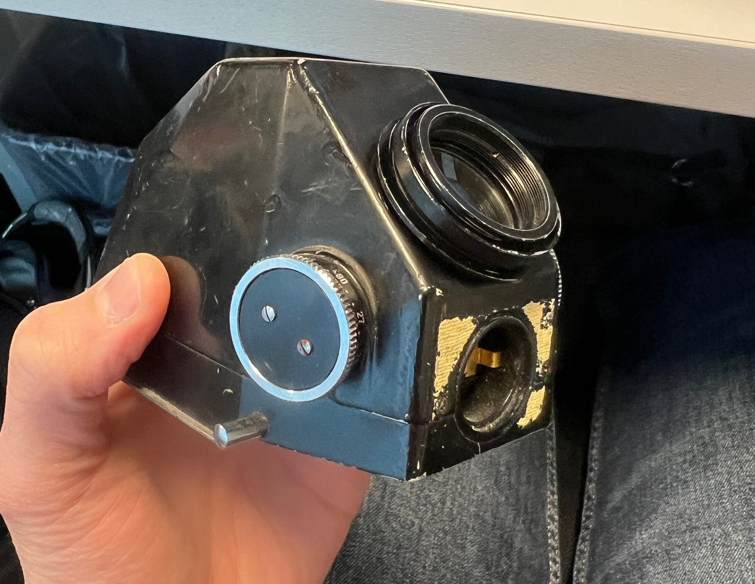

The camera also came with a 45° metered prism, but it’s missing the battery cover. If anyone knows where to find a replacement, I’d appreciate it—otherwise I may just design and 3D-print one.
Lastly, I’m torn on whether to keep this camera or sell it to help fund a Toyo 45AII or Bronica RF645. I’ve never owned a Hasselblad before, though I’ve shot plenty of medium format. Since I still need to pick up a lens for this body, I’m debating whether it’s worth the investment. If anyone has thoughts on choosing between keeping the 500C or putting the money toward the Toyo/Bronica, I’d love to hear them. For reference, I currently use a Mamiya C330 for 6x6, and a Bronica GS-1 for 6x7.

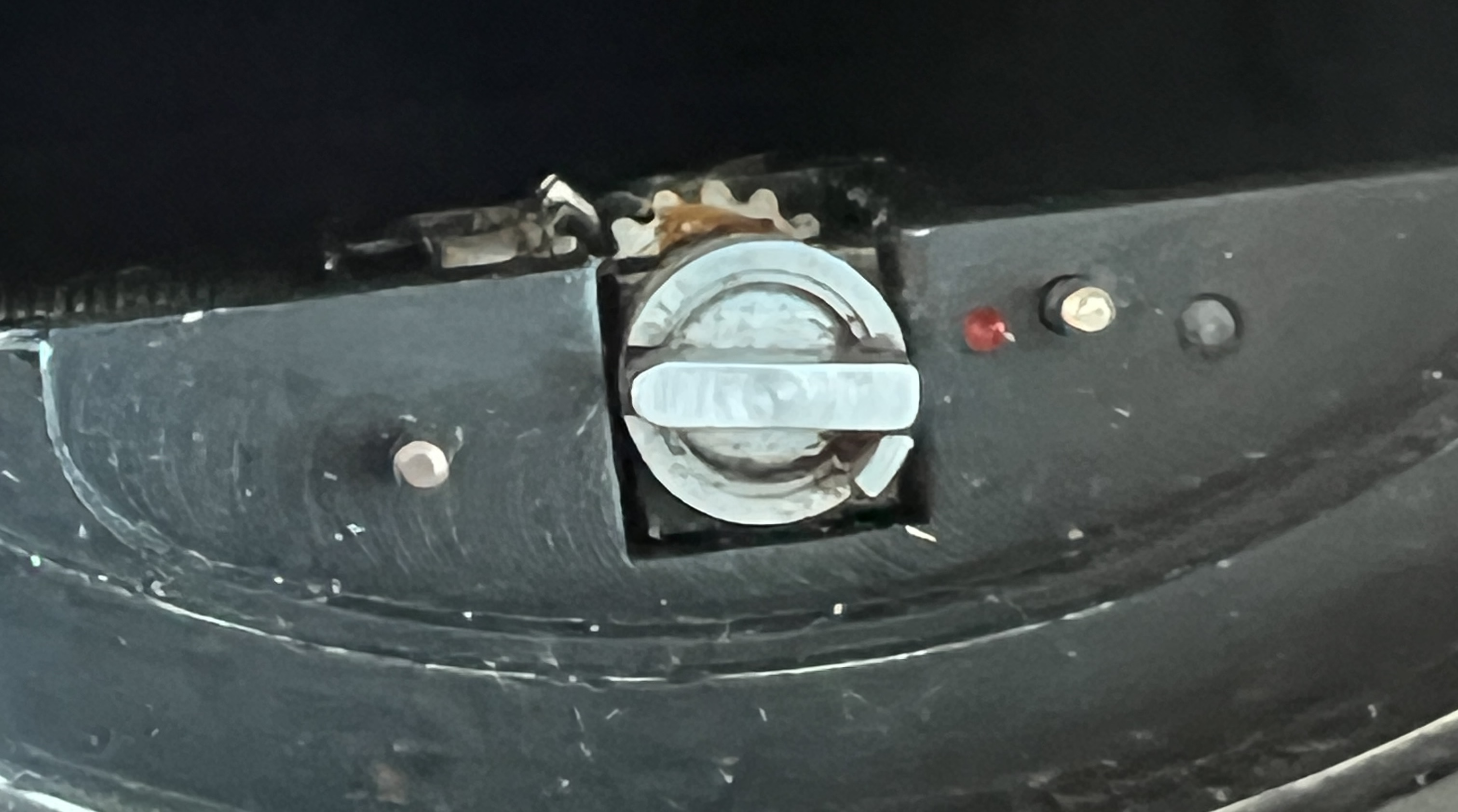

I purchased a 250mm lens and it’s works great! However, it has shown that there is some more gremlins in the camera body:
This first image shows the shutter key on my camera body. The second image shows the shutter key on a different body. It appears that mine has a broken key, and is also missing that other part underneath the key that has the tab. My camera body will not fire the lens, it gets locked up. What is the function of the part with the tab under the key?
Is this pin supposed to move in and out to fire the shutter? This is stationary when firing my camera body without a lens.
Still working through the ground glass projects as well.
Your lens is fired when the pin is moved by the matching pin in the camera. The tab underneath the winding key doesn't really matter - it not being there shouldn't prevent your lens from firing. Your camera's pin, however, looks chewed up. That might be the reason.

Hey Everyone!
Just wanted to throw an update out there for this project. I think I will be eventually selling this as a parts camera.

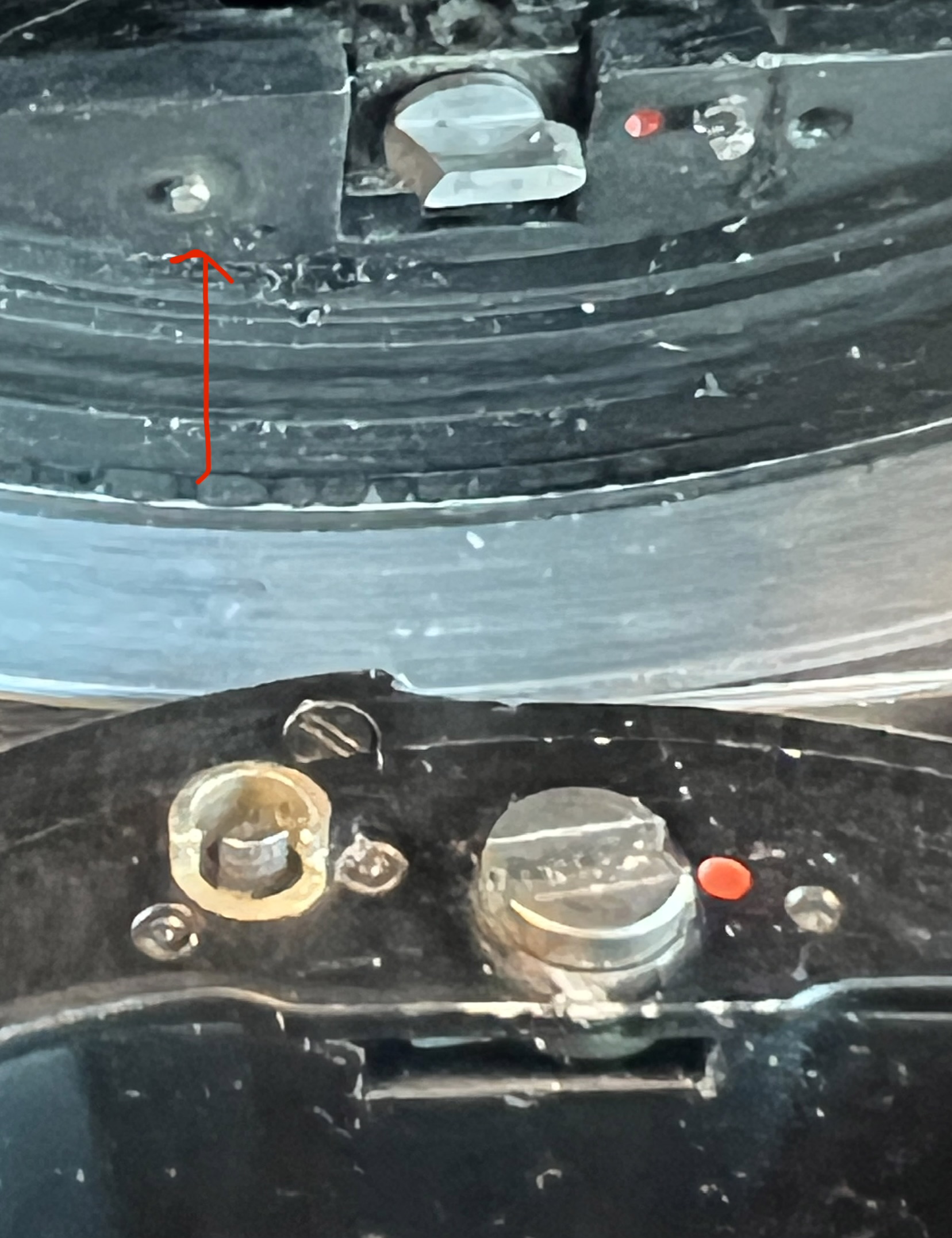

This is what the cocking lever should look like:
THis is what the one on my camera looks like:
The cocking lever is broken, and is missing a silver ring with a tab that goes around the lever. I received a camera body yesterday with a jammed lens, and after I took it off the cocking lever looked like mine. After fixing the lens, I put the lens on the body to test it, but the broken cocking lever would not cock the shutter.
That being said, this body is now a Junker unless I can find a replacement cocking lever. Just wanted to post this to wrap up the thread, and give a word of caution to others. Thanks for following along everyone!
