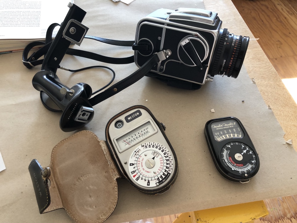

Hello folks,
I'm new to the group and have very simple questions about this very complicated camera I purchased used several years ago and now interested in learning how to use. I am exploring a digital back option.
How do I identify the model of the Hasselblad camera I own? Two serial numbers on the body and back are:
UT 500705 Back
UT 185329 Body
I understand the date of manufacture is 1976. Would this be a 500-C model? Where do I go from here?
Thanks for all your input!
K

Welcome to the Hasselblad world. All good advice above. The light meters shown in your photo concern me. I would check them against a modern Sekonic light meter to see if they are still are accurate.
Your body & back are from 1976. Here's the code to date Hasselblad cameras:

1976 serial number range means your Hasselblad body model is 500cm (the 500c was discontinued around 1970, the last batch were actually early 500cms). Yours looks like it may have all been sold together originally as a complete camera kit: the waist level finder is matching '76 vintage, as are the A12 back and lens. The chromed fold out winding crank was an optional upgrade: in 1976 all 500cm bodies were originally equipped with a simple black winding knob.
The Hasselblad 500cm is a legendary classic camera of supreme quality, but as others have suggested you should check it out very carefully with and without film before attempting to shoot anything important. The one big "gotcha" with Hasselblad (that tends to get swept under the rug beneath all the praise) is they absolutely, positively *hate* to sit unused for any length of time. While this is true to a certain degree with every mechanical camera system, Hasselblad takes it to next-level spitefulness sometimes: if they sit idle for several years, anything and everything can get gummed up (esp the lens shutters). So do heed the suggestions above to test and exercise all the shutter speeds and apertures while looking thru the rear of the camera with the film back removed: if anything is amiss, you'll need to have it serviced again (even though you already did this back in 2011).
Pay particular attention to the small apertures like f/22: they should stop down instantly at slower shutter speeds like 1/4 sec (any sluggishness or drag will cause overexposure at faster speeds). Also keep an eye on the rear flaps: they should snap open and closed smartly, edges flush with no gaps. Note the flaps are controlled by the shutter button: get in the habit of keeping the shutter release pressed until you know the lens shutter has closed (if you let go too soon the flaps will cover the film before the lens shutter finishes the exposure, esp at slower speeds below 1/15th). Study the youTube videos until you're comfortable loading film properly, then shoot an entire test roll in bright outdoors settings: any stray light streaks or banding indicates the dark slide slot may need a new light seal (easy to DIY). Any problems with overlapping frames or other spacing issues should also be revealed by a test roll or two. Hopefully, your 500cm has remained limber in storage and will respond well to being used again with no issues.
Re digital backs: its a good idea to have your body and lens completely overhauled before using any digital back. Small mechanical errors concealed by film will be ruthlessly apparent on digital: the mirror alignment, body squaring, and lens shutter must be near flawless to make the expense of a digital back worthwhile. Some digital backs don't work very well with the original all-metal C lenses like your Planar, because their Compur shutter design doesn't trigger exposure consistently thru the flash sync system. Sometimes a lens servicing helps with this, but with some backs its best to use the CF and newer lens versions with Prontor shutter instead. On a tight budget, consider an older CCD back like Phase One P25: great color, larger sensor size than is common on newer backs (so less of the annoying crop factor). See the digital forums for lots more info: this is the film (analog) forum.
