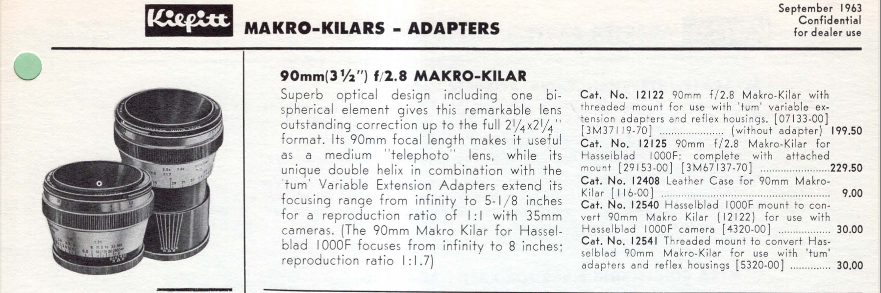

So far I have found way to mount 150 and 300mm Kilfitt's (both have M39 mount on the base of the lenses) to usual Hasselblad V mount, but for 1000F I'm lacking proper mounting bayonet. It looks like whole fun is in the journey. I also found original Kilfitt Lenses Dealer Notebook from Sep 1963 but in it there is just proper 1000F mount for 90mm macro. It's also impossible to find adapter for other way around, to mount 1000F lenses to Nikon or any other "modern" mount.

Last night I was lucky and found original Kilfitt adapter M42 to Hasselblad 1000F.
On Ebay you can find Kilfitt Munchen Kilar 90mm lens to Hasselblad WEHE Adapter.
I never had that lens in my hands and I'm not familiar about it's mount, but there is an option for V mount Hasselblads.
In Dealers brochure from time of Hasselblad 1000F Kilfit said for 90mm lens:
