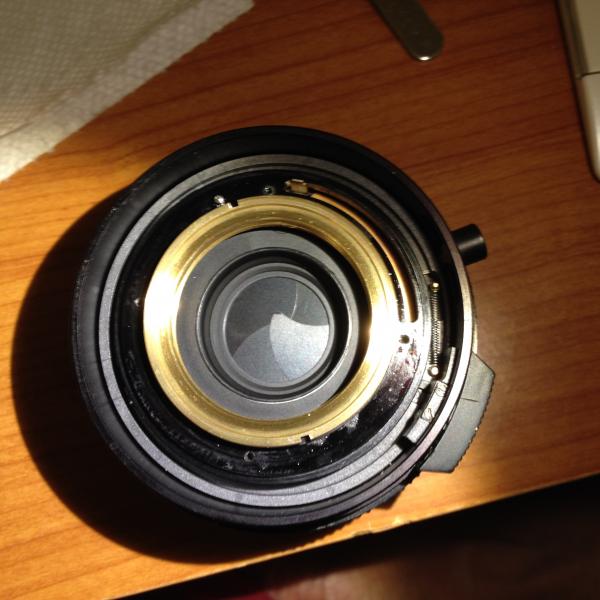

I have a Haselblad 60mm f/3.5 with a slow gear. I took it apart removing all the front elements. I cannot find the shutter mechanism. Do I access the shutter through the front of the lens? Please take a look at the picture to see what I have done. All I want to do is to clean the escarpment with lighter fluid. I had to reassemble the lens. thanks for any information.

All I know is that the Hasselblad repairman who I trust my equipment to recently told me that there is one screw in the back of Hasselblad lenses which if removed will require that the lens be completely disassembled before it lens can be put back together. Do you really want to go there?

C and CF lenses require both front and rear element removed (ie: all the glass) before you can access the shutter. To properly service the shutter, it should be removed - which means the whole lens is disassembled (except the helical sync).
F and FE lenses only need the rear elements removed.

Thanks. I appreciate the warning. I think I'll live with the slow 1/2 and 1 sec shutter and not take it apart again. It's a nice lens.
