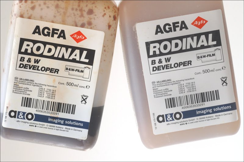

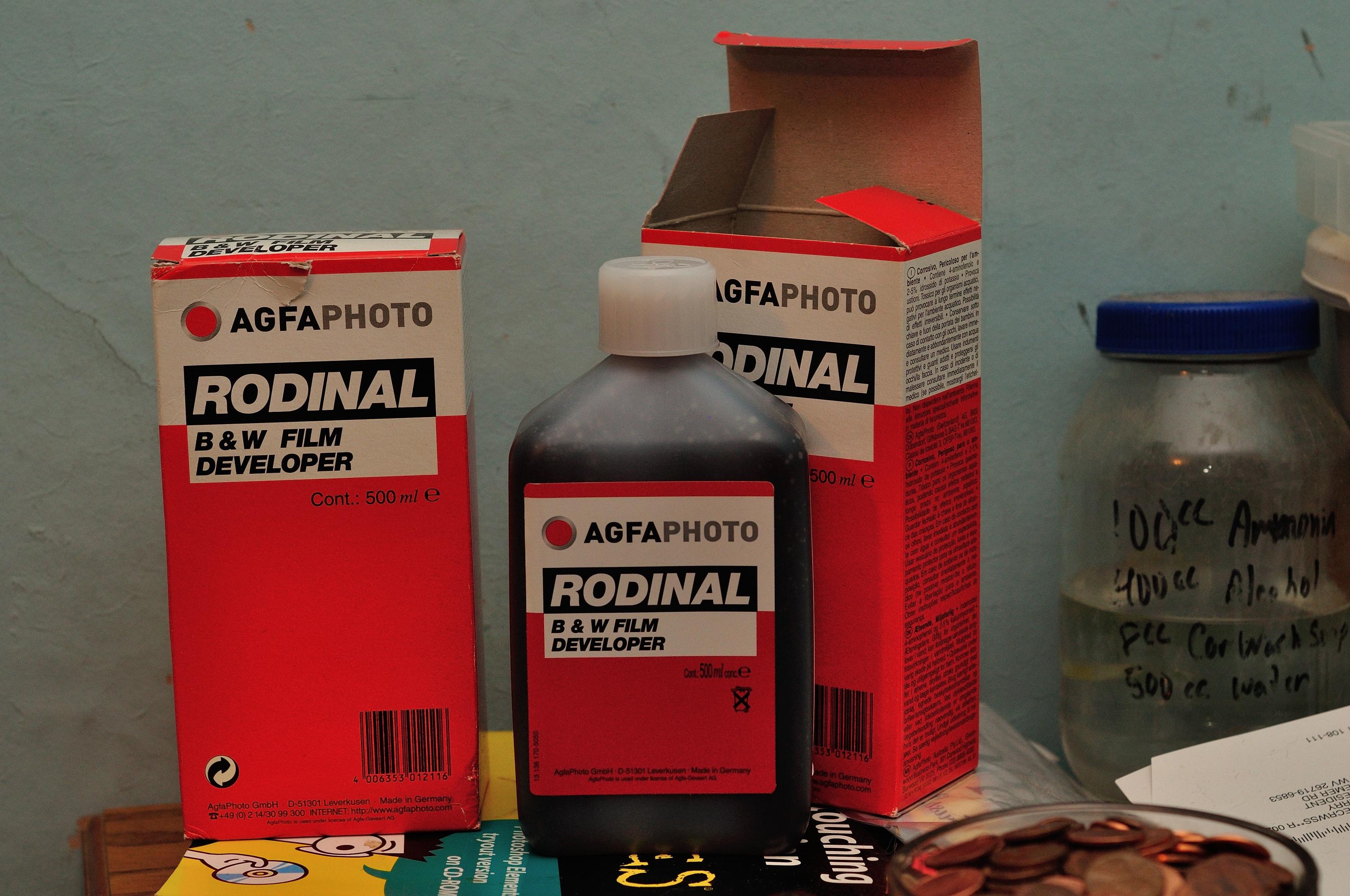

Recently bought 2 500ML NOS bottles of Agfa Rodinal. It's a dark tea color and has some precipitate crystal. Looking forward to using it for a long time. Yeah I prob'ly paid too much,oh well.
Stick some pain killer in lye the next time.
Pa- Rodinal
would you mind to share some photos of those please? :smile:
