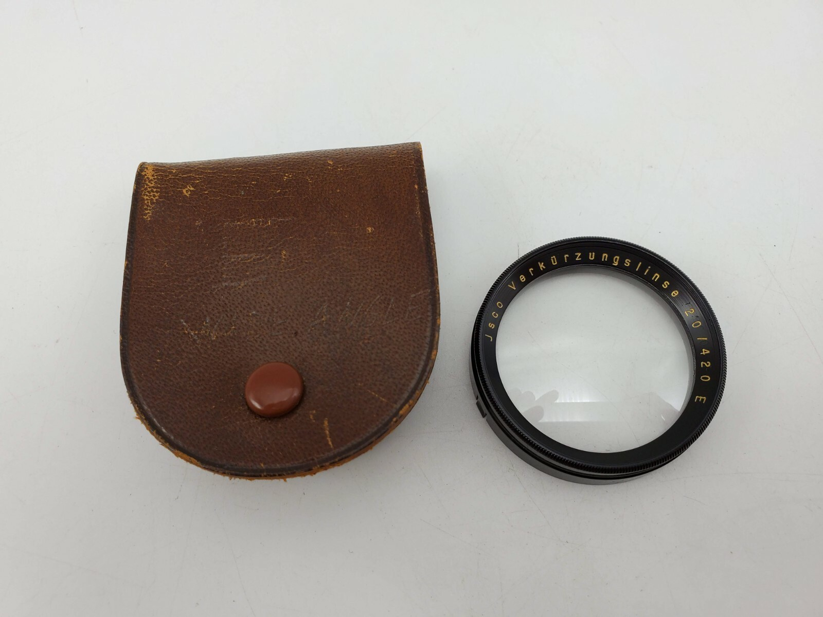

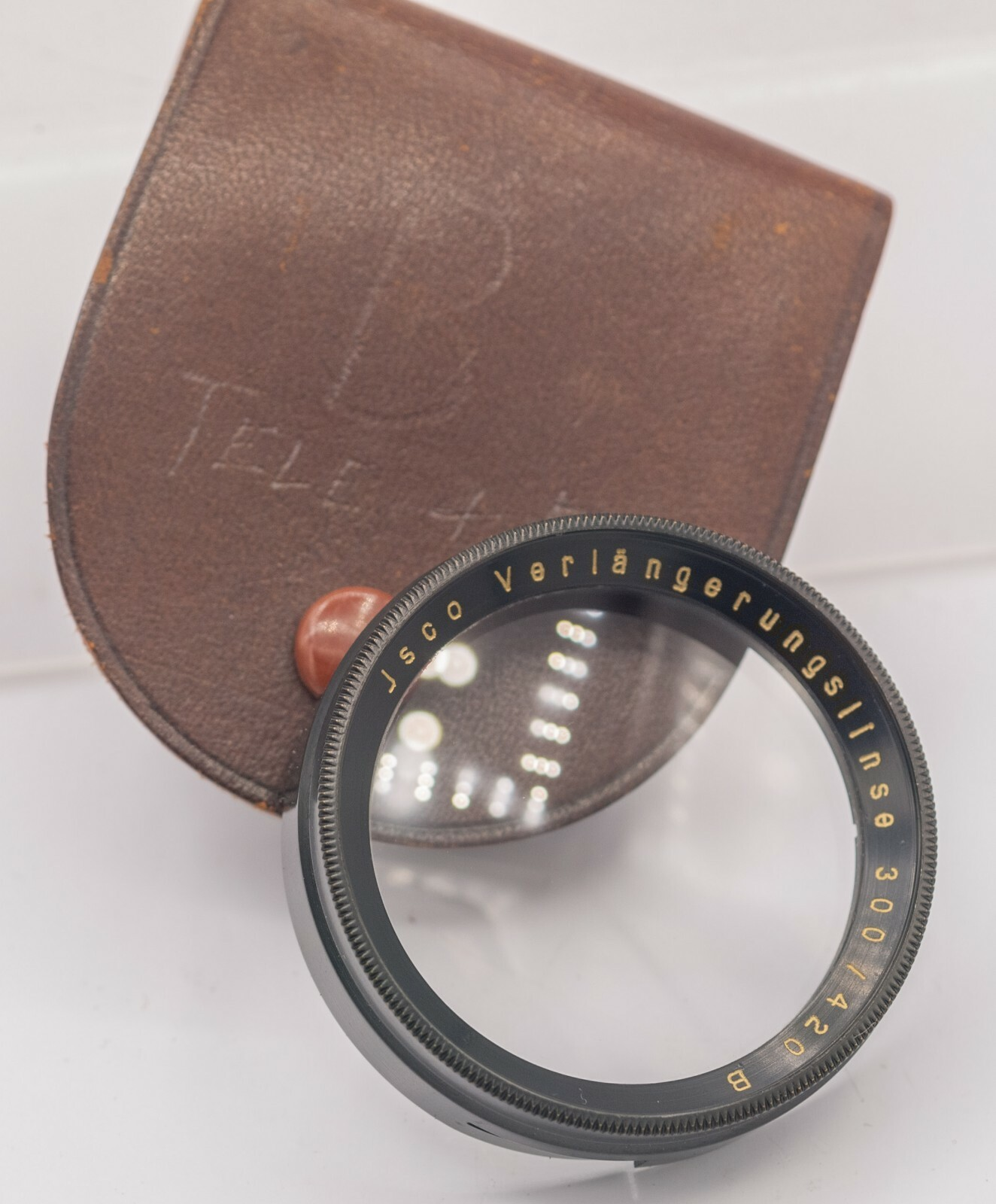

Made by JSCO, the ones I saw are 42mm push-on, which fits my 150mm Zeiss Jena Tessar f/4.5. I use this lens on 6x9.
One of them is a 1.4x teleconverter, the other is a 0.8x teleconverter, which would change the lens to 210mm and 120mm, respectively.
I'm not looking for optical perfection from these - but is the character they add to the image pleasing? For portraits or isolated central subject photography. Does it make something of a soft focus effect?
The names are
Veriangerungslinse 300/420 B
Verkurzungslinse 20/420 E
If you want to introduce more chromatic aberrations and in case of 0.8x reducer the distortion at the edges and corners, then this is the option for you.
The first one 1.4X is a negative diopter INCREASING the apparent FL, while the other 0.8X is a positive diopter SHORTENING the FL.
The first turns a 150mm lens into a 210mm lens (additional bellows needed), while the other creates a 120mm lens (less bellows needed).
That's roughly equivalent to +/- 1.5 diopters -- not very strong. Results should be fine stopped down. Wide open they would be great for portraits, softer effects.
