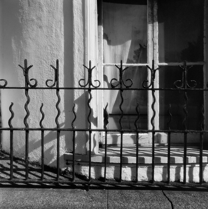

Here's a quote from the earlier thread covering speed That post has 2 pics worth looking at by Sanug He doesn't say how he established that it was box speed of 400 that was reached but you can judge for yourself if you go to the thread then post and pics by Sanug
My Foma Ortho 400-120 came out quite contrasty. The box speed was reached, no overexposure required. Fine grain, good sharpness, but no anti-halation layer. I developed in Adox XT-3, 1+3, 15 min.

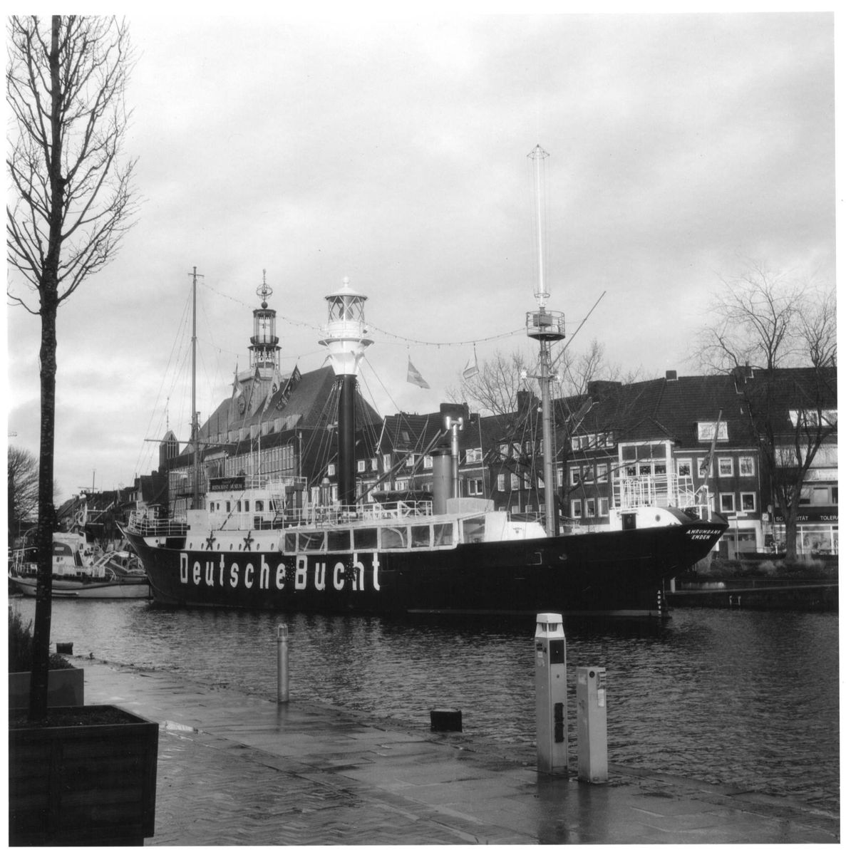

My sample on 120:
The ship's body marked "Deutsche Bucht" was red.
I did not measure the film speed scientifically, but I can say it is higher than the speed of Fomapan 400. And the Ortho 400 is much more contrasty. The given development times by Foma will lead to quite overdeveloped negatives.

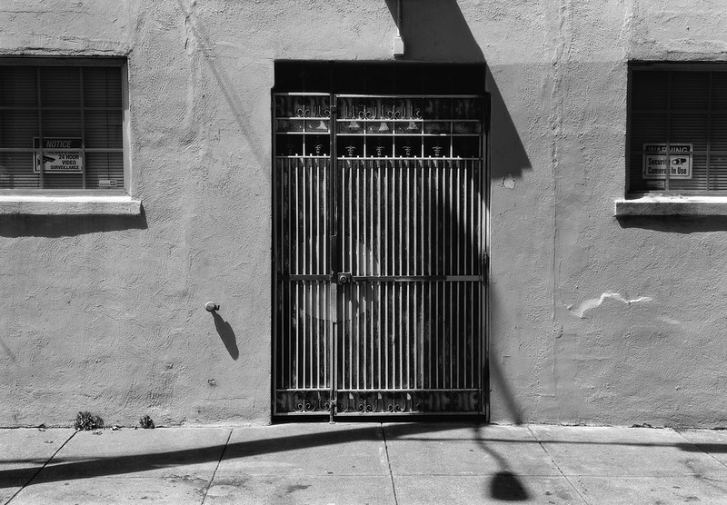

I've have a few rolls for a while, but I haven't figured out where to use them. It seems a waste to shoot scenes where anyone would be hard pressed to tell it was ortho (as opposed to panchromatic.) I'm leaving in a few weels on a motorcycle tour through Arizona and Utah. So I think I'll bring a roll or two for the Utah redrock formations (think Monument Valley, Arches, etc.) The rock is more orange (to my colorblind eyes) so I expect the ortho film won't turn them black, but definitely darken them. Has anyone tried something like that with any ortho film?
My qualitative set of the pants feeling in response to your question is more-or-less, and yes. I have shot a couple of rolls of it in ordinary midday light rated at 320 and ended up with negatives that looked reasonable, with decent shadow detail. Red objects in them were rendered more or less black. I have no sensitometry or scientific measurements to back any of this up, so I won't get into any arguments about it, but this is my feeling.
